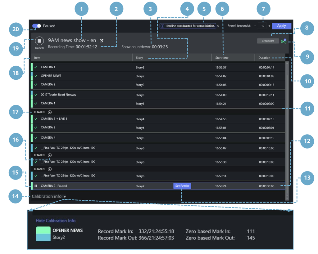

The Story Recorder Panel
The Story Recorder panel provides a real-time view of the EDL as it is being built during a recording session. It displays each story item and story as they are recorded, together with start times, durations, and recording status. The panel is primarily used with workflows that produce an EDL output (Vantage or Mosart format), where the operator can pause the timeline, select retake points, and resume recording. At the end of the show, the completed EDL can be broadcast to the Vantage transcoder for stitching into a final clip, or exported as a Mosart EDL file.
Feature
Explanation
1
Editable reference name for the show's EDL files and final clip.
2
Recording time. Total duration of recorded show, so far.
3
Show countdown timer. Remaining time of show, based on planned show duration provided from the NRCS.
4
The story slug, as provided in the NRCS. This column can be resized and re-positioned.
5
Notifications area.
6
The local (wall) time when the item was taken to PGM in format HH:MM:SS.
7
Pre-roll duration adjustment (seconds). Press Apply to set a non-default (10 seconds) value.
8
Broadcast the show EDL to subscribers. For the time being, the EDL is only saved to a configured output folder where it can be picked up by a subscribing system — for example a Vantage transcoder (.tsedl format) or a third-party application monitoring a Mosart EDL folder (JSON format).
9
Number of successful broadcasts.
10
Duration of the story item in format HH:MM:SS:FF (frame count is only shown after the item is paused/ recorded).
11
Story separator.
12
Grey coloring: The selected item row.
13
Selection of the Retake point.
14
Toggle switch for the appearance of calibration details which can help with the initial calibration setup of Story Recorder.
  • Record Mark In: In-point, displayed as clock (wall) time. Format nnn/hh:mm:ss:ff, where nnn is the absolute frame number.
  • Record Mark Out: Out-point, displayed as clock (wall) time. Format nnn/hh:mm:ss:ff, where nnn is the absolute frame number.
  • Zero based Mark In: In-point, displayed as zero-based time.
  • Zero based Mark Out: Out-point, displayed as zero-based time.
15
Blue border: The first item that will be retaken (the Retake point).
16
Play a 10 second snippet to review the cut point.
17
Separator, indicating a cut (a retake) and marker for a retake point.
18
Name of the story item that is identified by a primary Viz Mosart template and template variant.
This column can be resized and repositioned.
19
Record | Pause button and status indicator.
20
Story Recorder On | Off switch.

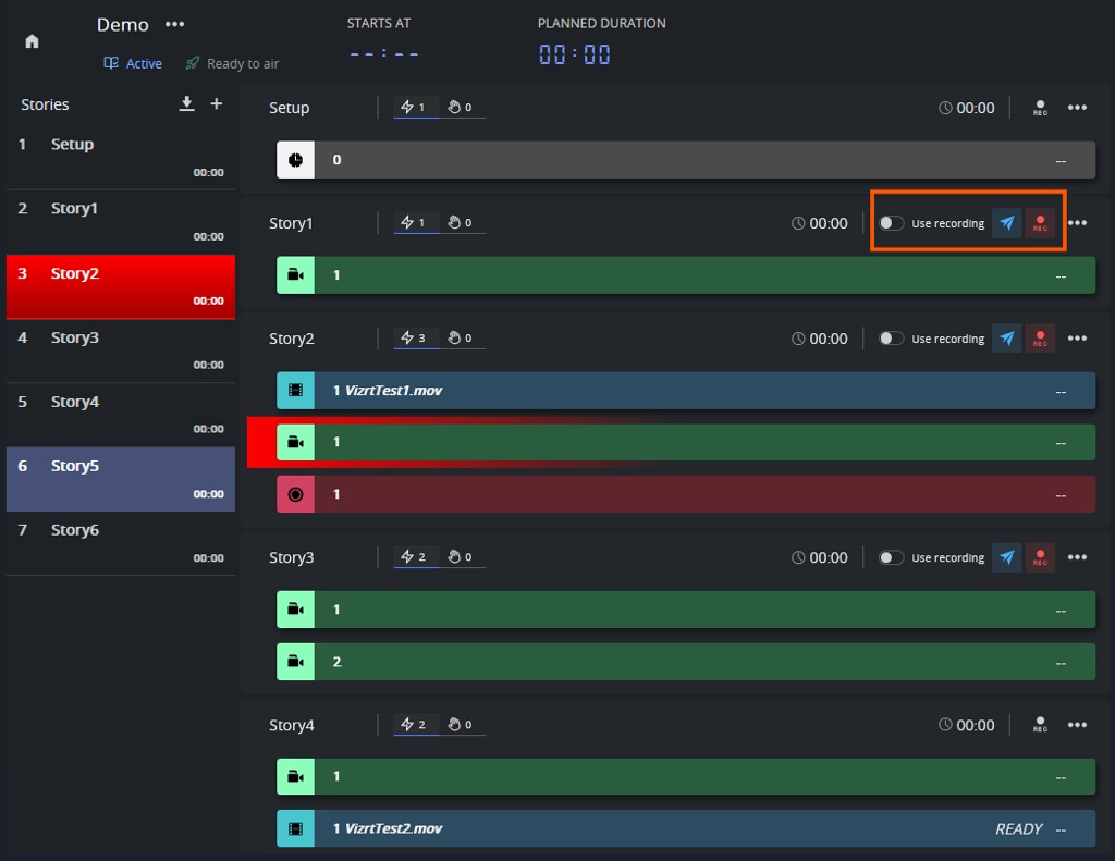

Stories Marked for Recording in the Mosart UI
When using the story clip production and publishing workflow, stories can already be tagged for recording in the NRCS (for example Vizrt’s Showmaker, or Saga). When a rundown that contains tagged stories is loaded in Viz Mosart, these stories display with a REC indicator in the main timeline view.

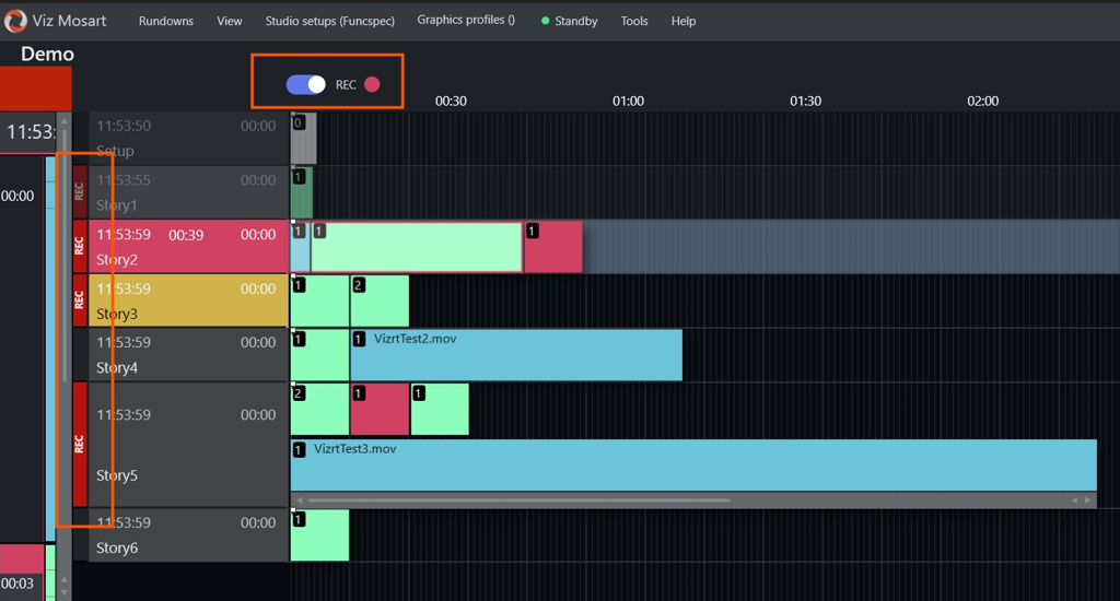

A Story Recorder Mode toggle at the top of the Viz Mosart timeline also indicates whether the rundown includes stories to be recorded.

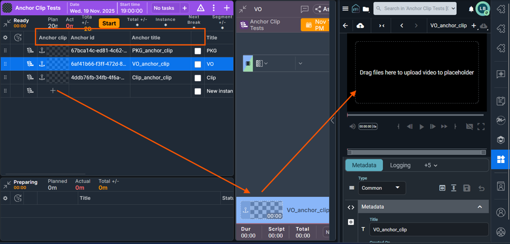

A story in Saga with Anchor clip placeholders (left), each linked to a Mimir clip placeholder (right),
ready to receive recorded clips from Story Recorder:
REC indicators and Story Recorder mode toggle in the Viz Mosart UI:
