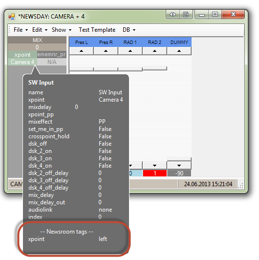

To Add a Newsroom tag

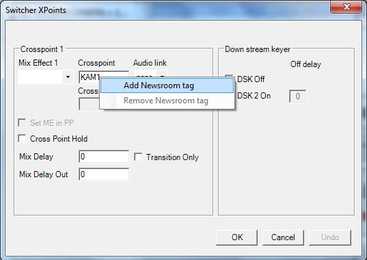

  1. Refer to section Template Device Functions, which lists the properties of the device where you want to add the newsroom tag.
  2. Right-click the field. In the example below, in a Crosspoint. A pop-up menu appears:
Note: If the field already has a newsroom tag, there will instead be a menu option Change Newsroom tag, and the Remove option will be enabled.
Not all template fields support newsroom tags. When right-clicking an unsupported field, a pop-up menu may or may not appear. If it does, it will not contain an Add Newsroom tag option.

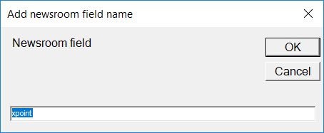

  1. Select Add Newsroom tag.
    A dialog menu appears:
A default name may be given.
  1. Enter or change the newsroom tag name, and click OK.
Note: When naming a newsroom tag, avoid using any special characters.

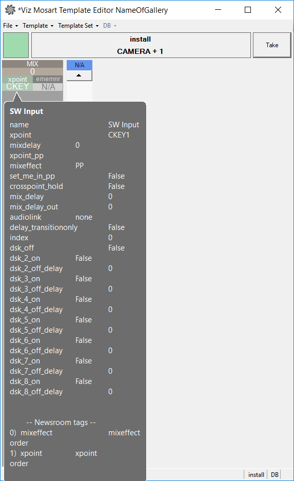

  1. Close the Device Properties menu (in the example above, Switcher XPoints).
  2. To verify, mouse-over the device details. The Newsroom tag(s) are presented at the bottom of the panel.

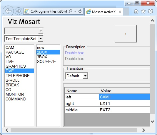

If a template has more than one newsroom tag, the order in which the tags are shown in Viz Mosart’s ActiveX, may be changed in the Template Editor.
To set newsroom tag order
  1. In the Template Editor, open the target template.
  2. Open Template properties and select the Newsroom tags order tab.
  3. Order the newsroom tags if there are several by selecting a tag and clicking Up or Down.
  4. To verify, open the Activex in the NRCS, and observe that the tag order is as set in the previous step:

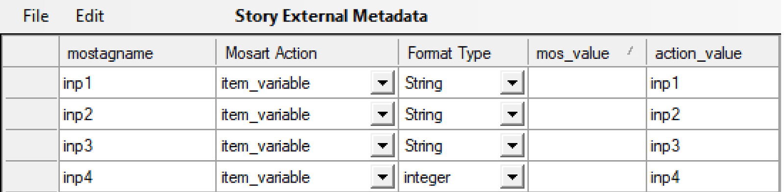

  2. Add the column as a story variable in Viz Mosart config:
  3. In Viz Mosart Story External Metadata
    1. Add the new ENPS field as, for example, an item_variable.
    2. There is also a story_valuable available, but using this action value affects all items in the story (the newsroom tag binds to all primaries in that story).
    3. The target here should be the first primary item in a story.
  4. Restart all Viz Mosart server applications to apply settings.

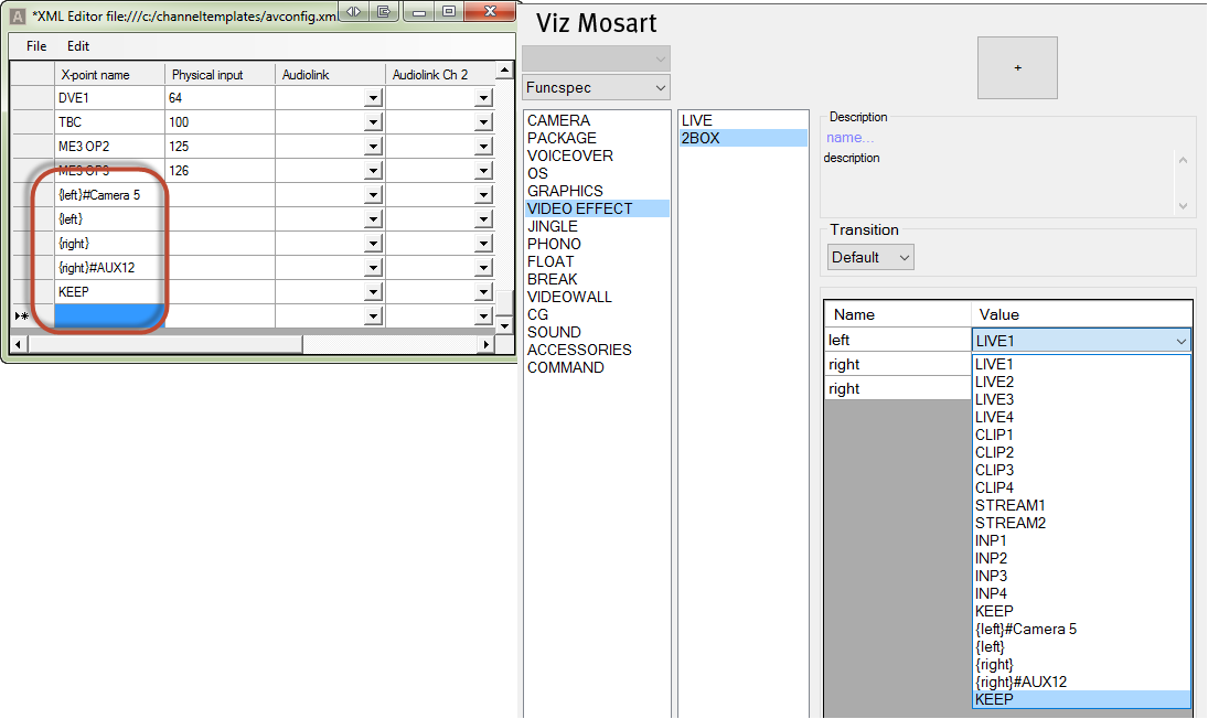

Adding inheriting values to the lists defined in AV Automation's A/V Setup
A newsroom tag can be listed among the definitions in AV Automation's A/V Setup menu.
You can add the special value KEEP, {name}, and {name}#default to these lists, making them available for selection both in Template Editor and in the ActiveX.
In the example below, five of these values have been added to the video configuration list. To the right, how these values appear in the ActiveX:
Explanation:
  • {left}#Camera 5: Use the value of the last Newsroom tag {left} or Camera 5 if no such newsroom tag exists.
  • {left}: Use the value of the last Newsroom tag {left}. Nothing happens if no such Newsroom tag exists
  • KEEP: Special configurable word that implies retaining the existing value of the corresponding newsroom tag. (In the ActiveX example, left)

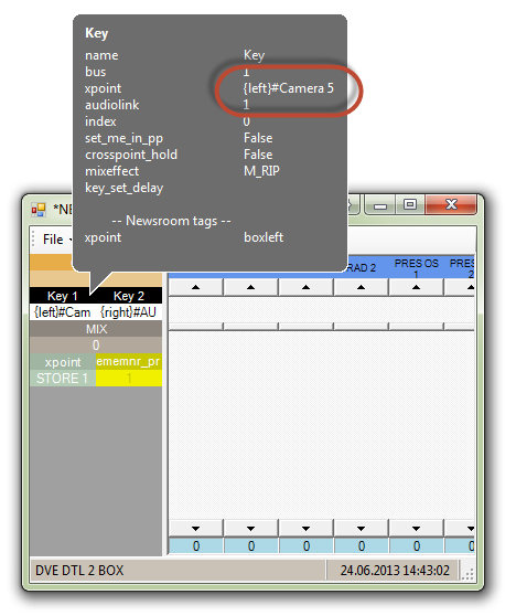

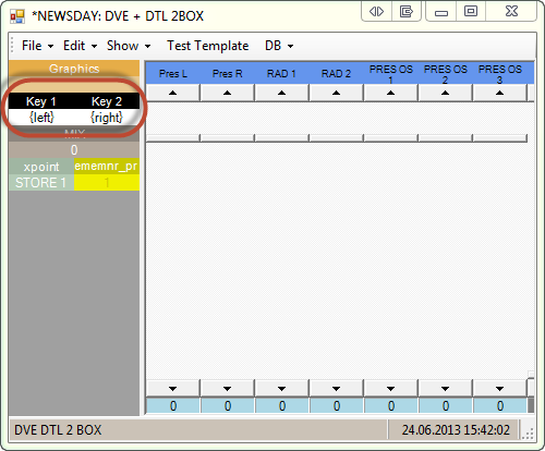

DVE Template with inheritance
A DVE 2BOX template where the left and right input may be inherited from sources within the same story.
In this template the values for Key 1 and Key 2 are:
Key 1 = {left}#Camera 5
Key 2 = {right}#AUX 12
Key 1 will then be either the current value of a newsroom tag named left in the same story, or Camera 5 if no such newsroom tag exists.

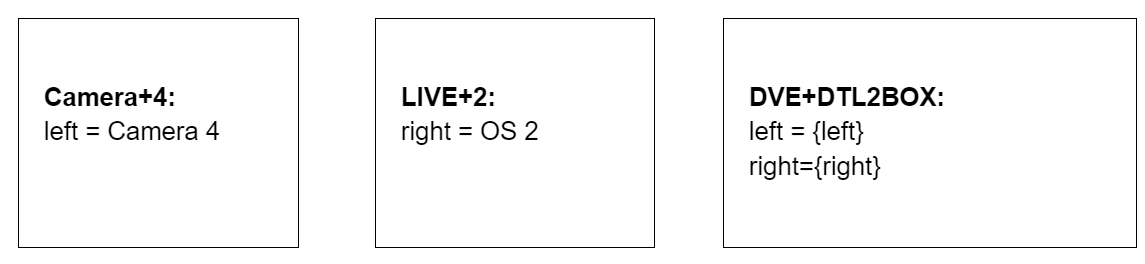

Timeline Example
In the figure above, three templates are placed in a timeline:
  1. Camera+4: Where xpoint is set to Camera 4 with Newsroom tag = left.

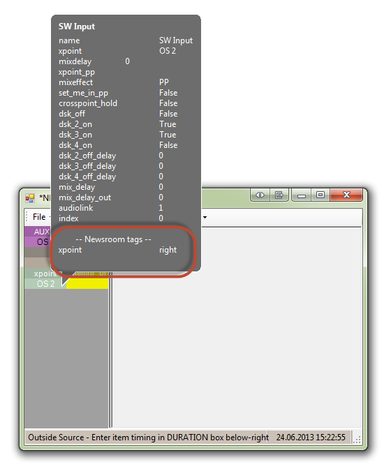

  2. Live+2: Where xpoint is assigned to OS 2 with Newsroom tag = right.
Note: The newsroom tag is entered here to allow later templates in the story to inherit the value. Adding a newsroom tag here also exposes this value to the ActiveX.
  1. DVE+DTL2BOX where left and right inputs are set to inherit newsroom tag {left} and {right} respectively.
    In this example, the left and right inputs are inherited from previous templates in the same story, exposing newsroom tags with the same names.
Note: Here, no default values are given. No action is taken if no values are assigned to the left and right newsroom tags.
