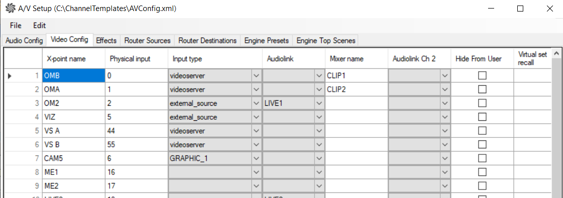

Video Configurations
To work with video crosspoint configurations
  1. From AV Automation, select Devices > A/V Setup > Video Config tab.
  2. As a minimum, you should enter the crosspoint details: X-point name, Physical input and Input type (where applicable).
Settings
  • X-point name: Name to use for the video crosspoint in the Viz Mosart system. This name will be displayed in the Crosspoints drop-down menu in all Templates, in the GUI drop down menus (newsroomtags, etc.) and in the NRCS Plugin.
    Notes:
    • Must be configured in A/V Setup
      Any crosspoint name used in a template must exist in A/V Setup.
      Example: If you reference “CAM1” in a template, ensure that “CAM1” is configured as an X‐point name in A/V Setup. Otherwise, the command will silently fail and not switch the source.
    • Spaces are stripped
      Mosart removes all spaces from crosspoint names internally.
      Example: If you configure an X‐point name “CAM 1,” Mosart treats it as “CAM1” internally. Referencing “CAM 1” in a template will still match, because spaces are ignored at lookup time.
      Recommendation: For clarity, avoid using spaces in crosspoint names (e.g., use “ME1” instead of “ME 1”).
    • Case Insensitivity
      Mosart also ignores case when matching crosspoint names.
      Example: “cam1,” “CAM 1,” and “CAM1” all resolve to the same crosspoint in Mosart.
  • Physical input: Input on the video switcher. These are the physical inputs of the video switcher.
  • Audiolink: Audio fader to link to the video source when the video source is changed in the Newsroom Control System or Viz Mosart GUI, enabling the audio faders to follow the video crosspoints.
    The drop-down menu presents Audiolink-values corresponding to the audio sources that may be selected for a fader, alongside the selected input source, for example a camera.
  • Audiolink Ch 2: Second audio fader link for the video source. The fader name that will be used when enabling video server Ch2 in the Template Editor. When the video source is changed in the Newsroom Control System or Viz Mosart GUI, the audio faders will follow video crosspoints.
    Should be used for audio mixers with mono-faders which cannot be coupled in the mixer.
  • Mixer name: The name of the crosspoint as it is known on the switcher itself, for cases where that differs from the X-point name used inside Viz Mosart. Leave empty when the switcher recognizes the X-point name directly.
    Originally introduced for the legacy Viz Opus, this setting is also used by current drivers:
    • Viz Vectar Plus / TriCaster (NDI router): Required. Must hold the hardcoded switcher-side name (typically INPUTn, DDRn, BFRn, MIX n). See Template Device Functions.
    • Panasonic Kairos: Required. Used as the source name in all background bus, AUX and key-fill commands.
    • Viz Engine as a Switcher: Used when the X-point name is a Viz Mosart user-friendly name rather than the engine's source ID. See Viz Engine as a Switcher.
    Note: Behavior when Mixer name is empty depends on the driver. Viz Engine falls back to the X-point name; TriCaster/Vectar falls back to the Physical input number; Panasonic Kairos has no fallback, so the value must be set.
  • Input type:
    • camera: Select to assign this crosspoint as a camera type. This is used by the Audio Panel application.
    • external_source: Select to assign this crosspoint as an external source. This is used by the Audio Panel application.
    • videoserver: Select to assign this crosspoint as a server channel.
    • GRAPHIC_1-5: Select to assign this crosspoint as a graphics engine.
    • ROUTER_RIPPLE_A: Select to use as router source A.
    • ROUTER_RIPPLE_B: Select to use as router source B.
  • Hide from user: Do not show crosspoint to user. This prevents the crosspoint from displaying in the Viz Mosart GUI drop-down menus (Newsroom tags etc.) and in the NRCS Plugin. Default: Unchecked.
  • Virtual set recall: Value of a video cross point that when called, will also recall a virtual set, effectively binding a cross-point to a virtual studio setting.
Info: A virtual set recall can also be performed from a template.
  • Comments: Only for useful setup notes, in this menu. Not visible or used anywhere else in the application.

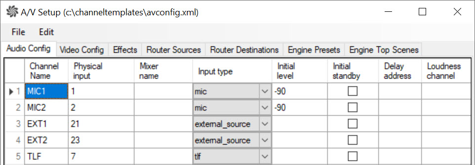

Audio Configurations
To work with audio mixer configurations
  1. From AV Automation, select Devices > A/V Setup > Audio Config tab.
  2. As a minimum, you should enter Channel Name and Physical input.
Settings
  • Channel Name: Name to use for the audio fader in the Viz Mosart system (for referencing the audio channel in Viz Mosart templates).
  • Physical input: For audio mixers that use fader numbers or MIDI assigned faders, this number must correspond with the fader number on the audio desk. Fill it in with a number that is unique within the column even when your desk is addressed by name — several drivers use it as Viz Mosart's internal key for the channel, and a channel whose Physical input is empty or non-numeric is skipped at start-up, after which level, mute and PFL have no effect on it.
    Two exceptions, where filling it in is harmless but not required: The Studer Vista driver silently replaces a blank or duplicate number with one of its own, and drivers that learn the fader assignment from the desk (Stagetec Diamond RAS) ignore the value entirely.
  • Mixer name: A unique fader identifier, for audio desks that use fader names instead of numbers.
Info: For LAWO EMBER+, these types of faders are controllable and may be configured:
  • Auxes, groups, inputs, sums, vcas.
  • Use the value of the startup label, found in the Ember+ tree/viewer, located under mixers/primary/channels for the respective fader types.
    (vcas are instead found under mixers/global/vcas).
  • For a stereo fader, use the left. Do not configure the right.
Info: For STAGETEC EMBER+, the controllable channels are the ones under the CXP / channel node in the Ember+ tree. Use the fader Identifier (for example c#1).
Info: For TASCAM SONICVIEW 16 EMBER+, the controllable channels are the ones under the sonicview/channels node in the Ember+ tree. Use the fader Identifier (for example channel_1).
Info: For LAWO PowerCore, the controllable channels are the ones under the PowerCore/Sources and PowerCore/Sums nodes in the Ember+ tree. (If the Identifier of the first level node is different from ‘PowerCore', set that Identifier in the FirstLevel config property in AudioMixerEmberPlus.xml.) Use the node Identifier (for example MPX01).
  • Input type: For the internal Viz Mosart audio logic, the input type of the fader must be set. This can also be done in the Template Editor.
  • Initial level: Desired level for the audio fader to obtain after a reload of the Viz Mosart rundown.
  • Initial standby: Selects the faders that should not be reset at the start-up of the AV Automation application. Default: Unchecked.
  • Delay address: (Lawo non-Ember+ audio mixer boards only) Gives the signal address for the delay function.
  • Loudness channel: Defines the channel number for loudness level control.

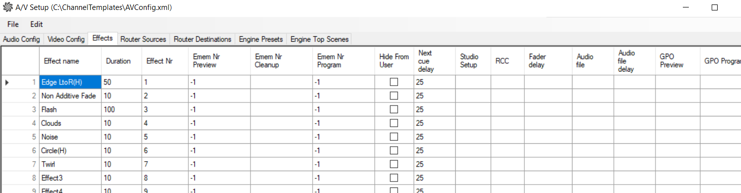

Template-driven Effects
You can define effects in Viz Mosart that can then be recalled by a template. This avoids having to recreate the effect in each template that refers to it.
Use the Effects table, which is then referenced during the execution of a template that has specified an Effect name or Effect Nr.
To manage vision mixer effects configurations
  1. From AV Automation, select Devices > A/V Setup > Effects tab.
  2. An effect may perform various actions on the vision mixer, the RCC, the Audio player, the GPO, and possibly other devices.
Note: When using an entry in the predefined Viz Mosart Effect table, the EMEM must include the transition between bus A and B, since transition is not performed by Viz Mosart.
Settings
  • Effect name: Name or description of the effect. Mandatory.
  • Effect Nr: Value of the effect assigned from the newsroom system. Used in conjunction with Studio Setup to uniquely identify effects. Mandatory.
  • EMEM Nr Preview: Video switcher preset to recall when the template is taken in the preview. Mandatory.
  • EMEM Nr Program: Video mixer preset to recall when the template is taken on the program. Mandatory.
  • Hide From User: There are cases where you have an effect that should only be run under specific circumstances (for example, on an ME row), this effect being recalled from specific templates. If such an effect is unintentionally selected from the Viz Mosart GUI (or NRCS plugin) this could have unintended on-air consequences.
    To prevent this, Hide From User can prevent the effect displaying in the Viz Mosart GUI Transition panel and in the NRCS Plugin. (requires Mosart web apps version 2.5) Default: Unchecked.
  • EMEM Nr Cleanup: This register will be recalled when cueing the next template. Use only if the register used for the effect demands another "cleanup" register recall to prepare the mixer for the next events.
  • Duration: Duration of the effect in frames. Will hold the triggering of the template following the effect, for this amount of time.
  • RCC: Recall a Robotic Camera Control shot.
  • Next cue delay: Used to hold the cueing in the preview of the second template/element after the effect. The number of frames entered will be in addition to what is already set as Min. cue delay in the Video Switcher setup.
Info: Next cue delay is ignored if EMEM Nr Program has a negative value!
  • Fader delay: Delay opening the audio effect fader (the Audio Player fader). Value is given in frames. Ignored if this value is greater than Next cue delay.
  • Audio file: Viz Mosart can play an audio file on Audio Player synchronous with the mixer effect. Specify the filename for the audio file here.
  • GPO Preview: Send GPO # when entering Preview mode.
  • GPO Program: Send GPO # when entering Program mode.
  • Macro Preview: Refer to the Text field in Recall preview in the Template Device Functions - Macro Recall section.
  • Directtake: Number of Direct Take template triggered when performing an effect transition. Often used to allow control of additional devices.
    For example, this could be a direct take triggering a named overlay graphic or a direct take with additional commands required by the vision mixer for this effect.
  • Studio Setup: Specifies a specific studio setup for which the effect will be run. This attribute is optional and is used in conjunction with Effect Nr to uniquely identify effects.
    See Effect number and Studio Setup below.
  • Macro Preview Action: Refer to the Drop-down description in Recall preview in the Template Device Functions - Macro Recall section.
  • Macro Program Action: Refer to the Drop-down description in Recall program in the Template Device Functions - Macro Recall section.
Note: Macro Preview Action, Macro Program Action
Load Project could affect the performance of the switcher and should thus be used with caution during a running show.

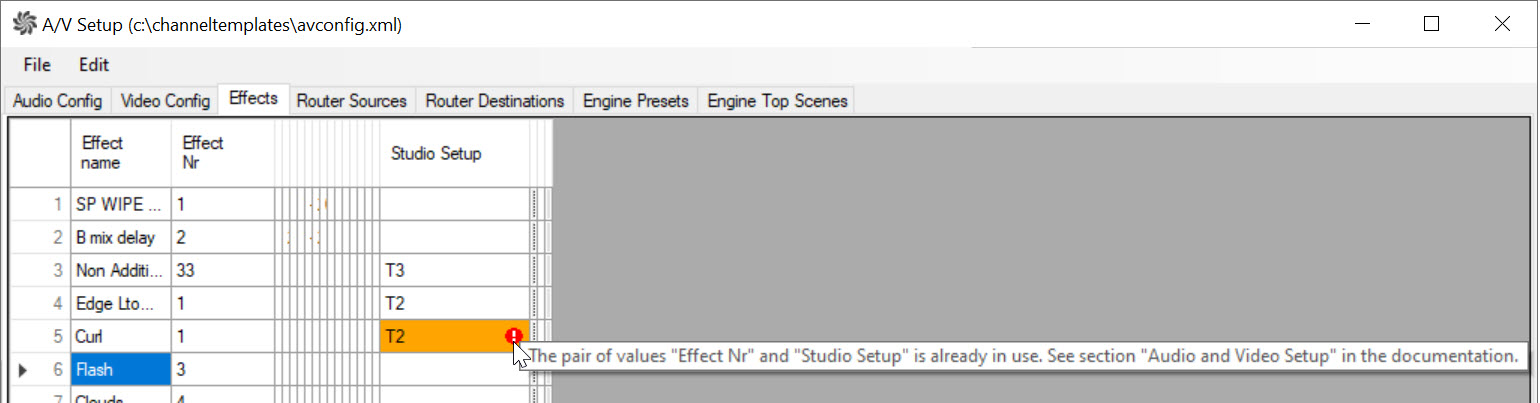

Effect Number and Studio Setup
Normally the effects are shared between all the studios/control rooms. But in some cases, a given effect is required to function differently in one studio setup than another. This is achieved by adding an extra entry for that effect, but with the Studio Setup that this effect is reserved for. The rules for how this works are as follows:
  • The combination of Effect Nr and Studio Setup must be unique within the Effects table.
    Multiple effects can have the same Effect Nr, but these must have different values in Studio Setup.
  • An effect which has Studio Setup specified will only be executed for the corresponding studio setup.
  • An effect without Studio Setup specified will be executed for all studio setups that do not have any dedicated effect specified.
Viz Mosart processes an effect in the following order:
  • Search for an effect with given Effect Nr and with Studio Setup that matches the active Studio Setup.
  • If no match is found, search for an effect with given Effect Nr and empty Studio Setup.
If there are duplicate values of Effect Nr and Studio Setup the cell will be highlighted and an error message will indicate the reason for the warning.

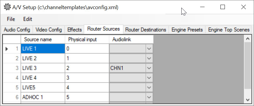

Router Source Configurations
Router source crosspoints can act as an emergency switcher if the vision mixer fails to switch. Alternatively, a router switch can change a background wall source in the studio, or anything in your production that requires switching.
To manage router source configurations
  1. From AV Automation, select Devices > A/V Setup > Router sources tab.
  2. Router switches are predefined as part of a Viz Mosart template. Keyboard shortcuts can also be programmed for a router switch to take place.
Settings
  • Source name: Name to use for the router source in the Viz Mosart system.
  • Physical input: Physical or virtual input to the router.

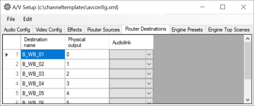

Router Destination Configurations
Router destination crosspoints can act as an emergency studio output if the vision mixer fails to switch. Alternatively, a router destination could be a monitor in the studio, a transmission output, or anything that needs switching as part of your production.
To manage router destination configurations
  • From AV Automation, select Devices > A/V Setup > Router destinations tab.
Settings
  • Destination name: Name to use for the router destination in the Viz Mosart system. This name will be displayed in the router crosspoints drop-down menu in all templates and in the ActiveX application.
  • Physical output: Physical or virtual output on the router.
  • Audiolink: Linked device.
