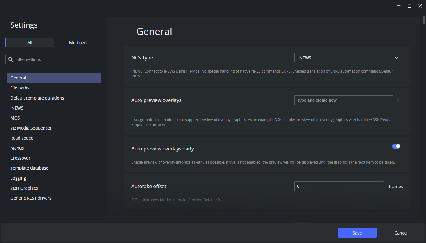

To simplify setting up the connection to iNEWS, the Manus Admin console includes a Settings utility.

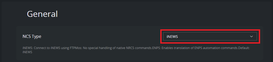

  1. Open the Settings utility by typing settings followed by ENTER.
  2. From the General settings section, under NCS Type, select iNEWS.

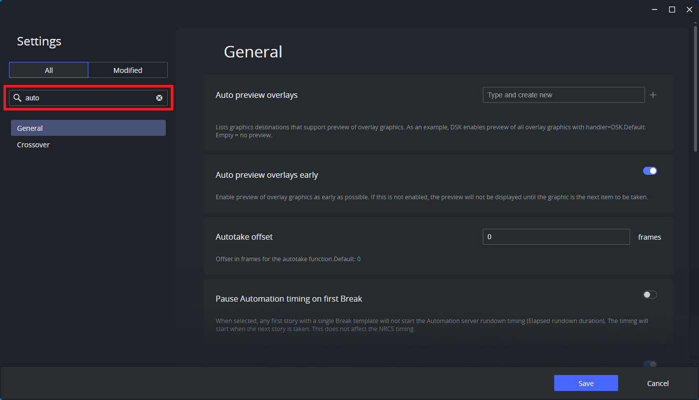

Tip: You can search for a specific value from the Search box.
The editor comprises several sections, each dedicated to a collection of settings:
General
  • NCS Type: Selecting iNEWS presents the configurable values listed here.

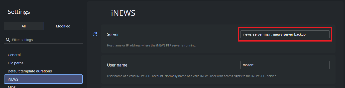

iNEWS
  • Server: Hostname or IP address where the iNews FTP server is running. A backup iNews server can be configured by adding the hostname or the IP address separated by comma:
  • User name: Username of a valid iNews FTP account. Normally the name of a valid iNews user with access rights to the iNews FTP server.
  • Password: Password of a valid iNews FTP account. Normally password to a valid iNews user with access rights to the iNews FTP server.
  • FTP Port: iNews FTP port.

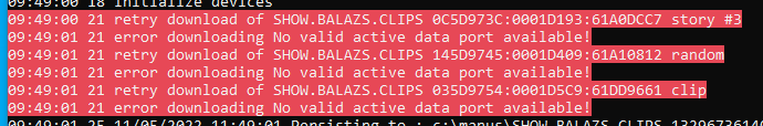

  • FTP active port range: Ports used for Active mode. The format is '<low_port>..<high_port>', random ports are used when left empty or the format is wrong. Useful when the current machine has certain ports that are blocked or used for other purposes.
Info: Only used when active mode is selected. Similar to the iNEWS environment variable RXDATAPORTRANGE. Because a new connection is opened for each data transfer (listing directories, downloading stories) the port range must be sufficiently wide (~100 wide range works in most cases).
  • When the port range is left empty or the format is invalid, random ports are used.
  • When the port range is not wide enough, the rundown won't fully load.
  • These situations are indicated in the Manus Admin console and in the logs. For example:
