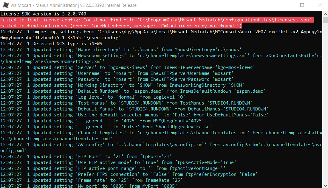

Manus Administrator is the intelligent element of Viz Mosart, monitoring the rundown in the connected NRCS, parsing the content into Viz Mosart functionality that is presented in the Viz Mosart GUI.
Manus Administrator is a console application and must be kept running at all times on your Mosart server.

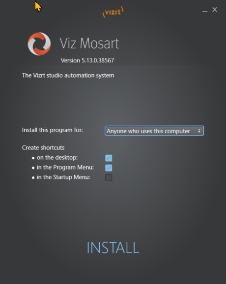

Installation
To install Manus Administrator
Manus Administrator forms part of the standard Viz Mosart (server) installer.
See the section Viz Mosart Installer Files for details of a standard installation, that includes Manus Administrator
Tip: Type help in the Manus Administrator console window to see which commands you can use. See Manus Admin Commands.

From the Manus Administrator console you can open a configuration editor in a new menu:
Type
settingsin the Manus Administrator console, then ENTER.
