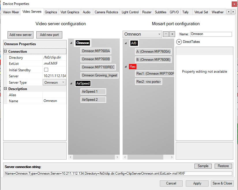

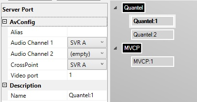

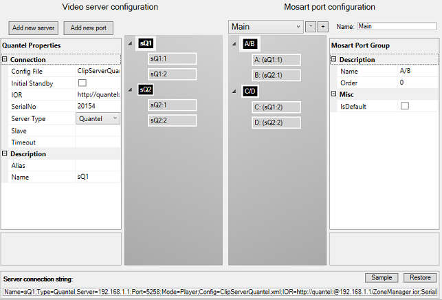

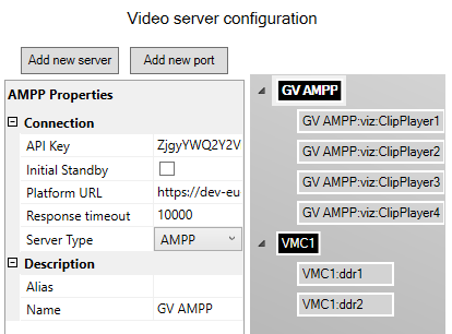

AVAutomation > Devices > Properties> Video Servers tab.
The left side (Video server configuration) presents details of the physical video servers and their ports.
The example above presents a Quantel server (as selected from the Server Type drop-down menu), sQ1, and one other server (sQ2), which could also be a Quantel server.
Server sQ1 has 2 ports defined, sQ1:1 + sQ1:2.
Server sQ2 has 2 ports defined, sQ2:1 + sQ2:2.
This is described in Working with Video Server Configurations and Working with Servers and Ports.

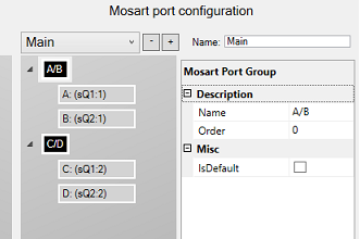

The right side (Mosart port configuration) presents details of the virtual connection within Viz Mosart, with salvos, virtual ports, virtual port groups and assignments of physical server ports (as defined on the left side) to virtual ports. These concepts are presented below.
This is described in Working with Mosart Port Configuration.

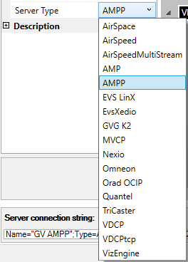

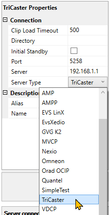

You can add or remove video servers to your Viz Mosart system, and modify the configuration of existing hardware.
Viz Mosart supports a wide range of video servers. These appear in the Server Type drop-down menu.

Server Type: Name of supported video server. For example, AirSpace, AirSpeed, EVS LinX, Orad OCIP.

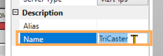

Alias: Defines the name of the server to display in the Viz Mosart GUI and Timing Display.
Name: Internal name of the server, displayed in AV Automation
The above settings are typical for
AirSpace, AirSpeed, EVS LinX, EVS Xedio, OradOcip video servers.

Grass Valley AMPP
Please refer to Common Settings above. In addition, there is
Platform URL: The AMPP Platform URL. This URL should look like https://<region>.cloud.grassvalley.com
API Key: An API key allowing you to connect to the AMPP Platform for sending/receiving AMPP Control messages
Response timeout: Timeout in milliseconds to wait for the responses from the server. Default 1000

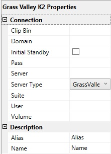

Grass Valley K2
Connection to K2 is initialized with a ping (ICMP) from Mosart to the server to confirm the connection. Then it uses port 3811 to communicate with the K2 server. Both must be open for Mosart to be able to connect.
Media Administrator uses a separate port when it connects: 49171 (a range is OK. Use 49168-49172)
Note: In some situations, cueing of a clip may fail due to an internal timeout in Viz Mosart. This can typically occur when trying to cue a clip that is currently transfering to the video server. See EventReceiverTimeout below.
Clip Bin: Defines the Bin in a default server location for clips to be played. This default location is used only when the location is not provided by other means.
Notably, it is not used when the setting IgnoreBin (in Media Administrator) is true for this server.
The value of Clip Bin must designate a bin in the volume designated by the value of Volume (see below).Domain: The domain as part of the user credentials.
EventReceiverTimeout: See below.
Pass: The password as part of the user credentials.
Suite: Arbitrary value. However, follow these guidelines:
For each K2 server, two or even three unique Suite values must be used:
First, the values for Media Administrator and AV Automation must be different.
Second, in a redundancy setup with Main and Backup Mosart server, the two values for Media Administrator must be different.
Note: In this constellation, both Main and Backup AV Automation should use the same value, yet different from the two Media Administrator values.
User: The username as part of the user credentials.
Volume: This value, together with that of Clip Bin (see above) defines the default server volume location for clips that will be played. This default is only employed when a location has not been provided by other means. Notably, it is not used when the Media Administrator setting, IgnoreBin is true for this server.
Server: Defines the hostname or IP address of the video server.

Omneon
Directory: Defines the directory where the clips are stored.
ExtList: The list of valid file extensions used when listing and querying files on the server. The list is period separated and case sensitive.

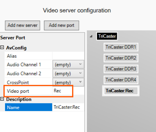

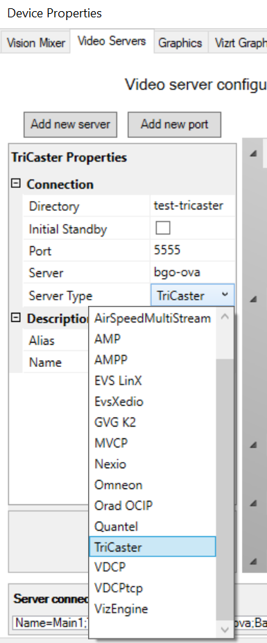

TriCaster
The Vizrt TriCaster uses the TriCaster protocol (previously named vizrt-ips protocol).
Clip Load Timeout: Timeout in milliseconds to wait for a clip from a media server to be available. Default: 500 mSec.
Directory: The TriCaster directory used for clips path.
Initial Standby: If selected, the server is forced to start in Standby mode.
Port: TCP/IP communication port to the TriCaster (Default: 5951).
Server: Defines the hostname or IP address of the TriCaster.
Server Type: TriCaster.

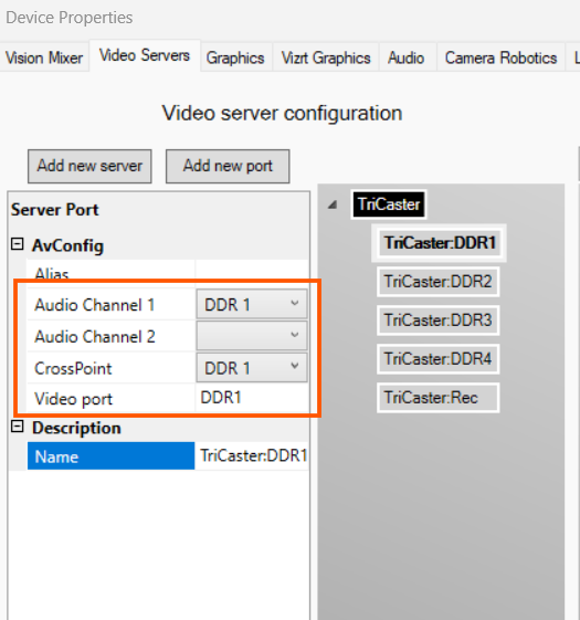

Video Server Port Properties
Audio Channel 1: The audio channel 1 for the selected video port.
Audio Channel 2: The audio channel 2 for the selected video port.
CrossPoint: The video crosspoint for the selected video port.
Video port: The actual port name/number on the video server. Please refer to the documentation of your video server for information on how to find these.
Info: For the Server Type TriCaster, any recording port must have a 'Video port' of the form recN, where N is a number.

To Add a Server
Click the Add new server button
In the Properties pane on the left, select from Server Type and add additional information such as Port and Server host.
To Remove a Server
In the Video Server Configuration tree, right-click a server node and select Remove.
To Add a Port
In the Video Server Configuration tree, select a server node
Click the Add new port button, or right-click the server node and select Add new port
In the property editor on the left, enter the port information.
To Remove a Port
In the Video Server Configuration tree, right-click a port node and select Remove.

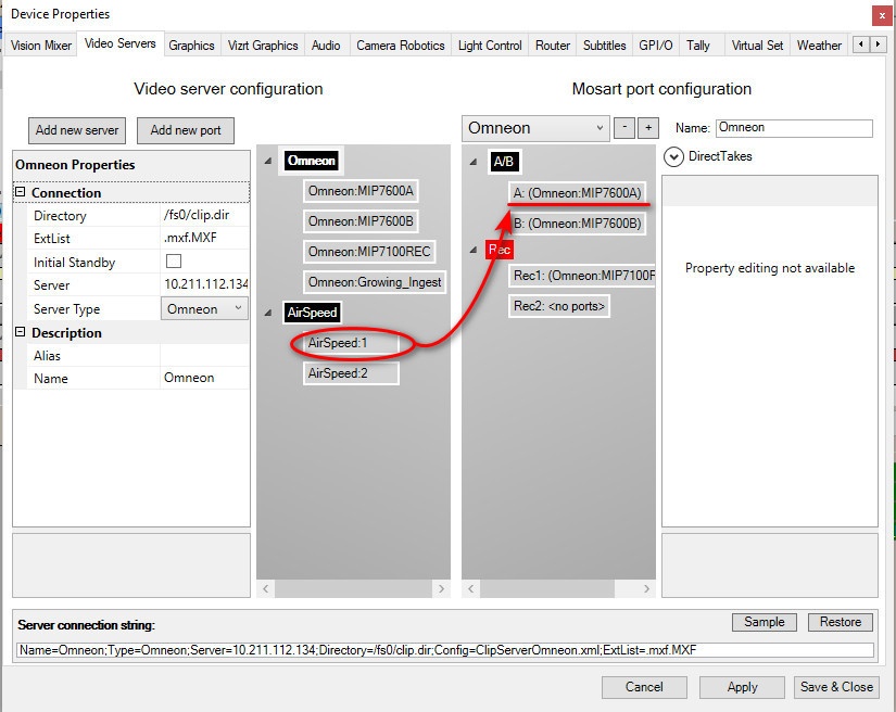

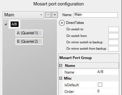

Mosart Port Configurations
The right-hand part of the Video Servers tab (titled 'Mosart port configuration', shown in the screenshot below) has three parts:
the salvo part (in the screenshot the first ‘line', starting and ending with 'Main’, and also the DirectTakes panel with four text boxes and labels)
a tree structure showing virtual ports and virtual port groups (the bulk of the left-hand side of the screenshot)
a panel showing the details of the virtual port or the virtual port group selected ('Mosart Port Group' in the screenshot).
A salvo is a particular setup of servers and ports. There will always exist at least one salvo. If several salvos are defined, these will usually involve different sets of servers and/or ports, and the user will be able to switch from the active salvo to some other salvo. This will involve, among other things, disconnecting from servers that will not be used in the salvo switched to, and connecting to servers that are to be used now. This will be discussed later.

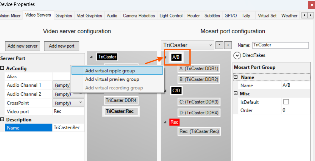

To add a virtual port group
Right-click in the Mosart Port Configuration tree (not on a node) and select either:
Add virtual ripple group to add a new virtual ripple group. The default ripple group names are A/B, C/D, E/F etc.
Add virtual preview group to add a new green virtual preview group to be used for preview ports. The default preview group name is P.
Add virtual recording group to add a new red virtual recording group to be used for recording ports. The default recording group name is Rec .
The virtual port group is added to all salvos.
You can edit or rename the selected group using the Properties Editor on the right.

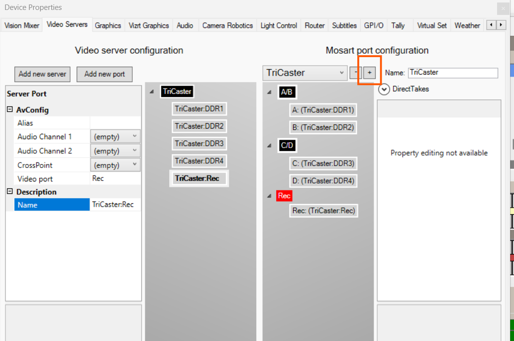

In the Mosart Port Configuration tree, right-click any group and select Add virtual port.
If the port was added to a preview group, the added port will be a preview port with default name P. If the port was added to a recording group, the added port will be a recording port with default name Rec.
Note: Do not change the name Rec!
If the port was added to a virtual ripple group, the added port will be a playout port. The name will be the first unused (for this purpose) (upper-case) Latin letter (A, …, Z).
Note: There is no relationship between the port name and the group name. For example, group A/B may have ports C and D, and vice versa.

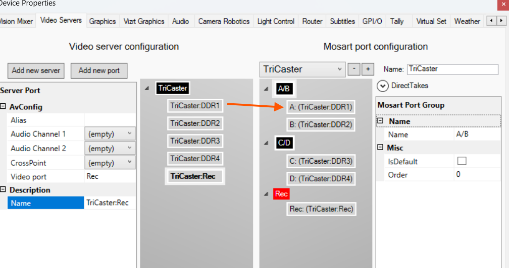

To link a server port to a virtual port
You can link a server port to a virtual port:
Select the server port (in the left-hand, Video server configuration part) you want to link, and drag it to the virtual port (in the right-hand Mosart port configuration part) to which you want to link it.
Note: If the virtual port is a recording port (in the recording group), the server port to link must also be a recording port: The physical server must have recording capabilities (and the chosen Server Type must allow for recording).
To inspect or change the details of a virtual port group
Select a virtual port group in the tree structure:
(Here, A/B is selected.) These details are available:
Name: The name of the virtual port group. This name is displayed in the will be among the options in the SERVERCHANNEL drop-down in the Videoserver Device properties in the Template editor.
IsDefault: Enable to set the default and preferred video port group for assets residing on multiple systems.
Order: Used by the Media Router only. (See the documentation of the Media Router.) If a Media Router is not used, this value can be left at the default 0.
Select a virtual port in the tree structure:
(Here, A is selected.) These details are available:
Audio Channel 1: The virtual audio fader 1 for the selected video port. If nothing is selected here, the audio fader from the physical port is used. Default: Empty
Audio Channel 2: The virtual audio fader 2 for the selected video port. If nothing is selected here, the audio fader from the physical port is used. Default: Empty
CrossPoint: The virtual video crosspoint for the selected video port. If nothing is selected here, the video crosspoint from the physical port is used. Default: Empty
Note: In most cases, the three fields above should be left at their default '(empty)'. Then the fader/crosspoint from the physical port will be used. Changing to a specific fader/crosspoint will override this. Do this only if you know what you are doing.
Name: The name of the virtual port. This name will be among the options in the SERVERCHANNEL drop-down in the Videoserver Device properties in the Template editor.
Main: Auto-generated display name of the linked server port (as explained in To link a server port to a virtual port above), if any.
Mirror: Auto-generated display name of the mirror server port. (This refers to mirroring, to be explained shortly.)

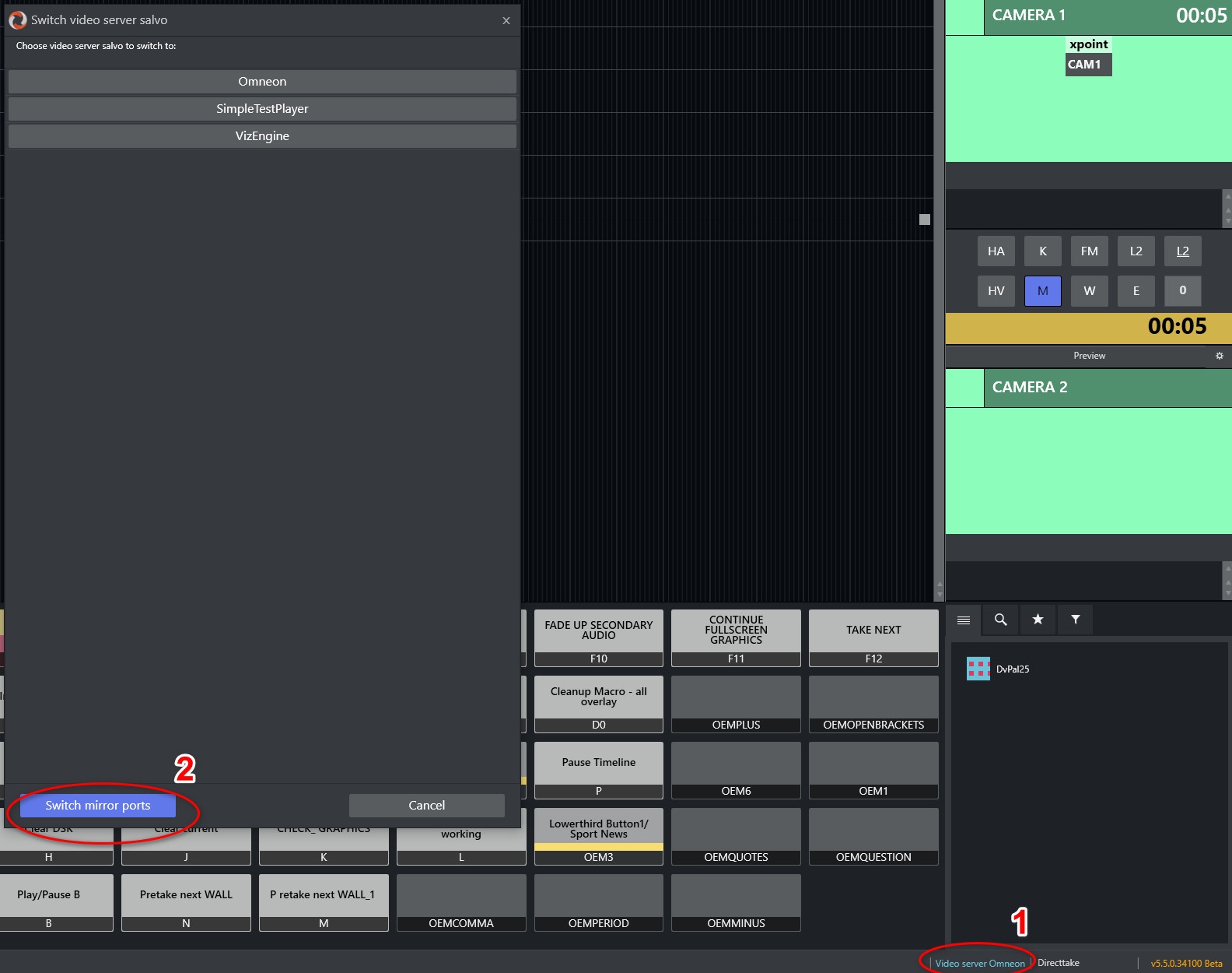

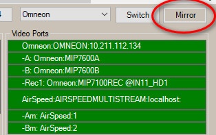

Verify that you can now switch between mirror ports
Either with the Mirror button in Av Automation
or
In the Mosart GUI.

Working with Salvos
A salvo is a particular setup of servers and ports. All salvos have the exact same virtual ports and port groups. Salvos differ only in the assignments of physical ports to virtual ports. There will always exist at least one salvo. If several salvos are defined, these will usually involve different sets of servers and/or ports. At any time, one salvo will be active. The user will be able to switch from the active salvo to some other salvo (which will then become active). This will involve, among other things, disconnecting from servers that will not be used in the salvo switched to, and connecting to servers that are to be used now.
Note: Salvos are distinct from Mirroring. When using Mirroring, both the Main and the Mirror ports are connected all the time.
There are several use cases for salvos:
Redundancy: To lessen the effect of video server malfunctions, Main and Backup salvos may be defined, presumably using different servers.
Different needs for different shows, or even within the same show (for instance, sports and news).
Note: It is recommended that the default Main and Backup salvos are not renamed.
The configuration of salvos are done in the upper line of ‘Mosart port configuration', and also in the 'DirectTakes’ panel:
The available UI elements are
Drop-down with the configured salvos, used for selecting a salvo for configuration or deletion. (If another salvo is selected, this salvo will become active. However, this is not the standard way of switching salvos during normal operation. The standard method is using the salvo controls in the main window in AV Automation.)
button for deleting the selected salvo
button for adding a salvo
Name: The name of the selected salvo.
Direct Takes
On switch to: The Recall Nr (see Template Properties) of the direct take template that should be taken when switching to this video server salvo.
On switch from: The Recall Nr of the direct take template that should be taken when switching from this video server salvo.
On mirror switch to backup: The Recall Nr of the direct take template that should be taken when switching to a backup server using this video server salvo.
On mirror switch from backup: The Recall Nr of the direct take template that should be taken when switching from a backup server using this video server salvo.
To add a salvo
Click the button.
A new salvo is created and automatically selected in the drop-down (and also becomes the active salvo). Please note that there are no linking of physical ports to virtual ports. You may want to make such links, and also to change the name of the new salvo.
To remove a salvo
Select the salvo to remove in the drop-down.
Click the button.
The selected salvo is removed. Another salvo is automatically selected in the drop-down (and also becomes the active salvo).
To modify a salvo
Click the drop down box above the Mosart Port Configuration tree and select the salvo you want to edit.
Rename the selected salvo in the Name textbox and/or
Add/change port links as described above.

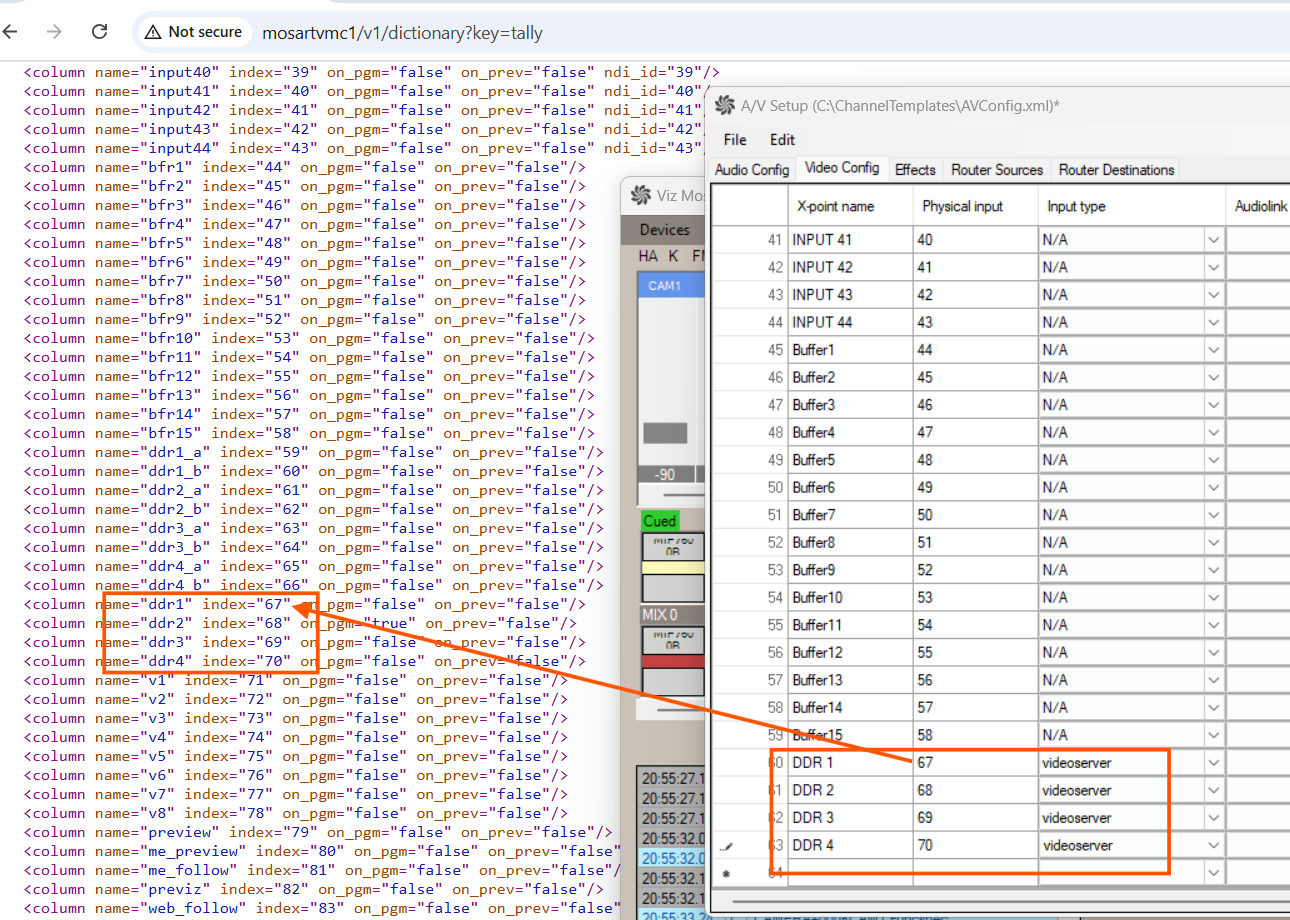

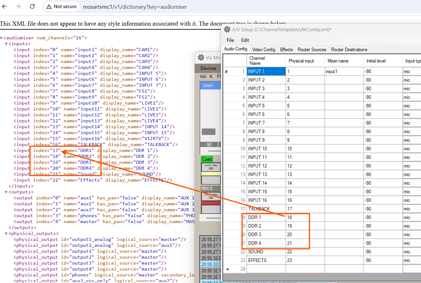

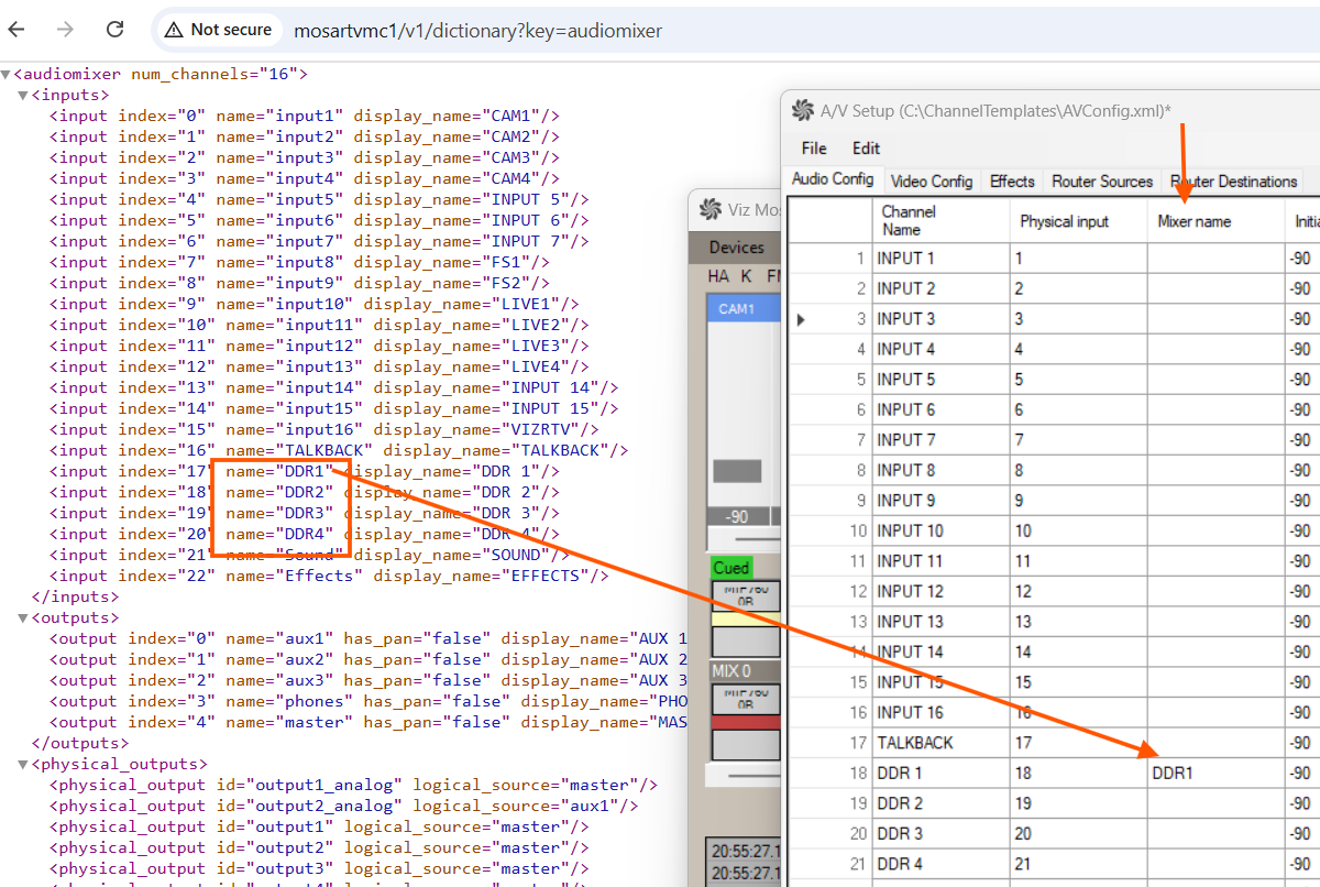

Configure the TriCaster audio and video channels in Mosart
Before configuring TriCaster as a video server in Viz Mosart, ensure that the audio and video inputs are correctly mapped in Viz Mosart’s A/V Setup.
Navigate to Av Automation > Devices > AV Setup > Audio config and configure the audio inputs as configured on TriCaster.
The input indexes can be taken by accessing TriCaster over REST API:
http://<TriCaster_host>/v1/dictionary?key=audiomixer
For audio, the indexes are 1-based, so add +1 to the number found in the the request response:Alternatively, the input name can be mapped to the Mixer name column in A/V Setup in which case the Physical input value is not relevant, but must be filled to a number unique within the values from that column.
Navigate to AV Automation > Devices > AV Setup > Video config.
Add the crosspoint mapping video server ports as configured on the TriCaster.
http://<TriCaster_host>/v1/dictionary?key=tally

Navigate to AV Automation > Devices > Properties > Video Servers.
Under Video server configuration on the left side, click Add new server
If not in focus, click on the newly created black box, New server.
From the Server Type drop-down menu, select TriCaster.
Name the server appropriately by filling in Name.
Click on the black box (see below) and configure the following properties for the server:
Server: http://<TriCaster_host> as IP number.
Directory: {volume}:/Sessions/{session name}/Clips/Import
See To find session name below.
Extension: let it empty (when Media Service is used, no extension is needed).
Note: The clip id can be given from NRCS without extension.
Name: Any meaningful name. Make sure the name is the same as the connection string provided in Media Admin.Right-click the black box and add a port corresponding to each DDR port configured in TriCaster, DDR1, DDR2 etc.
For each server port added on the left side, configure:
Audio channel 1: Select the audio channel configured in A/V Setup > Audio Config that is associated with the first mono channel of the stereo pair for playback from a DDR port in TriCaster.
Audio channel 2: If applicable, select the audio channel in A/V Setup > Audio Config that is associated with the second mono channel of the stereo pair for playback from a DDR port in TriCaster.
CrossPoint: Select the video channel configured in A/V Setup > Video Config that is associated with a playout ports in TriCaster.
Video port: The physical port names as configured in TriCaster, DDR1, DDR2, DDR3 etc.
Name: Any meaningful name.Add a recording port where the physical name must start with Rec:
Info: From Viz Mosart, you can start the global TriCaster recorder, triggering the recording of any configured recording sources.

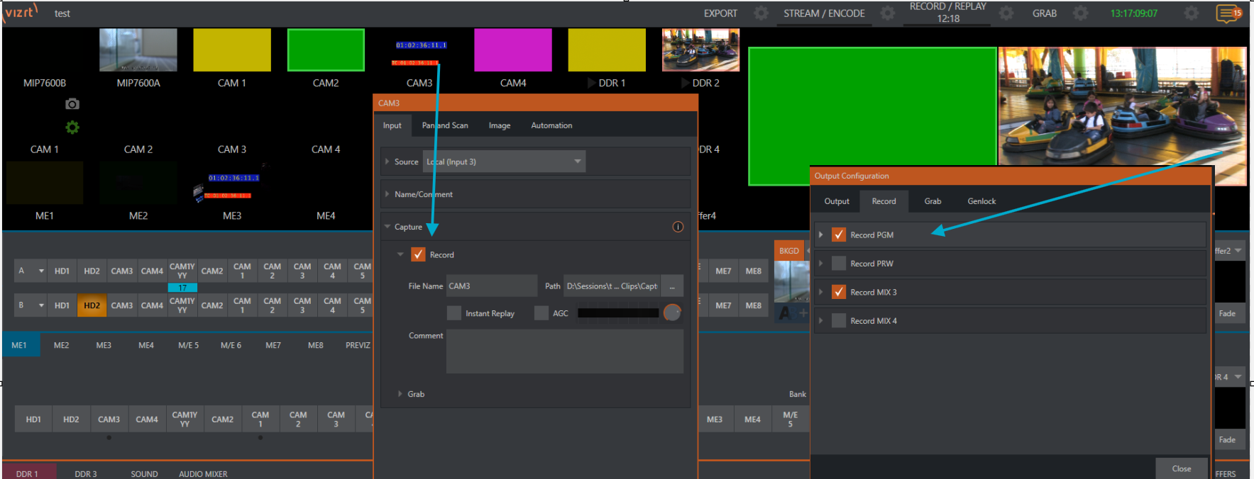

TriCaster offers two types of recording options:
MIX Output Recording: Records one of the four MIX outputs (PGM or other selected outputs).
ISORecorder: Records specific input sources configured for isolated recording.
When recording is triggered from Mosart, any MIX output or ISORecorder inputs that have been enabled for recording in TriCaster will automatically start recording.
The recorded files are stored based on the recording configuration set in TriCaster’s record settings.
Note: Ensure that the necessary sources are enabled for recording in TriCaster’s settings before triggering the recorder from Mosart.
Click the Plus sign on the right under Mosart port configuration to create a salvo for TriCaster:
In Name, give this new virtual server an appropriate identity, for example, TriCaster.
Right-click on the black box to add a virtual port group.
Click on the first Video server configuration (physical) port on the left half and drag-and-drop it to the first virtual one on the right under Mosart port configuration.
Repeat with the second port, by dragging another physical server port from the left side to pair them into an A/B ripple port playout group.
Add another virtual ripple group with 2 virtual ports and link them with the rest of the physical ports, if any.
A virtual recording group with one virtual port and link the physical recorder port to the virtual one in the same way as explained in step 12.
Click Apply, then Save & Close.

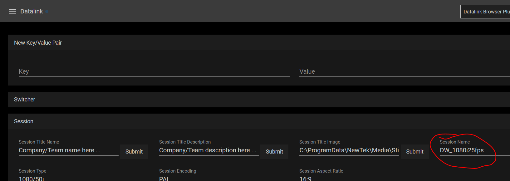

Note: To find session name:
Navigate to the TriCaster DataLink menu:
The session name is also displayed on the TriCaster home page (hidden menu at the top left corner):
