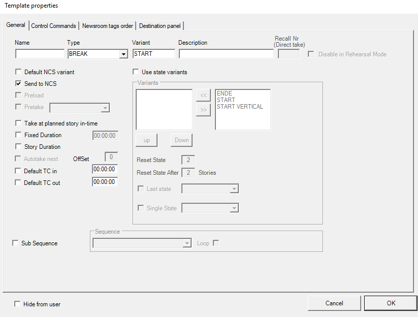

This section explains the configurable fields on the General tab of the Template Properties menu, and also clarifies the function of a Sequence.
Configuration Descriptions
Item
Description
Name
The name of the template. This value will only show in log files. English language is preferred, for making it easier to understand log-files.
Type
The different primary and secondary templates types are described in the Viz Mosart User Guide, section Viz Mosart User Interface under Rundown Window.
Variant
The variant is a unique name for the selected type, and should match the value entered in the newsroom system.
Description
Description of the template (optional). English language is recommended, for future maintenance purposes.
Recall Nr (Direct take)
(Applies only for templates in the Directtakes template set). One or more decimal digits. If this direct take template is to be recalled from the GUI using the numeric keypad, a maximum of four digits is allowed. (If more than four digits are used, the template may still be executed using e.g. a control command.) The number must be unique among all direct take templates.
Note: Avoid starting numbers with zero (0). For example, use 56 instead of 0056.
Disable in Rehearsal mode
(Applies only for templates in the Directtakes template set). The direct take will not be executed when in Rehearsal Mode
Default TC in
Default TC out
Default NCS variant
This sets the template as the default variant for the selected type.
Send to NCS
When selected, allow Manus Administrator to send this template to the NRCS, using MOS NRCS feedback.
Preload
When selected, enable the preview functionality for the Accessory template. The Accessory template must have time code 00:00 for this to function.
Only valid for Accessory templates.
Take at planned story in-time
If you want a story to start at a specific time of day, you can add a template with this option checked, to a story that has a set "hit time" in the NRCS. The "hit time" must be included in the story data sent to Viz Mosart, and the field-name must be mapped to back_time in Newsroomsettings. See Story External Metadata.
Fixed Duration
Make the template always have the same length (overriding the time from the NCS) in the Viz Mosart rundown. Select this option and enter the time in mm:ss:ff (minutes:seconds:frames). This can also be combined with Autotake to make a frame accurate continue to the next story. Remember to write the whole number each time, you cannot edit a single character at a time.
Story duration
When selected, the duration of the template will be set equal to "story editorial duration", coming from the NRCS. The "story editorial duration" must be included in the story data sent to Viz Mosart, and the field-name must be mapped to story_duration in Newsroomsettings. See Story External Metadata.
If more templates are added to the story, their duration will be in addition to the "Story duration" template, so calculated total duration of templates will be greater than "story editorial duration".
Autotake next
(Available for primary templates only, cf. Type above.) When selected, automatically perform a Take Next (F12) at the end of the template's duration, with an offset as described in Offset below
Offset
Set the offset when Autotake is enabled to adjust the Viz Mosart continue action at the end of the event. The value is in frames. A positive value will make the continue action happen later. A negative value will make it happen earlier.
Sub Sequence
See separate explanation below this table.
Sequence
Loop
Hide from user
When selected, this template is excluded from the template list in both the Mosart UI’s Quick Editor and the NRCS Plugin, making it unavailable for user selection.
Use state variants
Please refer to Other Template Functionality for explanation of state variants.
