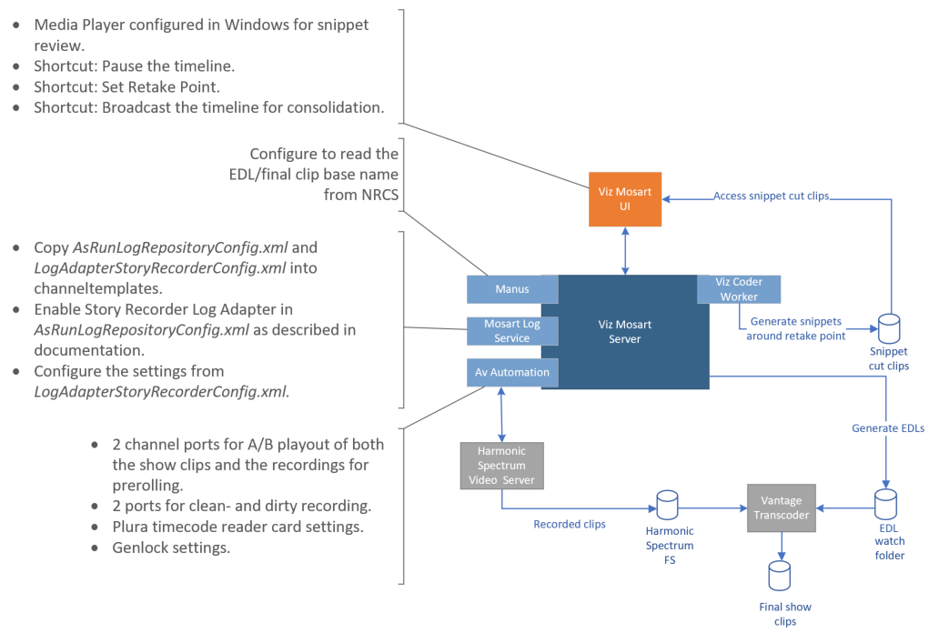

Story Recorder (SR) both introduces new system components and repurposes existing functionality. Important to note are:
  • The Mosart Logging Service plays a significant role together with a new Story Recorder Log Adapter, for capturing events for recording.
    This new log adapter must be configured after installing the Mosart server.
  • A snippet transcoder, Vizrt's Coder, is added to the installation.
The relationships between the system elements introduced with SR are presented below. This example has a Harmonic Spectrum video server and Vantage for EDL transcoding:
Note: The folder where the final show clips reside is not controlled by Viz Mosart. This is set on the EDL transcoder side. In the above setup, the EDL transcoder is Vantage.

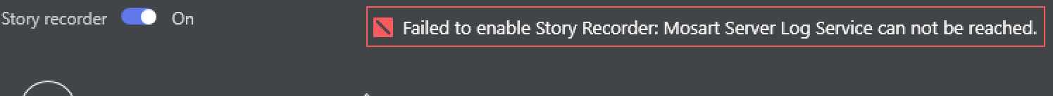

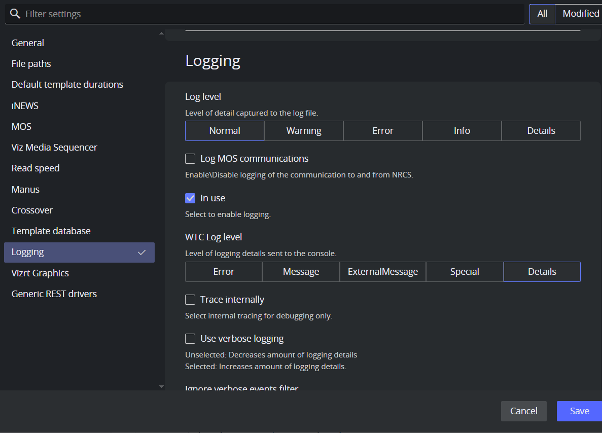

  1. In the Manus Administrator console, type settings and verify that Logging > In use is set to True:

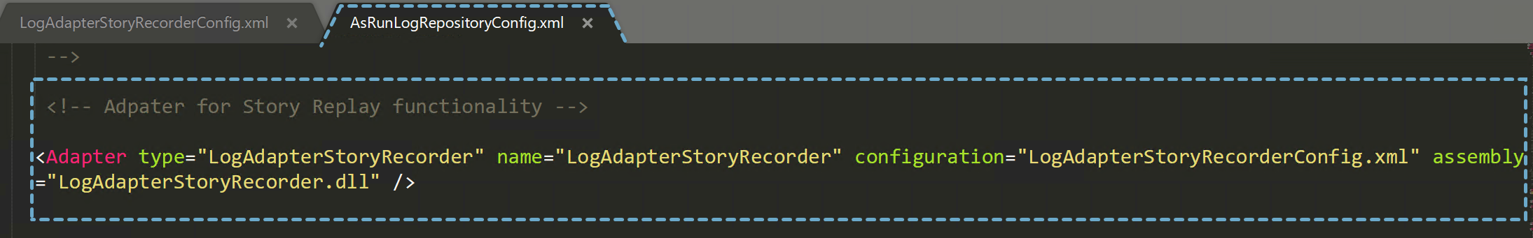

  3. Open AsRunLogRepositoryConfig.xml in an editor and add or uncomment the following line:
    <Adapter type="LogAdapterStoryRecorder" name="LogAdapterStoryRecorder" configuration="LogAdapterStoryRecorderConfig.xml" assembly="LogAdapterStoryRecorder.dll" />

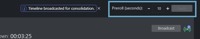

    MinPrerollDuration
    The minimum and default preroll duration in seconds that the Preroll template will insert.
    This time needs to be sufficient for the video server to reset and be ready to record, after being paused. Typically 10-15 seconds.
    The preroll duration can be increased by the user in the Story Recorder UI, see Minimum Pre-Roll Duration.
    Default: 10.
    MaxPrerollDuration
    The maximum preroll duration in seconds that the Preroll template will insert. (See MinPrerollDuration above.)
    Default: 30.

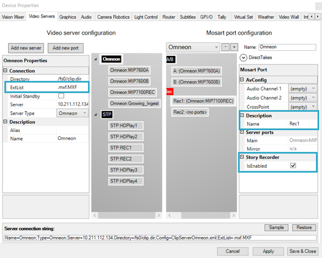

To configure video server recorder ports for Story Recorder
  1. In AV Automation, navigate to Devices > Properties > Video Servers.
  2. The settings for the Video server configuration and Mosart port configuration are already OK for a working system.
    Otherwise, refer to section Video Servers.
  3. Configure the recording port(s) dedicated for Story Recorder.
  4. For the recording port(s) mentioned in the step above, select IsEnabled in the Story Recorder section.
    This setting reserves the selected port for Story Recorder.
  5. Click Apply then Save & Close.
  6. Force a reconnect to the video server with Ctrl+Shift+V.
    (or restart of Av Automation).

  • When only one recorder is configured, the clip name pattern is<RecordingClipNamePrefix>_<counter_<timestamp>.<extension>, where
    - The RecordingClipNamePrefix is the setting configured in step (4), when enabling the log adapter earlier.
    - The counter is reset to 1 for each Story Recorder session.
    - The extension is configured in AV Automation > Devices > Properties > Video Servers > ExtList (the first in the list will be chosen). See the previous screenshot.
    For example:
    SRVizrt_1_211001153956.mxf
    SRVizrt_2_211001153956 .mxf
    SRVizrt_3_211001153956.mxf
  • When more than one recorder are configured, the clip name pattern is <RecordingClipNamePrefix>_<recorder name>_<counter_<timestamp>.<extension>, where
    - The <recorder name> is the Name setting configured in Devices/Properties/ Video Servers on the virtual recorder port properties (see setting Name set to Rec1 in the previous screenshot).

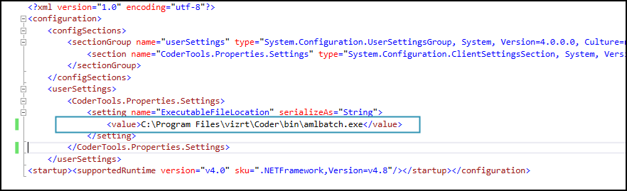

    Install Coder on the same machine as the Viz Mosart Server. Coder's default installation location is in C:\Program Files\Vizrt\Coder.
Note: If you install Coder anywhere but the default location, you must then update the following configuration, to specify the new path to the Coder executable, amlbatch.exe:
This config file is C:\Program Files (x86)\Mosart Medialab\Mosart Server\CoderTools.dll.Config.

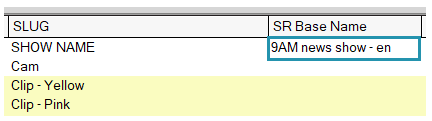

From the NRCS, you can add a name that becomes the base of the final clip name in Story Recorder.
  1. In the NRCS, open the corresponding rundown for the show.
  2. Add an NRCS column (here for example, SR Base Name).
    The procedure is NRCS-specific and may require administrator privileges.
    The following example is from iNews.
  3. Under this new column, provide a name for the show, in the first story in the rundown (here, 9AM news show - en).
Note: Viz Mosart will only read the naming at story level, from the first story in the NRCS rundown. If the name is placed in any other story, it will be ignored.
Tip: If your NRCS operates on rundown level, not story level (for example OpenMedia), you can create a script that will propagate your desired final story name (as a text field on rundown level) to all stories in your rundown. As this also populates the first story, Viz Mosart will then successfully read the name.

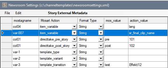

  2. In the Viz Mosart console application Manus Administrator, type ns. This opens the Newsroom Settings menu.
  3. From the menu bar select Edit > Story External Metadata and add the following row if not already present:
    where
    mostagname: the column name as specified in the NRCS (in this iNews example, var-007).
Note: For details on how to derive this naming (here var-007) from the NRCS, refer to section Story External Metadata in Newsroom Settings Editor.
Mosart Action : must be set to item_variable .
Format Type : must be set to String .
mos_value : empty.
action_value : must be sr_final_clip_name .

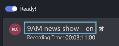

    1. Provide the Final Clip Show name as described.
    2. Load the rundown in Mosart UI.
    3. Enable Story Recorder mode (see Viz Mosart User Guide, in the Story Recorder section).
    4. Check that the name entered in Managing Naming of the Final Clip Show, appears in the Story Recorder UI when the associated rundown is loaded and Story Recorder mode activated.
Any changes made in NRCS for the Final Clip Show name are not taken into consideration during a Story Recorder session, but only when Story Recorder mode is again activated (so in the next Story Recorder session).

Pre-Roll Duration
The pre-roll period must be long enough for the video server hardware to reset itself and be ready to continue recording, after a pause.
To set a pre-roll duration
  1. Determine the time required by your video server hardware to commence recording. This is typically 10-15 seconds.
  2. Configure this value as described in MinPrerollDuration.
  3. You may increase the value in the SR panel:
    This setting is retained between SR sessions.

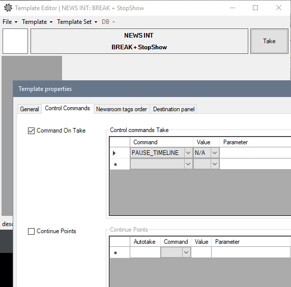

Automatic Pause at Show End
As an option, you can automatically pause the show and recording.
To set automatic pause
  1. Create a dedicated template, typically a Break.
  2. Define a PAUSE_TIMELINE control command configured on the template.
  3. Insert this template at the end of the rundown.
In the Story Recorder session, when the story before this template is taken on air, a message warns the operator that the next story is going to pause the show and thus the recording too:

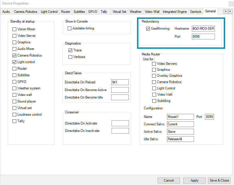

Failover
This step is optional and it assumes that Viz Mosart is already set up with redundancy as described in section Redundancy.
This means that:
  • Both the Viz Mosart main and backup server have same configurations for at least Mosart Administrator, AV Automation, Media Administrator and Overlay Graphics Interface.
  • AV Automation is configured for mirroring on both main and backup servers (with main pointing to backup and backup pointing to main):

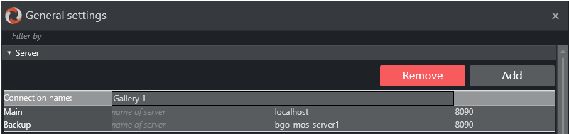

  • The Viz Mosart UI is configured to connect to the backup server:
For Story Recorder, there are additional steps:
  • Story Recorder is configured on both main and back in the same way. For simplicity, once main has been configured for Story Recorder mode as describe in section Enabling the Story Recorder Log Adapter, copy AsRunLogRepositoryConfig.xml and LogAdapterStoryRecorderConfig.xml in your working folder from the backup server (Channeltemplates or ProgramData).
  • Open LogAdapterStoryRecorderConfig.xml from Mosart main server in an editor and provide the hostname and port to the backup server (BackupHost and BackupPort) as described in Enabling the Story Recorder Log Adapter, step 4.
  • Open LogAdapterStoryRecorderConfig.xml from Mosart backup server in an editor and provide the hostname and port to the main server (same BackupHost and BackupPort settings) as described in Enabling the Story Recorder Log Adapter, step 4.
  • Both main and backup machines have Plura card installed and Viz Mosart configured to connect to Plura as described in Frame Accurate System Operations.
  • (Optional) If Snippet generation around the cut point has been set up for main, this should be set up in the same way for backup. Install Viz Coder on both main and backup server.
    The snippet folder configured in LogAdapterStoryRecorderConfig.xml where the Viz Mosart UI has access, needs to be configured to be the same on main and backup.
  • Same calibration settings from AV Automation: Devices > Properties > Genlock tab should be configured for main and backup.
Verification
  • The video server is prepared for recording.
  • Viz Mosart is prepared to run in Story Recorder mode.
  • Snippet generation around the cut point is configured (optional).
  • The integration is now established between Viz Mosart and the NRCS (optional).
  • Failover is setup as described (optional).
  • Ensure you have calibrated the system to frame accuracy, as described in section Frame Accurate System Operations.
The Viz Mosart operator instructions, for switching on and running Story Recorder are described in the Viz Mosart User Guide, in the Story Recorder section.

Failure to Enable Story Recorder Session
When the user switches on SR in the UI, you see:
Check these scenarios, in this order:

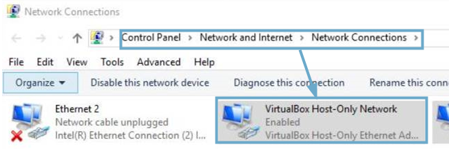

  • Viz Mosart Server and Mosart UI or Mosart Audio Player are on the same machine and the server was not installed last.
    If you installed the server before the UI or Mosart Audio Player, Mosart Log Service will incorrectly point to a copy of MMAsRunLogService.exe that is located in the Mosart UI or Mosart Audio Player folder installation. Instead, this should point to the MMAsRunLogService.exe located in Mosart Server installation folder:
To fix this, you should either stop the Mosart Log Service from Services and start it as console from Mosart Medialab\Mosart Server\ MMAsRunLogService.exe (although you will still have same problem after a machine restart) or re-install the applications in this order: first the UI/Mosart Audio Player and then Server.
After Mosart Log Service is started, enable SR again.
  • Verify that the (new) Story Recorder Log Adapter, and the config LogAdapterStoryRecorderConfig.xml are setup according to section above, Enabling the Story Recorder Log Adapter, around step (3).
A common oversight is that someone forgot to un-comment the lines for Enabling the Story Recorder Log Adapter for Story Replay functionality in AsRunLogRepository.xml.
For additional help, refer to the general topic Troubleshooting Log Adapters.

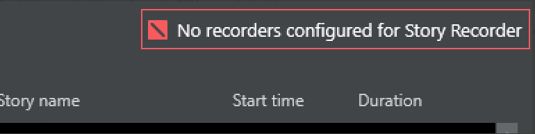

Recording Ports not Found
If when you switch on SR, you get errors about No recorders configured for Story Recorder, this indicates that the connection to the video server that performs the recorder is faulty.
  • Ensure you set up Viz Mosart, with correct configuration settings selected, as explained above in To configure video server recorder ports for Story Recorder.

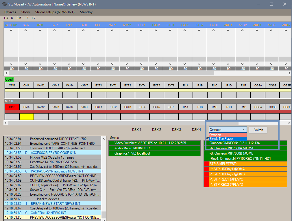

Even if the configured recording ports are enabled for Story Recorder as described above, you may also get this error message after switching to a different video server salvo.
After switching to a different salvo, perform the following steps:
  1. Check that there are recorder port(s) configured and enabled for Story Recorder as explained above in To configure video server recorder ports for Story Recorder.
  2. Restart AV Automation or force a reconnect to the new video server (use Ctrl+ Shift + V).
    This step should be done regardless whether the previous step was necessary or not.

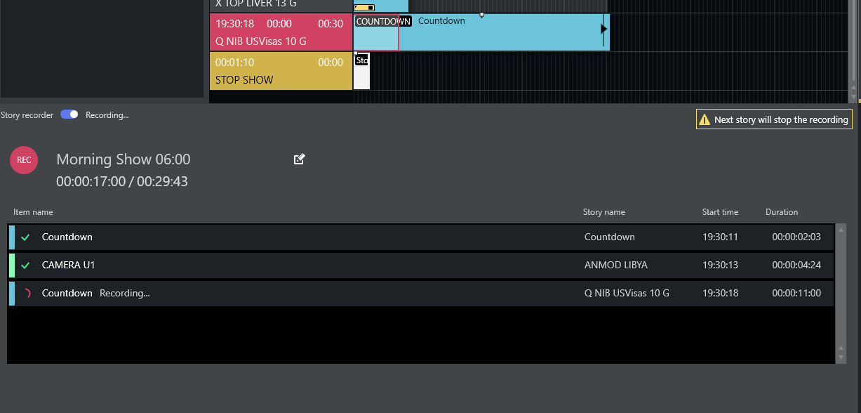

Failure to Start Recording or Story Items not Recorded in Story Recorder Panel
Recording does not start and no story items appear in the Story Recorder panel.
  • Verify in Viz Mosart Manus Administrator that logging is enabled:
    Open Media Administrator and type settings.

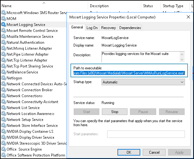

  • On the machine hosting the Viz Mosart server, check that service Viz Mosart Logging Service is up and running (as service or console).
    If running as a service, verify that it points to MMAsRunLogService.exe from the Viz Mosart server installation folder.
  • If the Viz Mosart Logging Service is restarted while other applications are running OK, then an action in the Viz Mosart UI (for example, reloading the rundown) must be performed to reestablish the connection to the Viz Mosart Logging Service.
    Until a Viz Mosart UI action is made, no events are logged in the AsRunLog for the first story item taken on-air.
    This leads to Story Recorder not functioning correctly. For example, recording may appear to start OK, but no story items show up in Story Recorder panel.
