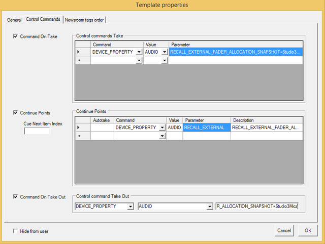

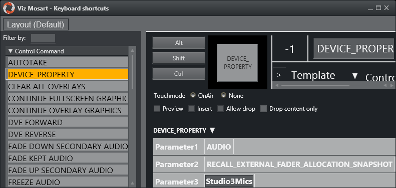

Calling Scenarios with control commands
Scenarios are invoked through control commands. These control commands should be structured as follows:
Command: DEVICE_PROPERTY (usually selectable in a dropdown)
Value: AUDIO (sometimes, but not always, selectable in a dropdown)
Parameter: RECALL_EXTERNAL_FADER_ALLOCATION_SNAPSHOT=Studio3Mics.
Note: Studio3Mics is an example only. In practice, provide the current scenario name (file name without extension xml).
In Template properties it looks like this:
On the UI:
