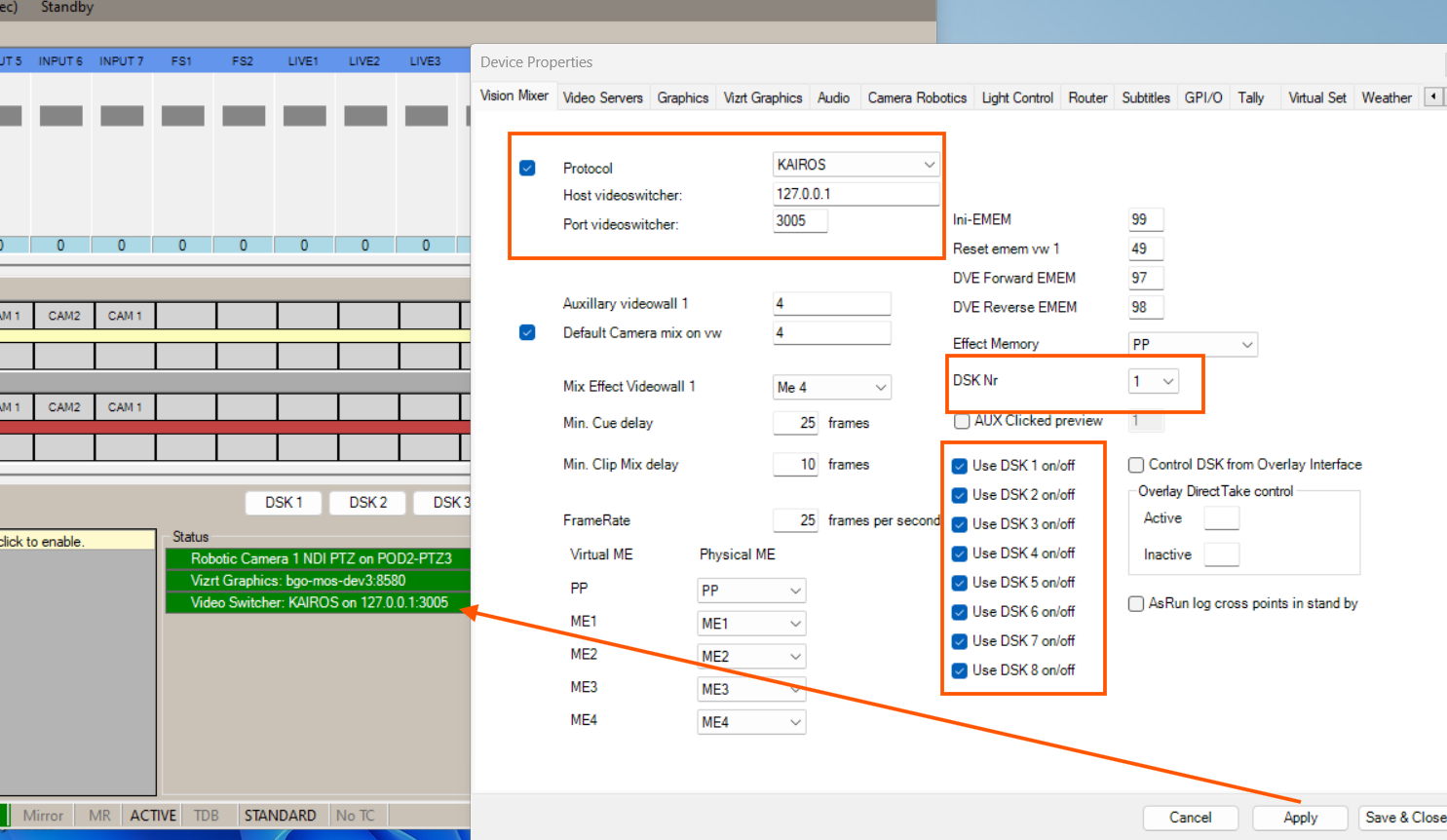

General Switcher Configurations
From the AV Automation menu bar select Devices > Properties > Vision Mixer to configure the connection to the switcher and which downstream keyers (DSKs) to use.
Apply the settings and verify the connection status in the AV Automation UI.

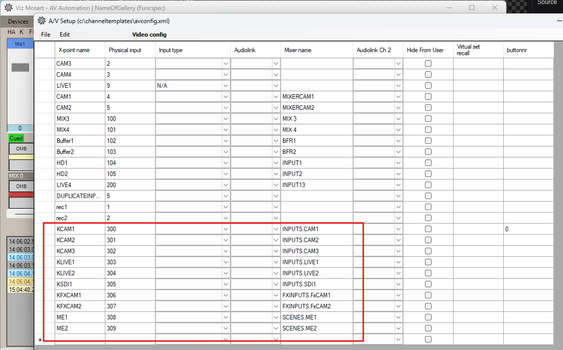

Crosspoints
To define Kairos crosspoints
Open AV Automation > Devices > AV Setup > Edit > Video config tab and set up the crosspoints mapped to Kairos input sources following the example below (using the user-friendly names provided in Kairos).
Note: The full path must be given with separator. The default separator is dot, which can be changed in KairosVideoSwitcherConfig.xml.

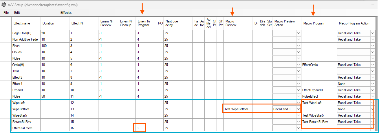

Effects
Vision mixer effects are managed in Viz Mosart as macros, using either the global macros or scene macros that have been created in Kairos.
To control a Kairos effect
Open AV Automation > Devices > AV Setup > Edit > Effects tab.
Add the full macro path.
Example
In the screenshot below, the effects WipeLeft, WipeStar5 and RotateBLEmem are configured as global macros to be executed on Program.
The effect WipeBottom is configured as global macro to be executed on Preview.
The effect EffectAsEmem was configured to recall a snapshot in Program, but to actually execute a transition you still need to provide a macro on Program.

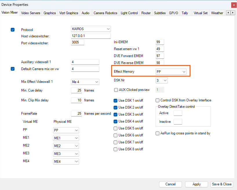

Note: EMEMs (snapshots) can also be recalled from an effect but not to play a transition.
The Effect Memory setting from the AV Automation Devices > Device Properties (Vision Mixer tab) is used to build the full path for the snapshots recalled in this way:
The EMEM number 3 is mapped in the Kairos config file to a snapshot created in Kairos.
Note: The snapshots are created per scene. For different regions, different snapshots need to be created.

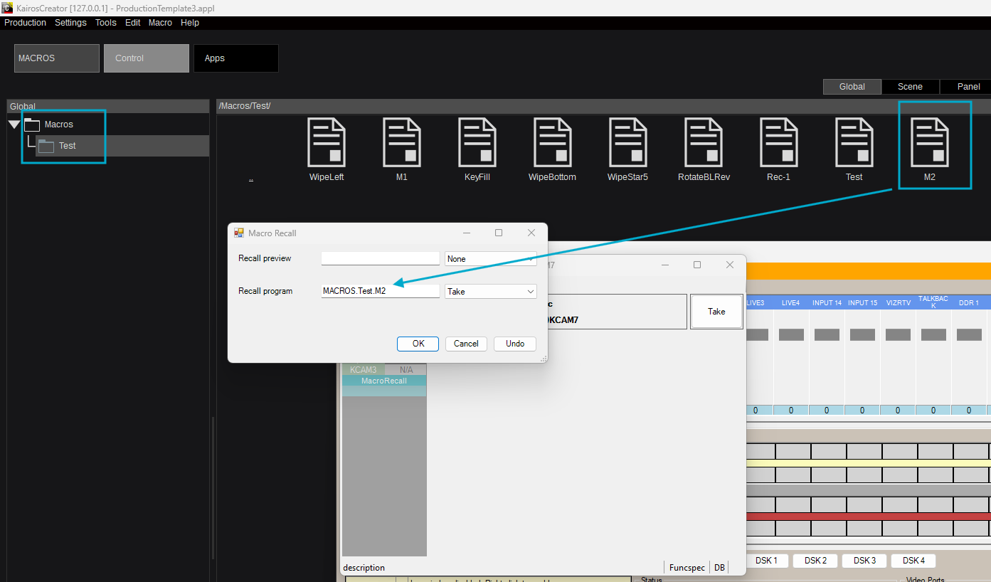

Managing Macros
To recall a macro from a Mosart template
Specify the full path to the macro you want to recall.
Note: When recalling a Mosart template from Kairos, there is no need to configure anything beforehand in the KairosVideoSwitcherConfig.xml (the macro device in the template can handle names as well as numbers).
