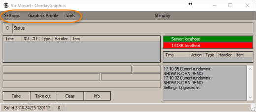

A menu bar at the top offers Settings, Graphics profile, Tools and Standby.

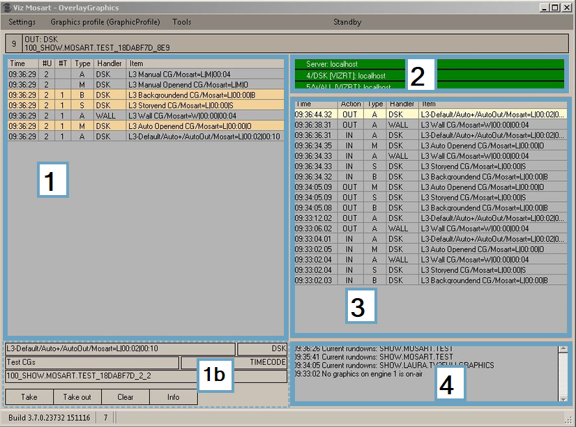

The Overlay Graphics interface consists of four main areas ([1] to [4] in the illustration).
A status bar at the foot of the UI provides information on product version number and the total number of graphics in Viz Mosart (rundown overlays + named overlays + button overlays. 7 in the example above).

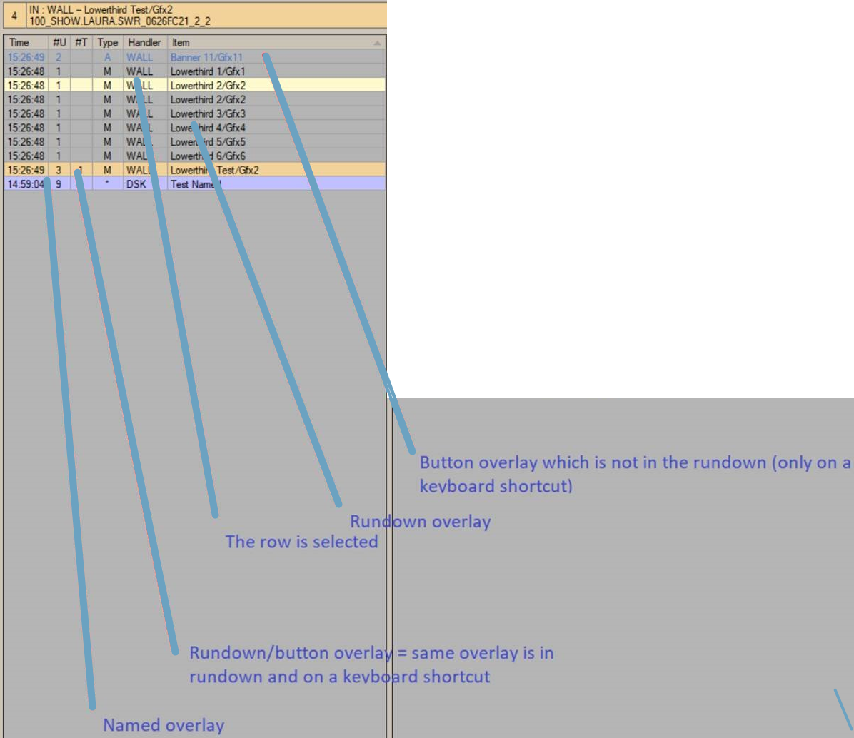

The main column labels are:
Time: The time when the graphic was added in Overlay Graphics (usually at rundown import).
#U: The number of times this graphic has been updated.
#T: The number of times this graphic has been taken.
Type: The graphic type. Can be:
Type | Description |
A | Auto Out (a Manual CG can also be Auto Out) |
B | Background End |
S | Story End |
M | Manual (Open End) |
L | Last Out |
- | Stay Always |
> | If template is STORYSTART |
*** | None of the above |
Note: Locator is a special graphics item that is linked to a crosspoint. When taking the crosspoint from a Viz Mosart template, either as a switcher crosspoint or keyed crosspoint (in a DVE box), the graphics are also (re-)taken.

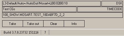

[1b] Details of a Selected Graphic from the List of Overlay Graphics
Selecting an overlay graphic from the list displays further details
Element | Description |
Graphic title | |
Handler name (the destination or the channel for this graphic) | |
Graphic description | |
Graphic ID Note: This is the Viz Mosart Graphic ID, not the graphic ID from graphic database (Graphic Hub/Oracle) | |
Action Buttons Take: Takes graphic on air Take out: Takes graphic off air Clear: Takes out all taken graphics Info: Opens an editor window where the graphic MOS item can be changed and updated |

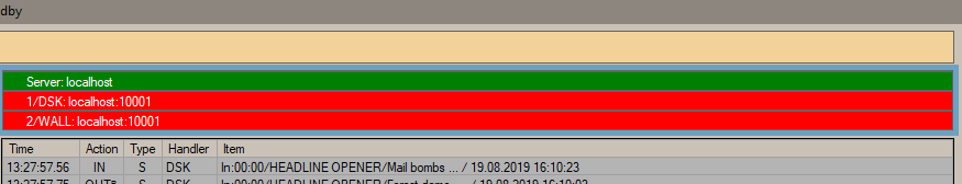

[2] Server Status
[3] General Log
The center-right contains a log of all actions performed on the overlay graphics either triggered by Viz Mosart or by clicking Overlay Graphics buttons.
To clear the General log area
Double-click inside it.
[4] Event Log
To clear the Event log area

Menu Bar
Settings
Properties: Opens Overlay Graphics Configuration.
Graphics Profile
See Graphics Profiles Tab.
Tools
Editor: Opens a Test graphics window.
Instrumentation Panel: Displays all device commands in real time, as sent to the various connected devices.
See Mosart Instrumentation Panel.
Standby
All the engines linked to the controller are set/unset to standby by clicking this toggle button.
Note: This action can also be performed from the Viz Mosart UI.
You can also take any engine individually into standby (only in the OGI application) while the other engines in the same controller are active.
