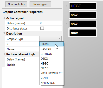

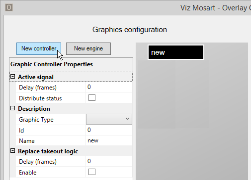

Open the Overlay Graphics Configuration window by going to Settings > Properties.
Click New controller.
In the Graphic Type drop-down, select the type of graphics system you are using (see Overlay Graphics Types).
Set additional controller properties according to the selected Graphic Type.

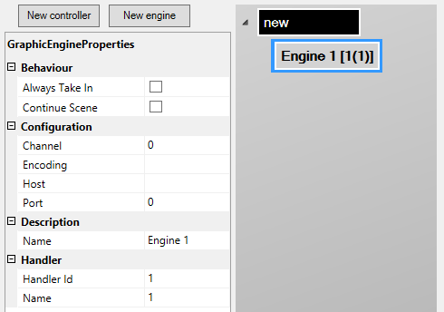

To add a new Engine
Open the Overlay Graphics Configuration window by navigating to Settings > Properties.

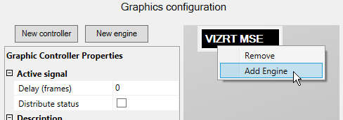

From the list of controllers, select the black box of the Controller you want to use.
Click New engine, or right-click the controller and select Add engine.
Set the engine properties according to the selected graphic type (See Overlay Graphics Types).
Optionally, set actions for selected system events using the Actions Tab (Event and Action Rules).

Common Graphic Engine Properties
The Graphic Engine Properties that are available depend on the graphic type of the controller. The engine properties common to most graphics types are described below.
The additional properties for each Graphic Type are described in Overlay Graphics Types.
Behavior
Always Take In: Turns off the logic that does not take in a graphic element that is already taken and no other graphic element has been taken since.
Continue Scene: Use continue for take out of scene based graphics.
Configuration
Channel: Defines the output channel from the graphics system. Set to 0 when not used for takes.
Encoding: Encoding to use on text. UTF-8 or UTF-16. Default: UTF-8.
Host: Defines the hostname or IP address of the graphics engine. See also descriptions for the various graphics types.
Port: Defines the TCP port to use when connecting to the graphics system.
Description
Name: The name of the engine.
Handler: ID and name of the handler. Note that if handler ID is changed and the engine is assigned to a destination, then the link must be removed and engine re-assigned.
Handler Id: Auto-generated ID.
Name: The name of the handler (auto-generated).
