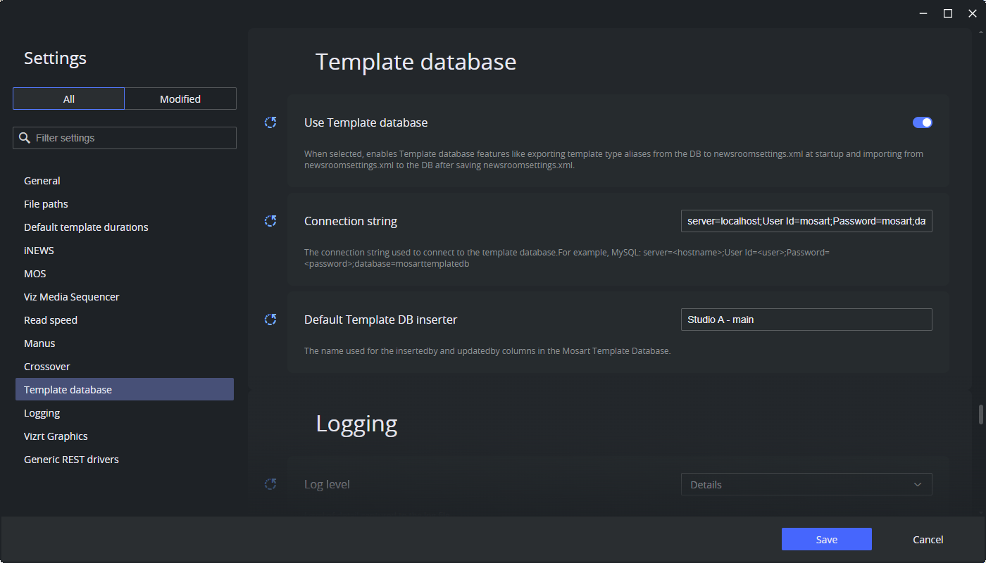

Ensure these settings are made:
Use Template database: Set to True to enable connection to the Viz Mosart Template Database (Default: False).
Connection string: The connection string used to connect to the template database.
For example, for a MySQL database:
server=<hostname>;User Id=<user>;Password=<password>;database=mosarttemplatedbDefault Template Db Inserter: The name to be used for the …_insertedby and …_updatedby columns, the entities enabling a database update.
These names are only visible in the database itself where the _insertedby and _updatedby columns are populated with this property.
We recommend to specify as ThisGallery + main/backup, to identify main and backup servers respectively.
Click Save.

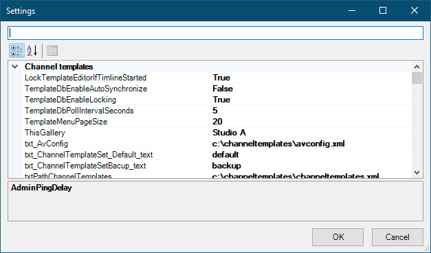

The following additional settings are set using the old settings dialog (accessed with CTRL + SHIFT + S):
ThisGallery: The name of the DB gallery representing the gallery of this Viz Mosart installation. This DB gallery need not exist, but will be inserted when saving in A/V Setup or saving to DB in the Template Editor.
The value must be identical for both the Mosart main and backup servers, with a unique name for each gallery (Default: NONSHARED).SharedGallery: This setting SHOULD NOT be changed from its default value, and not be changed using the Settings dialogue.
However, it can be changed in the MMAVAutomation.exe.config file, but this is not recommended (Default: SHARED).
SharedGallery is the DB name of the pseudo-gallery containing the shared template sets.
If Viz Mosart has been installed to use the Template DB functionality, this gallery has already been inserted into the DB.TemplateDbEnableAutoSynchronize: When true, idle Mosart Servers targeting the same gallery (ThisGallery) are automatically synchronized by AV Automation.
Changes made to a template on one Mosart server are automatically obtainable by the other Mosart servers.
This is typically used by Mosart main/backup servers. Recommended value: True (unless your show design has high-intensity template changes. See TemplateDbPollIntervalSeconds).
Note: Only idle servers will update automatically. Live servers requires a manual operation, for example by opening the Template Editor, clicking on the Status bar or by restarting AV Automation.TemplateDbPollIntervalSeconds: Number of seconds between Mosart server polling the database for updates.
Used by the synchronization mechanism to check whether a synchronization operation is necessary. If set to 0, 5 seconds is used. Recommended value: 5 seconds (Default: 0, giving 5 seconds).
Set to a higher value than the default (5 seconds) if multiple frequent template changes occur.TemplateDbEnableLocking (deprecated): Leave at default value (True). Only used on legacy systems, to ensure only one Mosart server gets write access to a template in the template database at a time, preventing two users from simultaneously editing the same template.
Restart AV Automation.

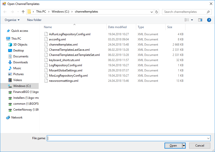

With AV Automation running, navigate from the menu bar to Devices > Template editor.
From Template Editor, open any channeltemplates.xml from file with File >Open.
Select required XML file from the list.
Click Open.
Note: After opening a template file in this way, File > Save will not save to the database, but to the opened file.
Only after completing next step File > Save To Database below, does this operation save to the template database.
Select the File > Save To Database.
The content of the selected channeltemplates.xml file is now uploaded to the Template Database.

Use Template database: Set to true to enable connection to the Viz Mosart Template Database (Default: false).
Click Save.
