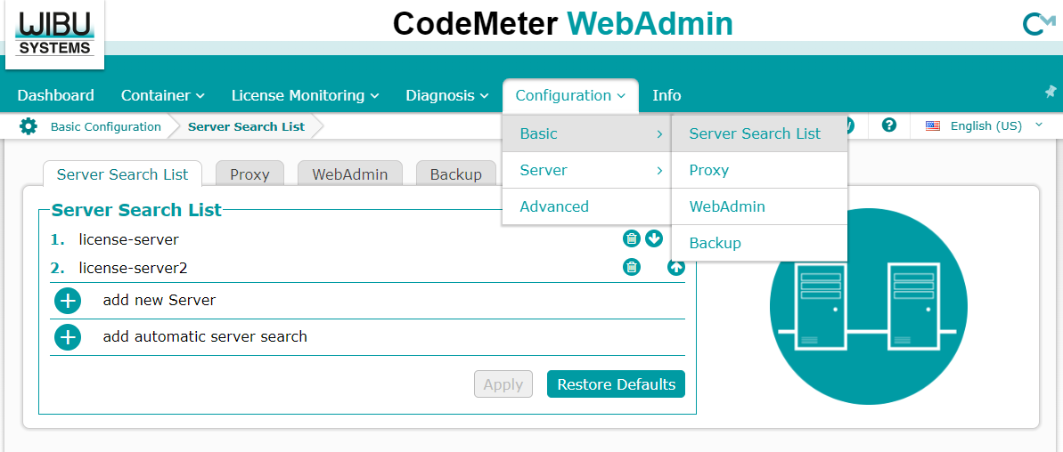

  2. Configure CodeMeter with the Vizrt Licensing Service or the CodeMeter WebAdmin (can be opened from the CodeMeter Control Center).

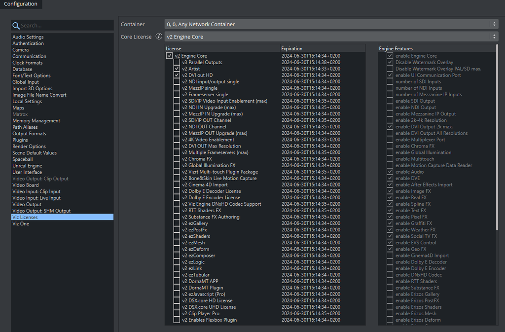

  3. Configure the license system in Viz Engine by starting in configuration mode and navigate to Viz Licenses.
    1. When using any WIBU network container (license server):
      1. Open the CodeMeter WebAdmin and add the license server to the server search list:
      2. In the configuration UI under Viz Licenses set Container to 0,0 Any Network Container or in the Viz Engine configuration file set License_Containers = 0,0,1.
      3. Configure the core license and any additional licenses. In the configuration UI under Viz Licenses configure Core License and Additional Licenses or in the Viz Engine configuration file configure License_Core and Additional_Licenses.
    2. When using any local WIBU container (dongle, file):
      1. In the configuration UI under Viz Licenses, set License Location to 0,0 Any Local Container or in the Viz Engine configuration file set License_Containers = 0,0,0
      2. Configure the core license and any additional licenses. In the configuration UI under Viz Licenses, configure Core License and Additional Licensesor in the Viz Engine configuration file configure License_Core and Additional_Licenses.
    3. When using a dedicated WIBU container (with full container identifier):
      1. In the configuration UI under Viz Licenses, set License Location to a specific container (for example, 130,3910158968 Network license) or in the Viz Engine configuration file set License_Containers = 13 0,3910158968,1
      2. Configure the core license and any additional licenses. In the configuration UI under Viz Licenses, configure Core License and Additional Licenses or in the Viz Engine configuration file configure License_Core and Additional_Licenses.
  4. Start Viz Engine.

Configuring the License System in the Viz Engine Configuration UI
See Viz License Configuration.
Note: By default, the WIBU licensing system with Engine Core license is used when no configuration exists. When no such license is available the configuration file must be edited. See Configuration Entries in the Viz Engine Configuration File.

Core Licenses and Their Effect
A WIBU license is a dedicated license (application ID) in the WIBU license system.
Core Licenses
Core licenses are used as prerequisite for other licenses and define the basic feature set.
Engine Core

Additional Licenses
Viz Artist Licenses
Artist
Shared
Enables the Artist Design User Interface. This is required to create new scenes.

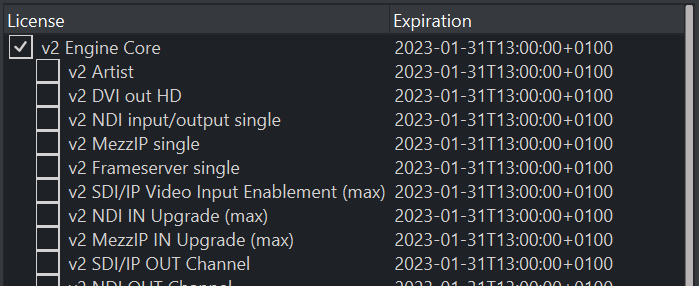

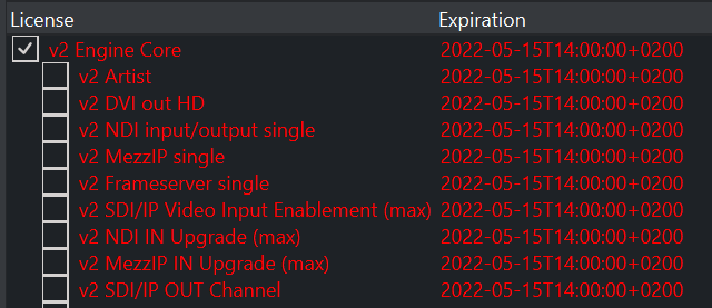

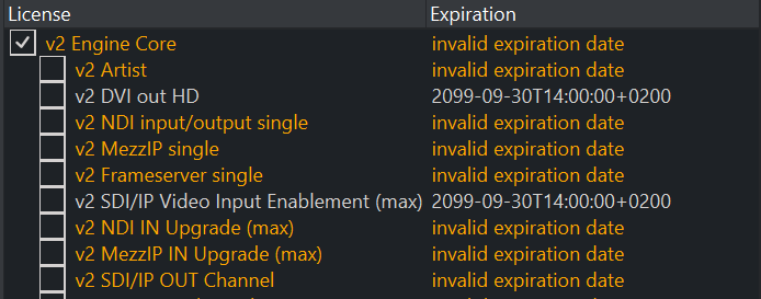

Colors used in License Overview
The following color schema is used in Viz Engine to display the status of the license:
Correct License (white)
Expired License (red)
Mixed "Permanent" Licenses
Note: A permanent license needs to have a end date set. If no end date is found, the license is invalid and should be renewed.
These licenses are marked as orange.

Setup Redundancy for a WIBU License Server
Setting up WIBU license server redundancy is described below. See License Server Redundancy in the Vizrt Licensing Administrator Guide for additional details.
Note: The grace period for acquired licenses is 72 hours if the license is lost to recover possible network issues or the license server.
Set Up Redundancy for a WIBU License Server
  1. Make sure two hosts (A & B) have VizrtLicensingInstaller.exe installed and select use as network license server during installation. See License Server Activation in the Vizrt Licensing Administrator Guide.
  2. Connect one WIBU dongle to 'A' and import a key with licenses.
  3. From WIBU web admin UI of 'A', make sure the container exist and all the added features are listed.
  4. On the client configure 'A' as first license server, and 'B' as second one (in the search list of the local CodeMeter web admin).
