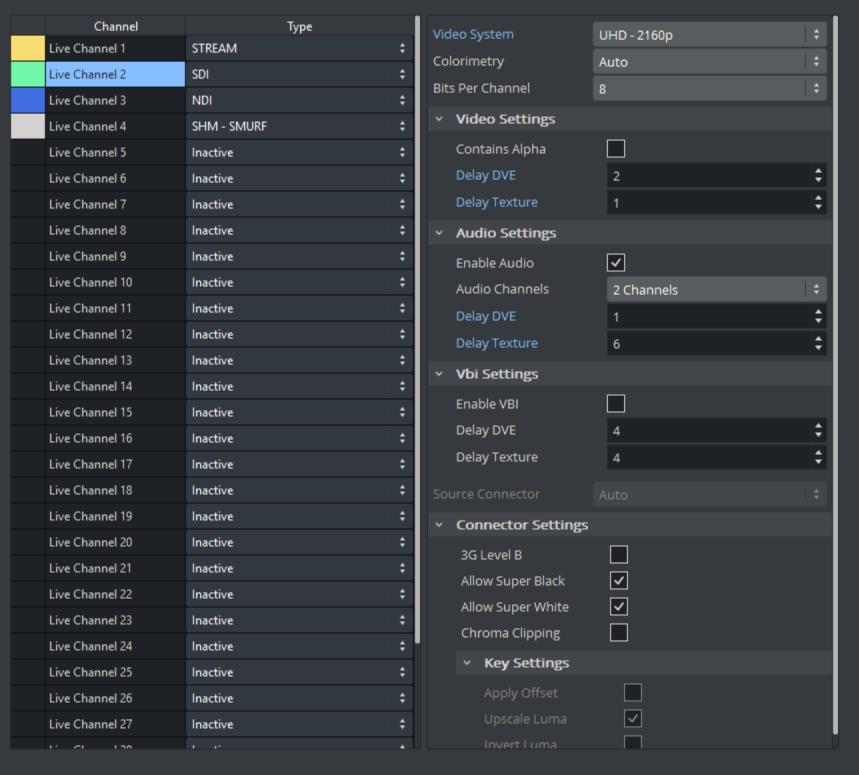

Use the Video Input: Live Input panel to configure channels utilizing external sources. The left hand pane defines the number of usable channels and their type. Depending on the video hardware you're using, the available types are:
SDI
IP (SMPTE ST 2110 or ST 2022-6)
STREAM
NDI
Various Shared Memory inputs
Information: The number of usable channels depends mainly on the installed video hardware.
Live Input Properties: Type SDI
Video System: Either the required resolution or Auto to use the configured output resolution. In case of a video wall setup (full screen or custom resolution), Auto falls back to 1080i and must be reconfigured if a different resolution is required.
Colorimetry: This setting is only relevant for HDR workflows and available for resolutions from 1080p upwards. Available options are:
ITUR_BT_709
ITUR_BT_2020
ITUR_BT_2100_HLG
Bits per channel: Defines how many bits per channel are processed for an input.
Note: Bits per channel is not supported on SD channels.
Video Settings
Contains Alpha: Enables alpha for this input. Only available on connectors that have an associated alpha connector.
Delay DVE: Sets DVE Delay of video when used as DVE.
Delay Texture: Sets texture Delay of video when used as Texture.
Note: Setting the texture delay of progressive inputs to 1 frame has a performance impact that scales with the aggregate bandwidth of the input signals.
Audio Settings
Enable Audio: Toggles audio for this channel. When set to
Inactive, audio is disabled. Default value isActive.Audio Channels: Defines the number of Audio Tracks to be used on the channel. The number of available track configurations is dependent on the Video hardware being used.
Delay DVE: Sets the number of frames the audio clip should be delayed in DVE mode before it can be mixed to the output. Default value is
4.Delay Texture: Sets the number of frames the audio clip should be delayed in texture mode before it can be mixed to the output. Default value is
4.
VBI Settings
Enable VBI: Defines whether VBI should be used for this channel. Set to Active or Inactive. Default mode is
Inactive.Delay DVE: Sets the number of frames VBI should be delayed before the clip can be used in DVE mode. Default value is
0(Off).Delay Texture: Sets the number of frames VBI should be delayed before the clip can be used in texture mode. Default value is
1.
Source Connector: Replaces Map To Viz Channel and assigns the selected physical connector to that channel.
Expert Settings
Delay After Input Graph: Adds a surface delay to compensate the time needed for pose estimation.
Multiconnector Mode: Defines which type of multiconnector mode is used when performing quad UHD or "None" in case a 12G channel is in use (A, B, C, D). Additionally, only channels A, E and I are allowed by Viz Engine to change this mode, although channels E and I can have only 2SI or Square Division set. Default value is None for channel A and 2SI for E and I. Otherwise this control disabled. Only available when using an X.mio5 12G card and Video System is configured to an UHD resolution.
Connector Settings
3G Level B: Toggles the Level B on that connector if configured to 1080p or higher.
Allow Super Black: Toggles super black on this connector.
Allow Super White: Toggles super white on this connector.
Chroma Clipping: Toggles chroma clipping on this connector.
