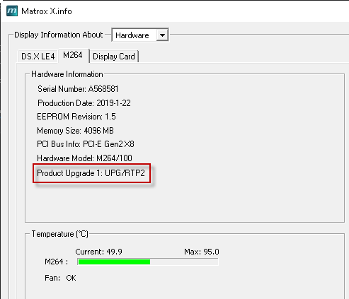

Example Matrox License Configuration
For a machine that has the following boards:
DSX.LE4L/8/100F with UPG/100/U55
M264/100 with UPG/RTP2
Choosing the DSX.LE4 as main board and the M264 as secondary board, the machine can:
Use the following input types: SDI, MPEG-TS over RTP/UDP, SRT, RTSP, RTMP, NDI, Clip.
Have SDI as output.
Use H.264 hardware decoding to decode the incoming streams.

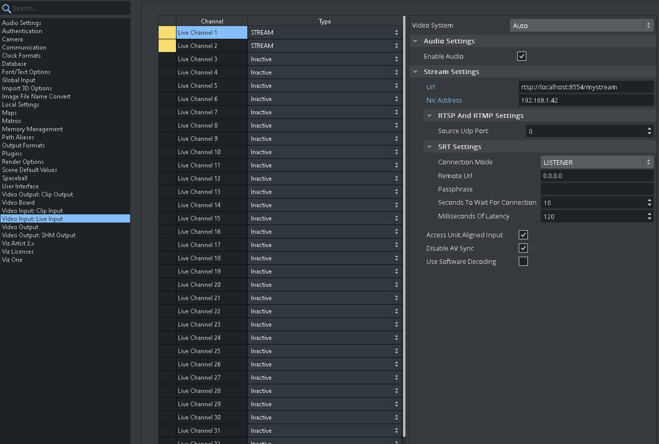

Configuring a Stream
A stream can now be configured using the GUI interface under Live Input:
The only thing that differentiates different type of streams are their URLs:
rtp://localhost:22404udp://localhost:22200?pkt_size=1316srt://localhost:2345rtsp://localhost:8554/mystreamrtmp://localhost:30000/live/1The best way to test the functionality of a stream is by using ffmpeg. ffmpeg supports the sending of simple pattern that allows us to do basic sanity test.
