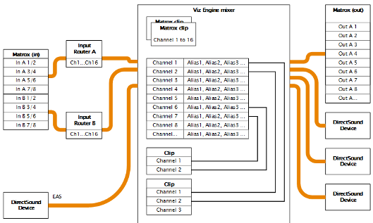

Viz Engine handles up to 16 audio channels for both input and output. This corresponds to the maximum number of embedded audio channels on an HD-SDI video source. Every channel can be given one or more user-defined aliases.
Matrox Input Channels
If using Matrox video hardware, the 16 input channels are available as AES/EBU input or embedded audio.
Output Channels
After mixing, the Viz Engine writes the audio data to the available output devices.
Matrox Routing
Matrox Live Input Routing
On Matrox cards, it is possible to route live input channels to any internal Viz Engine output channel. Several channels can be routed to a single internal channel, but it is not possible to duplicate input channels.
Matrox Clip Routing
Audio from Matrox clips are mapped one by one to the internal Viz Engine channels; hence, no routing is possible. Audio from audio clips played through the stage is routed to the internal audio channel. This can be done automatic or manually.

Viz Engine is able to use any DirectSound capable dual-channel audio card installed in the system.
If a Matrox board is installed on the system, Viz Engine synchronizes the audio output of the DirectSound cards to the video sync signal coming in to the video card.
