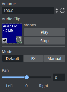

Add the Audio Plug-in.
Open the Audio plug-in editor.
Add an audio clip to the Test Clip drop-zone.
Click Play.
