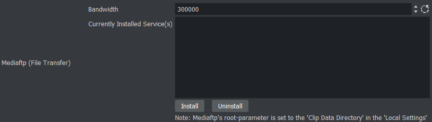

In the Days to keep log files field, set the number of days log files are to be kept (default is seven days).

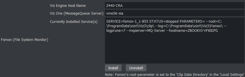

Fsmon (service only):
Enter the host name of the localhost.
Enter the host name of the Viz One Message Queue Server.
IMPORTANT! The localhost name must be exactly the same string that was entered in the Viz One as host name for the Viz Engine (it must be the exact same string as seen beside Host on the Servers page).
MediaFTP (service only): Set the transfer bandwidth (Kbits per second), as required.
Note: Mediaftp is installed with the -a flag. This assumes that the default Viz One user/password combination is: vtrsync/vtrsync. Mediaftp installs, but does not work, if the user/password combination is different (see Adding a Viz Engine in the Viz One Administrators Guide).
Click on Install for each required Service.
Note: Any currently installed Services must be removed before a new Service can be installed.

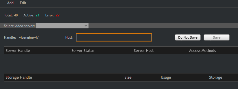

Login to Viz One Studio.
Switch to Administration.
Click on VideoServers.
Choose Add - VizEngine.
Enter the Viz Engine host name. Be aware that this is case sensitive.
Note the storage ID.
Click on Servers
Verify the Credentials for the FTP/ARDFTP access are correct.
Once configured correctly, Viz Engine must show up as Active in the Servers Dashboard.
