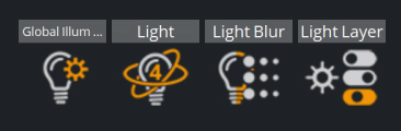

Light Layers

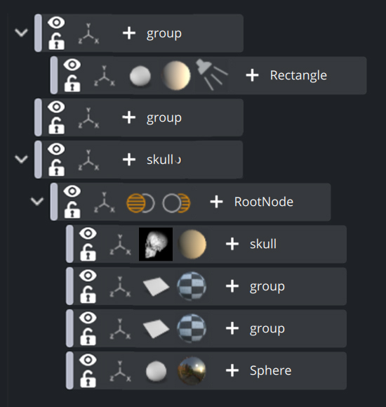

Every light has a light layer property, the Light Layer plug-in can be applied to a certain group of containers. The light with its corresponding bit-wise layer number is only applied to the light layer group.

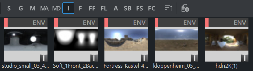

Image maps are imported as .exr files. Once you have imported these files, right click on them and select Prefilter Environment Map and save it as a new map. These maps are required for correct rendering and need to be applied in the Scene Settings Asset Placement. All pixels in the map are treated as light source. Environment Maps can consume quite a lot of memory inside your Graphic Hub.
Environment Maps in Graphic Hub are labeled with ENV:
Only pre-filtered Environment maps can be used, any other image will show a warning message.

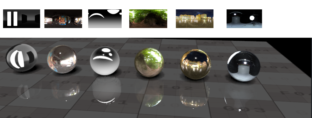

The environment can be rotated to bring lights into the correct position. In addition, the intensity can also be varied. The following illustrates some images with different environment maps applied:
Credits: Environment Maps taken from https://hdrihaven.com/

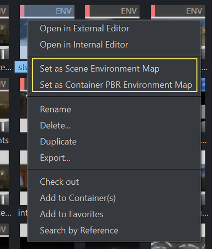

Tip: Environment Maps can be applied quickly to either the Scene or to Container(s) by using the context menu on Pre-Filtered Environment Maps:

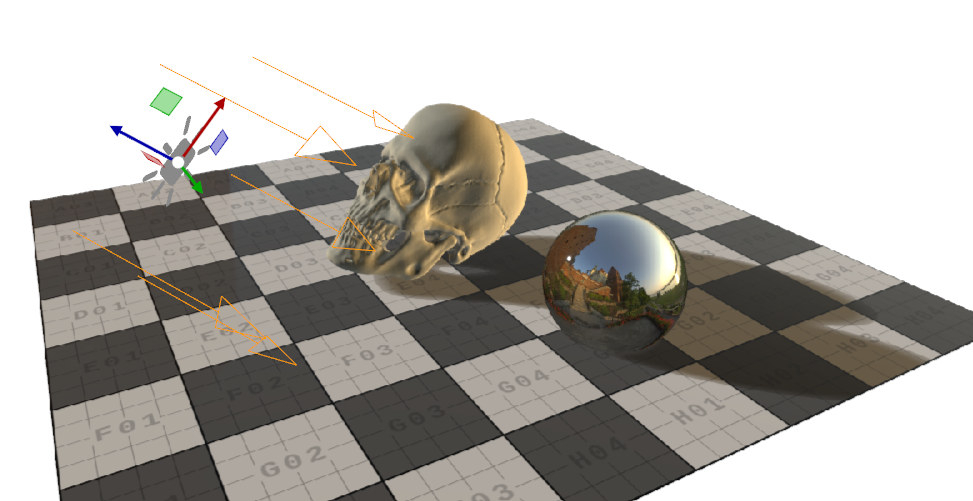

Directional Lights
Directional lights (also known as Distant lights) are lights that shine into a parallel direction. All rays are present everywhere in your scene as there is no falloff: The intensity stays the same. In nature, real directional lights do not exist, in computer graphics they are mainly used to simulate strong light sources far away emitting all objects. A good reference example would be the sun. That's why you would usually only have one distant light in your scene, responsible for a global, scene-wide light.
Directional lights are only controlled by an object's container rotation, position or scaling do not have any influence. They have a specular and a diffuse intensity.

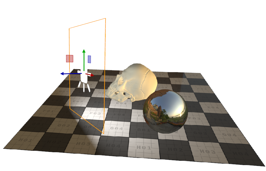

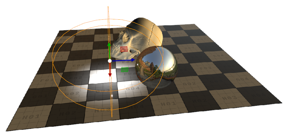

An area light is defined by a square area and sends out light equally into the square's main direction without any falloff. They can be used to simulate flat light panels or rays from a portal light. Area lights are the only lights that do not emit any specular light, nor do they cast shadows!
They are defined by their position, rotation and scaling of the container's transformation.

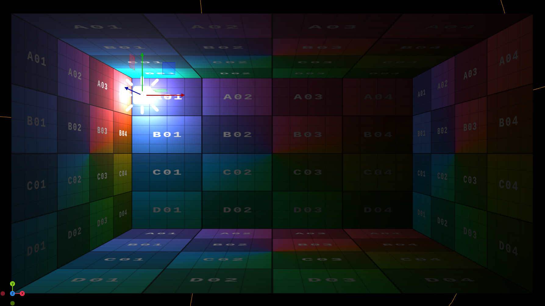

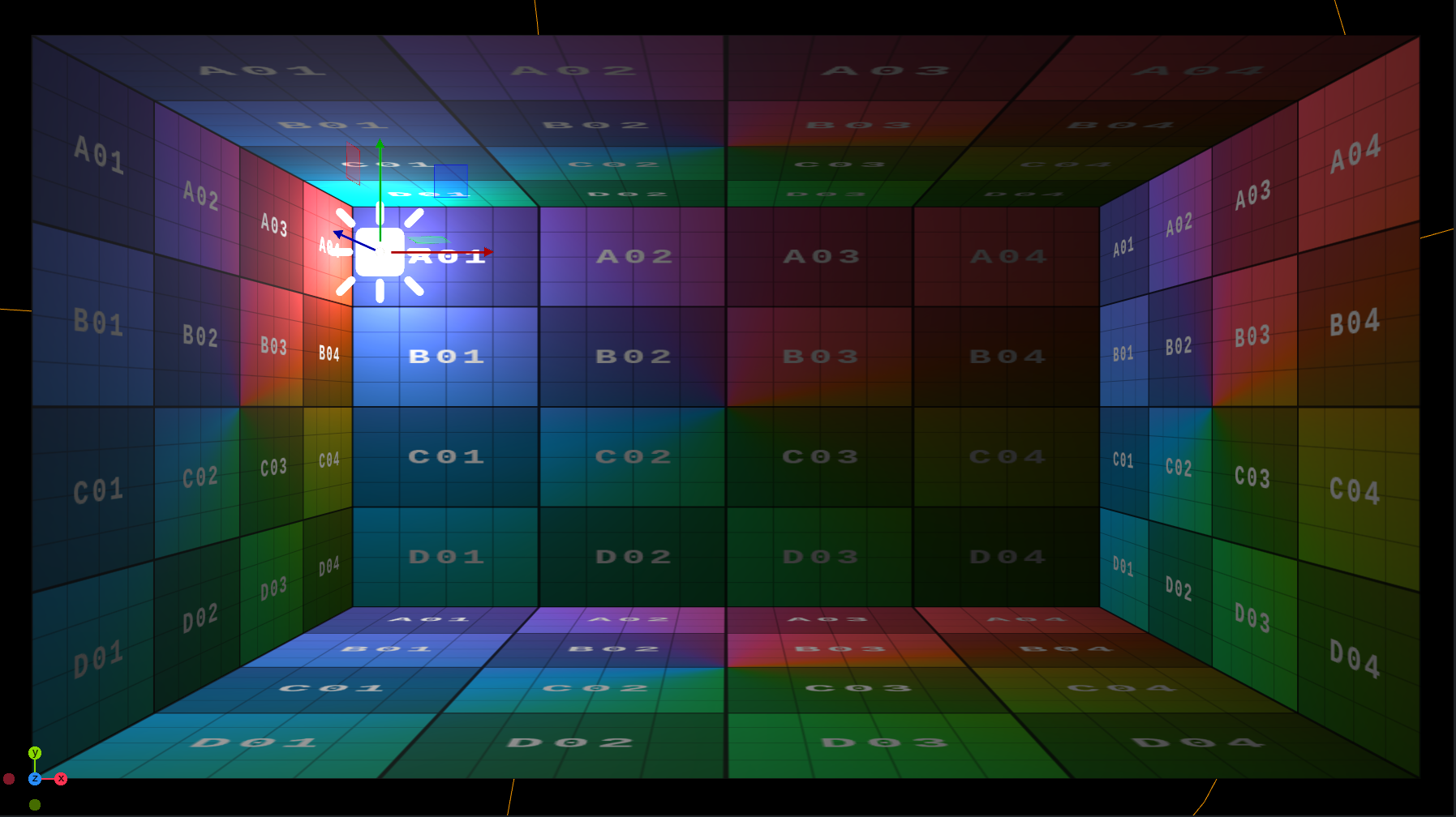

Light emitted from a single point, into all directions. The typical usage for point lights is for example a classical light bulb.
In comparison to the directional light, they have a falloff and are not influenced by any direction. The light casts equally into all directions, but the position is important; while for directional lights, the position doesn't matter.

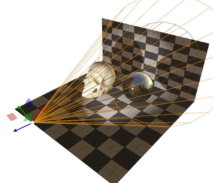

Spot Lights
Spot lights project light rays onto a geometry using a cone of light. They are very similar to point lights, except that instead of emitting into all directions, they are restricted to a cone. Spot Lights can be used, for example as a flashlight of a lighthouse.
Information: Be careful when using spotlights and shadows! The cascading shadows need to be calculated six times per light, shadows on spotlights decrease your performance.

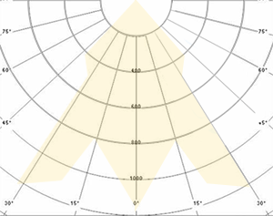

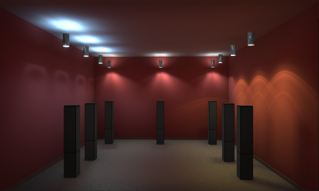

Working with IES Files
Viz Engine supports IES files, which stands for Illuminating Engineering Society. IES files describe how a real light is being distributed from a Light Source. By using an IES profile, the the distribution of light emitted from shapes a more realistic light fixture. Many vendors supply a IES profile for their lights.
Basic Light
Light with IES profile

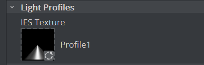

Import .ies files as images to Graphic Hub. Viz Engine creates a preview for the image based on the profile information contained in the IES file:
Apply the IES profile to the light by dragging it onto the Light Profile setting in Point or Spot lights:
Using IES light profiles adds more realistic lighting to your scenes:

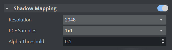

The sequences' shadow mapping panel supports multiple configurations, which are scene global options for the shadow rendering:
  • Enable: Turns shadow mapping on and off for the scene.
  • Resolution: Sets resolution of a single shadow mapping texture.
  • PCF Samples: Determines the number of samples used for softer shadows. The higher the softer the shadow, but the higher the performance impact.
  • Alpha Threshold: Sets the threshold for alpha masked shadows, when the alpha is lower than the given threshold, a pixel is discarded.

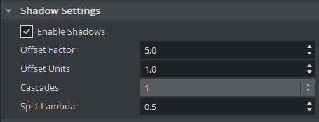

Each light has additional options that influence the way the shadow textures are being generated:
  • Enable Shadows: Enables shadow casting of this light.
  • Offset Factor / Units: Influences the way depth values of a shadow map are being written. Higher values help reducing shadow acne.
  • Cascades: Sets number of textures this light uses for shadow mapping.
  • Split Lambda: Influences the way the frustum splits are calculated. It's a factor to blend between logarithmic and uniform distribution of the splits.

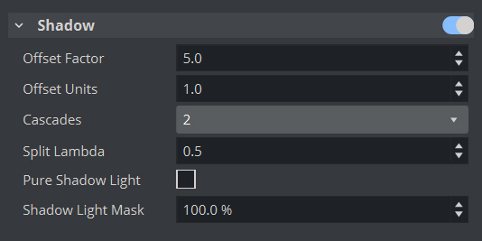

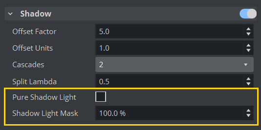

Shadow Lights
Although a contradiction, lights can also be turned into shadow lights. This represents a light source that emits no light, but still casts a shadow while the casted shadow is emphasized so there is no illumination on it.
There are two degrees of controlling a shadow light: A pure shadow light or only emphasizing the casted shadow.
Two new parameters in the light plug-in are introduced.
  • Pure Shadow Light: If turned on, the light source becomes a pure shadow light source that only casts shadows but does not illuminates (implying shadow light mask = 0%).
  • Shadow Light Mask: Determines how much light from other sources illuminates the shadow area. The light still illuminates other area as normal. The shadow can still be illuminated by other lights if the shadow itself is transparent (Castor's Alpha < 100%).

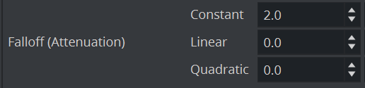

Advanced Light Falloff (Attenuation)
Viz Engine 5.4 introduces an alternative falloff option for Point- and Spotlights. It offers the (most common) options:
  • Quadratic (Q): Quadratic light falloff, leaving strength unmodified if smooth is set to 0.0 and corresponds to reality.
  • Linear (L): Linear light falloff, giving a slower decrease in intensity over distance.
  • Constant (C): Constant light falloff, where the distance to the light has no influence on its intensity.
The constant-linear-quadratic falloff model can be mixed together.

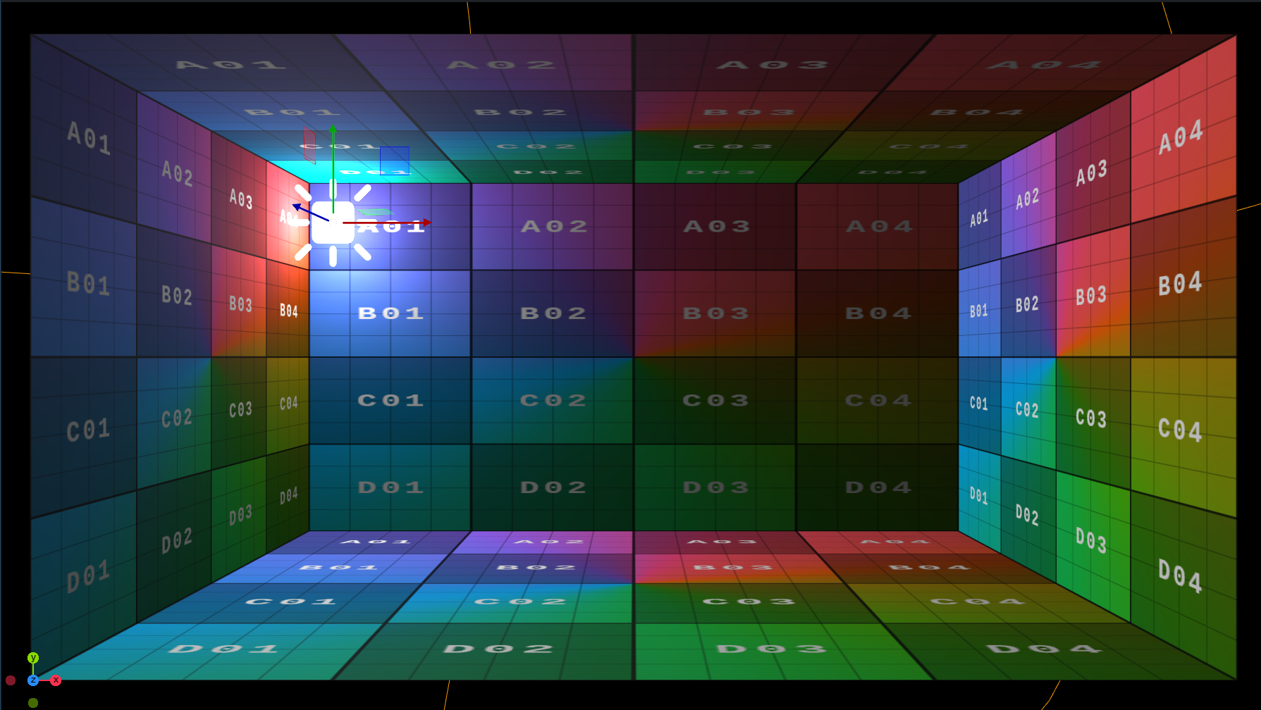

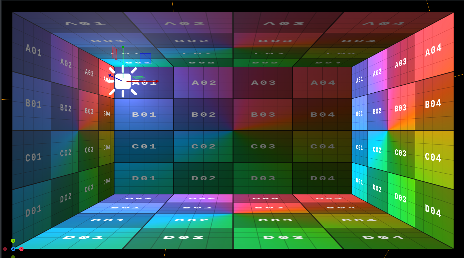

Constant Falloff 100
Linear Falloff 100
Quadratic Falloff 100
Constant Falloff 35
Linear Falloff 35
Quadratic Falloff 35
