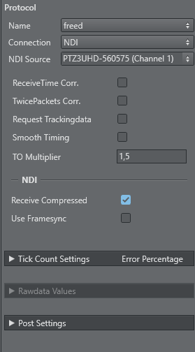

After adding a new tracking driver to the "Tracking Systems" panel a click on the tracker opens the property view.

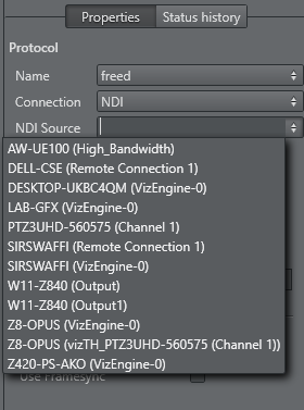

When NDI is selected in Connection, a combo box appears where the NDI source can be selected.
There are two NDI options available:
Receive Compressed: The incoming NDI stream is not decoded by Tracking Hub. Only the metadata is read and analyzed, minimizing GPU and CPU usage. This option enabled by default.
Use Framesync: The NDI Library tries to harmonize the timing of incoming and outgoing frames when activated. This is not needed for the NDI tracker and Tracking Hub to send out a new frame, when one frame is coming in without waiting. It is not needed for the PTZ3 camera model but could be needed for future camera models. This option is not recommended. By default it is switched off.
After connecting the tracking system the driver should become green and the status is running. Green means that Tracking Hub was able to find the tracking data in the metadata of the video and was able to decode it.
If no data is present in the NDI stream, Tracking Hub shows Error, No incoming Data!.

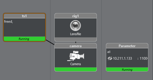

After connecting the parameters to the Rig structure the setup looks like this:
