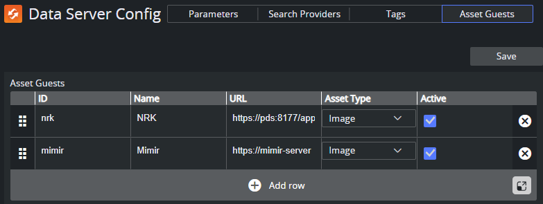

Configuration
This section describes how Asset Guests are configured to appear in Template Builder and Viz Pilot Edge.
Asset Guests are registered in Data Server Config, where each guest editor is defined and made available to the system.
  • Open Data Server Config.
  • Navigate to the Asset Guests section.
  • Add one row for each Asset Guest you want to register.
    • ID: A unique identifier used by Viz Pilot Edge to associate assets with a specific guest editor. The value can be any unique string, but must remain stable once the assets are created using this guest.
    • Name: The display name of the Asset Guest. This name appears in the search and selection UI when users choose an editor.
    • URL: The full URL of the Asset Guest UI. Viz Pilot Edge loads this URL inside an <iframe> when the guest editor is opened.
    • Asset Type: The type of assets this asset guest provides, which can be an image or video.
    • Active: Controls whether the Asset Guest is available in Viz Pilot Edge. When disabled, the guest is not shown in the UI.
  • Click Save.
