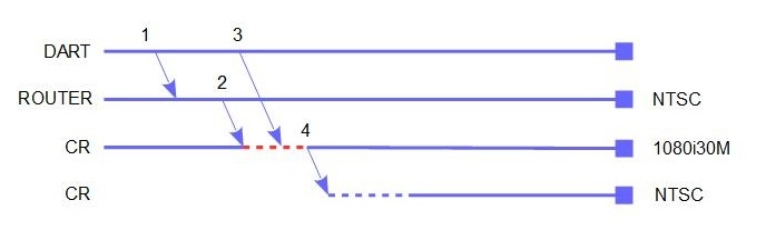

When operating Viz Dart with Channel Recorder, the timing between the different components is important. Take the following example:
The typical operation when using Viz Dart is as follows:
  1. Dart sends a command to the router to route an NTSC signal to Channel Recorder.
  2. The router sends the NTSC signal to Channel Recorder.
  3. Channel Recorder was configured as 1080i30M, so it triggers a configurable timeout (dotted red line).
    1. By default, this timeout is three seconds duration and can be configured (restarting_delay).
    2. After the timeout, Channel Recorder restarts with NTSC signal resolution.
    3. If the same signal as configured (1080i30M) is received again within those three seconds, the restart is cancelled.
  4. During the restart (dotted blue line) it is possible that Dart sends the MVCP commands to schedule a recording. If this happens, Channel Recorder queues the commands until it is ready with the new resolution.
