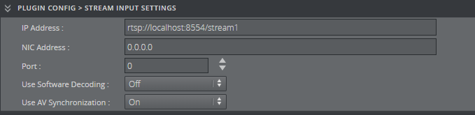

  • Stream Input Settings
    • IP Address: Indicates the source IP address.
    • NIC Address: Indicates which NIC is used for receiving the stream.
    • Port: Indicates the source port.
    • Use Software Decoding: Chooses between using the hardware or software decoder.
    • Use AV Synchronization: Enables audio and video synchronization of both are present. If only video is present this option must be disabled.

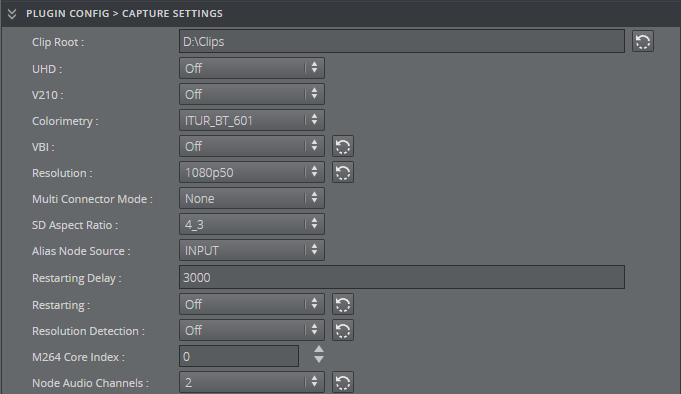

  • Capture Settings
    • Clip Root: Sets the default folder for the recordings. The default value is D:\\cr_clip.
    • UHD: Enables detection of UHDTV signals. When set to On, Channel Recorder scans the signal resolution on the four corresponding input connectors. If four 3G signals are detected, they are interpreted as one UHDTV signal. When set to Off, the four connectors are treated as separate 3G signals. The default value is Off.
    • V210: Uses the 10-bit surface format V210. This is needed to record XAVC, it increases performance when for example recording ProRes.
    • Colorimetry: Specifies the colorimetry to be used to be able to record in HDR. By default ITUR_BT_601 is used for SD resolution and ITUR_BT_709 for HD and UHD resolution.
    • VBI: Enables VBI recording. To capture closed caption this value must be set to On. The default value is On.
    • Resolution: Sets the default resolution. The possible values are: NTSC, PAL, 720p50, 720p60M, 1080i25, 1080p60, 1080i30M, 1080i30, 1080p50, 1080p60M and 1080p60. The default value is NTSC.
    • Multi Connector Mode: Allows switching between 12G and different quad-link settings for UHD inputs. Only supported for Xmio5 12G SDI.
    • SD Aspect Ratio: Specifies the aspect ratio for SD resolution.
    • Alias Node Source: Specifies the source of the alias node which specify from which output or input connector the application records.
    • Restarting Delay: Specifies the time in milliseconds before the channel is restarted after detecting a change in resolution.
    • Restarting: Enables or disables restarting after detecting a change in resolution.
    • Resolution Detection: Enables or disables resolution detection.
    • M264 Core Index: Chooses which M264 core to use when the hardware is available.
    • Node Audio Channels: Number of audio channels for Matrox input node. This is relevant for IP workflow. This must match the number of audio channels of the audio output flow.

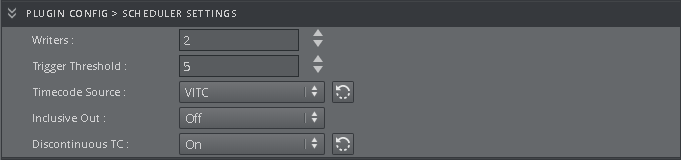

  • Scheduler Settings
    • Writers: Sets the number of writers to initialize. This value is only relevant in loop and scheduled recordings in which consecutive recordings are very close to each other within the timeline (less than six seconds). The default value is 2 and should never be below 2.
    • Trigger Threshold: Determines whether to execute a timed command late if it misses the execution time. If the time is still within the trigger threshold, it is executed late. Outside of this window, the command is ignored until the next time the timecode is received. The value can either be a number of frames or a timecode-based relative value. The default value is 5.
    • Timecode Source: Specifies the timecode source. The default value is TIME_OF_DAY.
    • Inclusive Out: When enabled the last timecode written to the file is the defined out point of the recording.
    • Discontinuous TC: When enabled each field/frame uses the timecode calculated from the system time in case of TIME_OF_DAY and VITC/LTC embedded in the fields/frames if this is chosen as timecode source. This option is useful to support DST (Daylight Saving Time) or when the input's timecode is expected to have gaps and this must be kept in the recorded file. StartTC will not work when this is enabled.

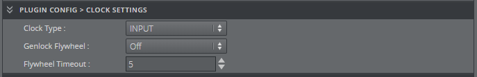

  • Clock Settings
    • Clock Type: Defines what type of clock is used for recording. The possible values are: GENLOCK and INPUT. The default value is INPUT.
    • Genlock Flywheel: Uses the flywheel in case the genlock signal is lost if Clock Type is GENLOCK.
    • Flywheel Timeout: Sets the timeout of the genlock flywheel in seconds. This defines the time until the genlock switches to free run, as well as the maximum time the flywheel can use to resynchronize. The default value is 5.0.
Tip: When recording without a signal, GENLOCK clock type is recommended due to the drift that INPUT clock type can cause. INPUT clock type is generally the better choice when a signal is present all the time while recording.

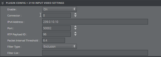

  • 2110 Input General Settings
    • Redundancy: Enables redundancy if true.
    • Join Type: Indicates the type of membership request made when IPv4 address is a multicast address.
  • 2110 Input Video Settings
    • Enable: Enables video flow when set to True.
    • Connector: Specifies the video input connector to be used for recording. If set to 0, the connector defined in Video Input Settings is used instead.
    • IPv4 Address: Sets destination IPv4 address.
    • Port: Sets destination port.
    • RTP Payload ID: Indicates the RTP (Real-time Transfer Protocol) Payload ID to capture. Used when RTP Payload ID is set to True.
    • Packet Interval Threshold: Indicates the threshold for generating the time interval between the IP packets alarm on the main IP stream. For video, the range is from 6.4 nanoseconds to 419424.0 nanoseconds, in intervals of 6.4 nanoseconds.
    • Filter Type: Specifies the type of filtering applied to the source list when IGMPv3 is used.
    • Filter List: Lists IPv4 addresses to be included or excluded, separated by a space character.

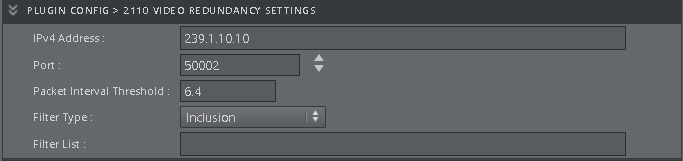

  • 2110 Input Video Redundancy Settings

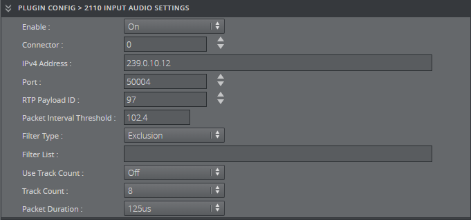

  • 2110 Input Audio Settings
    • Enable: Enables audio flow when set to True.
    • Connector: Specifies the audio input connector to be used for recording. If set to 0, the connector defined in Video Input Settings is used instead.
    • Packet Interval Threshold: Indicates the threshold for generating the time interval between the IP packets alarm on the main IP stream. For audio, the range is from 102.4 nanoseconds to 6710681.6 nanoseconds in intervals of 102.4 nanoseconds.
    • Filter List: Lists IPv4 addresses to be included or excluded separated by a space character.
    • Use Track Count: Uses track count to specify the number of tracks for the incoming IP stream when set to True.
    • Track Count: Specifies the number of tracks for the incoming IP stream.
    • Packet Duration: Indicates the duration of the incoming audio packet. The packet size (in samples) can be computed using the sample rate (48000 samples/sec) and the packet duration.

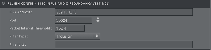

  • 2110 Input Audio Redundancy Settings

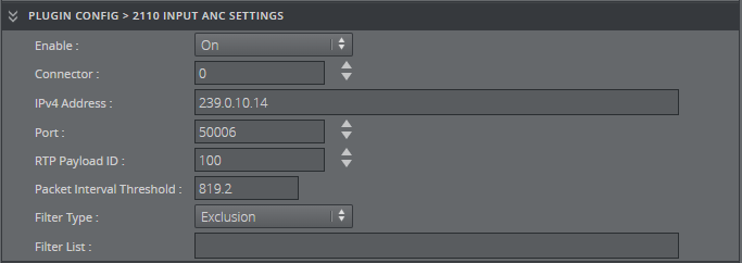

  • 2110 Input ANC Settings
    • Enable: Enables ANC flow when set to True.
    • Connector: Specifies the anc input connector to be used for recording. If set to 0, the connector defined in Video Input Settings is used instead.
    • Packet Interval Threshold: Indicates the threshold for generating the time interval between the IP packets alarm on the main IP stream. For ancillary data, the range is from 819.2 nanoseconds to 53685452.8 nanoseconds in intervals of 819.2 nanoseconds.

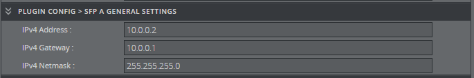

  • SFP A / B / C / D General Settings
    • IPv4 Address: Sets IPv4 address.
    • IPv4 Gateway: Sets IPv4 gateway.
    • IPv4 Netmask: Sets IPv4 netmask.

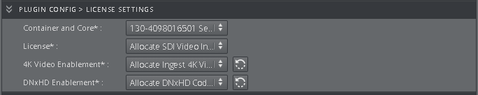

  • License Settings
    • Container and Core: Defines container and core license string.
    • License: Defines the license type. If the use does not have SDI IN (max). Demo option can be used, however the recordings will have 100 black frames every 400 frames.
    • 4K Video Enablement: Enables 4K video license fetching. If none is found, the user is not able to start Channel Recorder. If already recording and the license is not accessible or expired, the user will have 100 black frames every 400 frames.
    • DNxHD Enablement: Enables DNxHD license fetching. If none is found, the user is not able to start Channel Recorder. If already recording and the license is not accessible or expired, the user will have 100 black frames every 400 frames.
