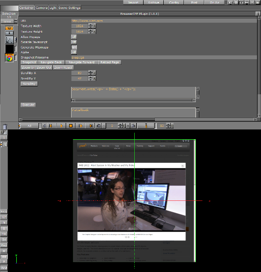

Browser Properties
URL: Determines the URL address to be opened.
Texture Width: Determines the width in pixels of the browser window.
Texture Height: Determines the height in pixels of the browser window.
Allow Popups: Allows the browser to render popup windows. The popup renders into the current texture. Close the popup by navigating back.
Disable JavaScript: Disables JavaScript execution.
Note: Vector animations like Lottie require JavaScript to run.
Generate Mipmaps: Generates all mipmap levels. Set to
Offfor more performance. Set toOnfor more quality when the texture is rendered on a smaller area on the screen than the width/height of the browser itself.Alpha: Enables a transparent browser window.
Note: For the Viz Engine Renderer, Material Definitions' Rendering Method has to be set to Transparent for Alpha to work correctly.
Snapshot Filename: Saves a snapshot at the location (full path) entered here. The location can be either a local file or on the Graphic Hub and must be specified as a Uniform Resource Identifier (URI), for example:
File: file:///c:/temp/Browser/example.png
Graphic Hub: vizgh:///Browser/example.png
Graphic Hub UUID: vizgh:///<F3F3F087-B85A-4AEE-B5019F78CB6AE5EC>/example.png
Snapshot: Takes a snapshot of the current browser texture. The snapshot is saved as a file or to the Graphic Hub, as specified in Snapshot Filename.

To Create a Simple Scene with Browser
Add a new Container to the Scene tree.
Add a Rectangle geometry to the Container
Add the Browser plug-in.
Open the Browser properties and enter a valid URL.
Click on(enable the handling of interactive script/plug-in events (Scene Editor)).
Use the mouse or controls to navigate the website.

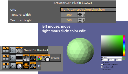

Example HTML Document
Entered in URL: file:///C:/test/colorpicker.htm (see Browser Properties):
<script type="text/javascript">function colorAnim() { window.vizrt.colorAnim() } function objectmove(x, y) { PositionX.value = x; PositionY.value = y; }</script> <!DOCTYPE html> <html lang="en"> <head> <title id='Description'>The jqxColorPicker widget allows you to easily pick a color.</title> <link rel="stylesheet" href="http://www.jqwidgets.com/jquery-widgets-demo/jqwidgets/styles/jqx.base.css" type="text/css" /> <script type="text/javascript" src="http://www.jqwidgets.com/jquery-widgets-demo/scripts/jquery-1.11.1.min.js"></script> <script type="text/javascript" src="http://www.jqwidgets.com/jquery-widgets-demo/scripts/demos.js"></script> <script type="text/javascript" src="http://www.jqwidgets.com/jquery-widgets-demo/jqwidgets/jqxcore.js"></script> <script type="text/javascript" src="http://www.jqwidgets.com/jquery-widgets-demo/jqwidgets/jqxcolorpicker.js"></script> <script type="text/javascript" src="http://www.jqwidgets.com/jquery-widgets-demo/jqwidgets/jqxradiobutton.js"></script> </head> <body class='default'> <div id='content'> <script type="text/javascript"> $(document).ready(function () { // Create jqxColorPicker widgets. $("#jqxColorPicker").jqxColorPicker({ width: '250', height: '250'}); $("#hueMode").jqxRadioButton({ width: '150', height: '25'}); $("#saturationMode").jqxRadioButton({ checked: true, width: '180', height: '25'}); $("#hueMode").on('change', function (event) { if (event.args.checked) { $("#jqxColorPicker").jqxColorPicker({ colorMode: 'hue' }); } else { $("#jqxColorPicker").jqxColorPicker({ colorMode: 'saturation' }); } }); $("#jqxColorPicker").on('colorchange', function (event) { //console.log(event.args.color.r); window.vizrt.colorChange(event.args.color.r + " " + event.args.color.g + " " + event.args.color.b); $("#colorlog").html("<div>Color: #" + event.args.color.hex + "</div>"); }); }); </script> <div id='jqxWidget'> <div id="jqxColorPicker"></div> <div style="font-size: 13px; font-family: verdana; margin-top: 10px;"> <div style="margin-bottom: 5px;">Color Modes</div> <div id="saturationMode">Saturation Color Mode</div> <div id="hueMode">Hue Color Mode</div> </div> <div style="font-family: Verdana; font-size:13px;" id="colorlog"></div> </div> </div> </body> </html>Browser Status Notifications
