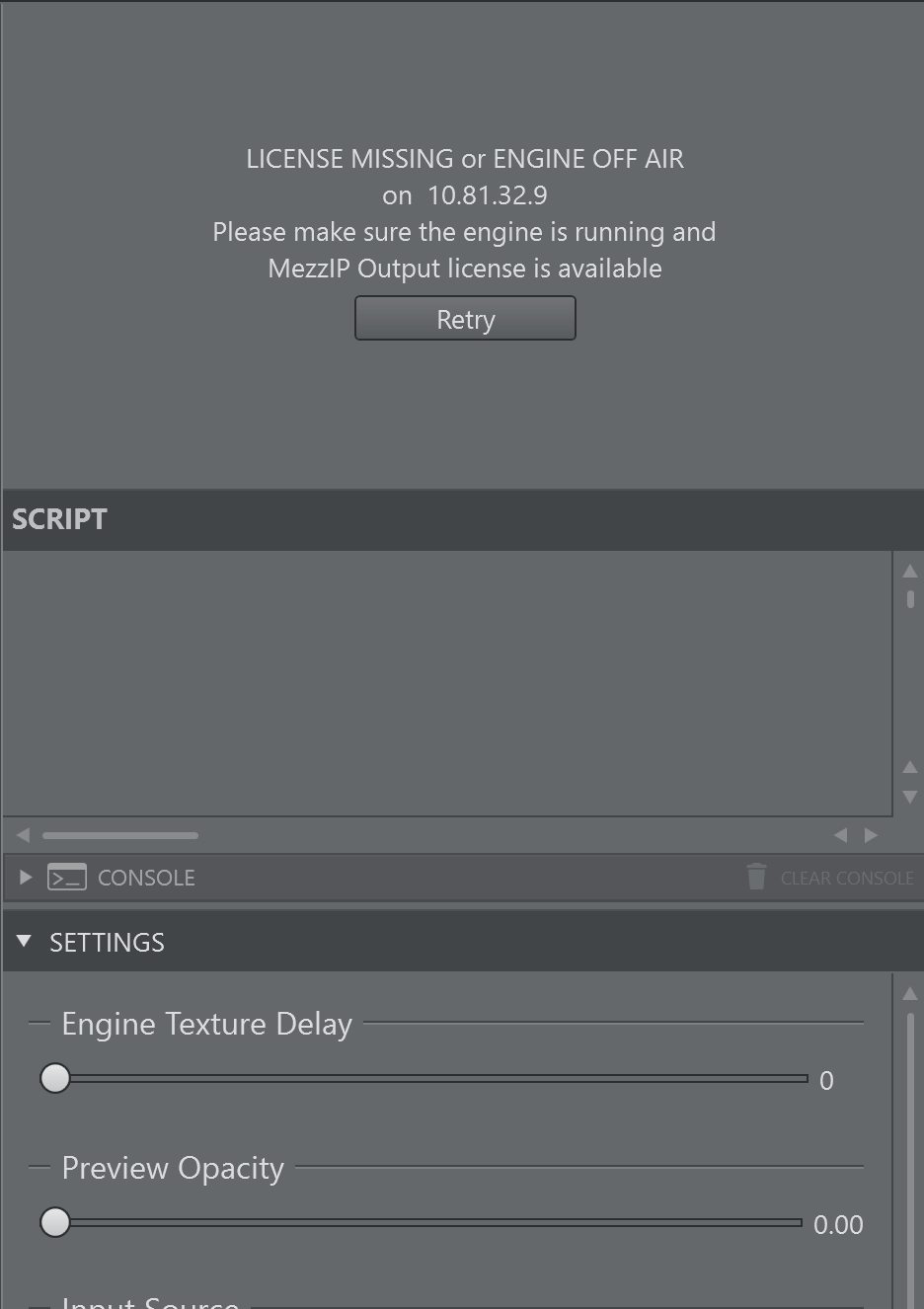

  • Make sure you have the Object Tracker license on the Viz Engine where the Object Tracker is running.
In case the license is missing or Viz Engine is offline, an error message appears as shown above.
