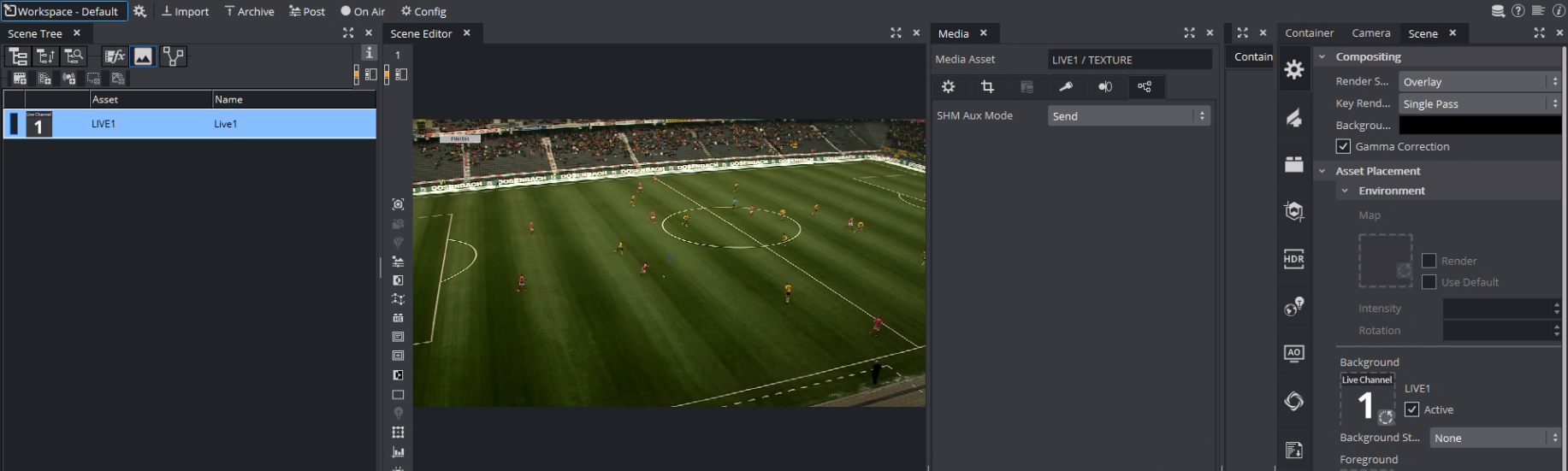

Live Video Input
The most important setting of a scene that can be used with the Object Tracker is the live input. The SHM Aux Mode must be set to Send. This allows the Object Tracker to read the input surface from the Engine. The Live Input asset needs to be present in the scene but does not necessarily need to be visible, so the result can be still composed on an external mixer.
It is possible to use other texture source such as clip channels. You need to make sure that the SHM Aux Mode is set to Send and that the configured Input Key (see Configuration > Tracking in the Viz Arc User Guide) matches the SHMAuxKey configuration of the Object Tracker's Viz Engine (for example, viz_clip1_aux, viz_live1_aux, etc.).

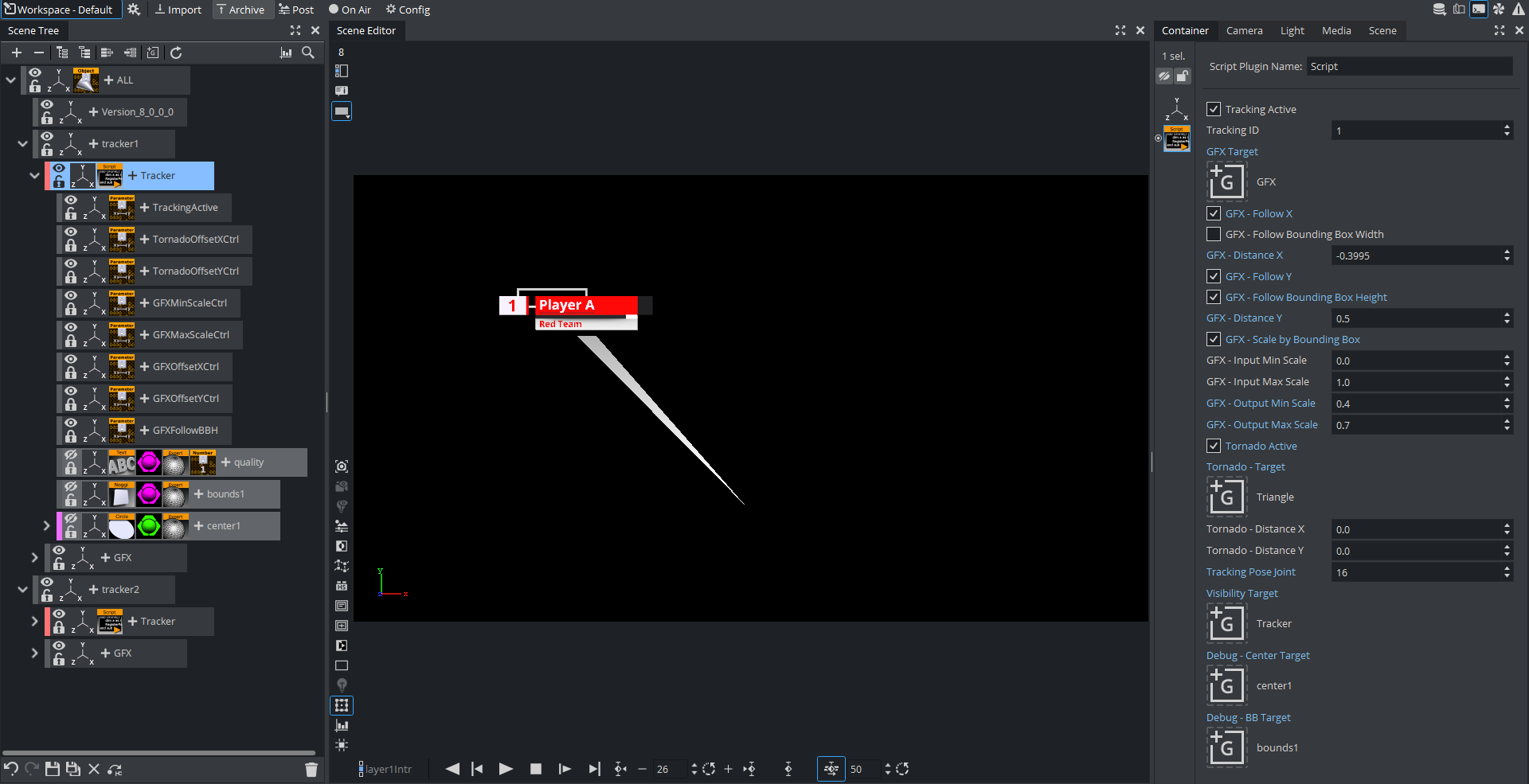

In a first step, the script calculates in the OnInit method the available width and height of the viewport on the zero Z plane. In the OnExecPerField method, the tracking data is read out using a given shared memory keys.

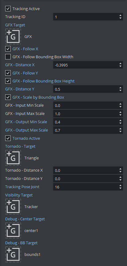

The TrackingID parameter selects the tracked point to follow in the tracking points data structures (it represents also the Tracked Object Input ID in the Viz Arc interface).
The script uses the GFX Target (that represents the tracked point), it is used very much like the Autofollow plug-in. Additionally it uses a few more parameters that determine an additional offset relative to the tracked object's bounding box.
  • GFX - Follow X: Allows the graphics follow the horizontal movement of the tracked object.
  • GFX - Follow Bounding Box Width: Positions the graphics on the right hand side of the bounding box.
  • GFX - Distance X: Adds constant horizontal offset.
  • GFX - Follow Y: Allows the graphics follow the vertical movement of the tracked object.
  • GFX - Follow Bounding Box Height: Aligns the graphics on top of the bounding box.
  • GFX - Distance Y: Adds constant vertical offset.
  • GFX - Scale by Bounding Box: Uses Bounding Box size to scale graphics.
  • GFX - Input Min Scale: Sets minimum input scale of the Bounding Box height. The input height is normalized between 0 and 1 (where 1 is the full screen height, 0.1 is 10% of the screen height etc.).
  • GFX - Input Max Scale: Sets maximum input scale of the Bounding Box height. The input height is normalized between 0 and 1 (where 1 is the full screen height, 0.1 is 10% of the screen height etc.).
  • GFX - Output Min Scale: Maps minimum output scale of the graphics.
  • GFX - Output Max Scale: Maps maximum output scale of the graphics.
Using the above sample values, a bounding box with height of 0.05 or smaller (thus 5% of the screen height or smaller) results in a scaling of 0.4 (Output Min Scale). A bounding box of height 0.2 or larger (20% or larger of the screen height) is scaled to 0.7.
All values in between 0.05 and 0.2 are interpolated linearly between 0.4 and 0.7. Adjust those values to suit your graphics. The sample in this script considers only the height of the bounding box, but it could be easily changed to consider the surface of the bounding box or the width only.
The checkbox Tornado Active enables both the visualization and the evaluation of the position of the Tornado - Target.
It can be customized through:
  • Tornado - Distance X: The horizontal offset from the tracked point.
  • Tornado - Distance Y: The vertical offset from the tracked point.
The Tracking Pose Joint selects the landmark to be used as tracked point.
The script then switches on and off the target container defined in the Visibility Target parameter when tracking begins and tracking ends or is lost. This can be also replaced with a stage command for example.
The parameter container Debug - Center Target is updated on every field to the "check" the actual tracking position.
Parent Transformations: The script above does not consider any parent transformations of the target container. Make sure the target container contains no additional parent transformations.
The Debug - BB Target container parameter (which might contain a Noggi or Rectangle plug-in) gets resized according to the tracked width and height of the object.
Bounding Box Sizes: The bounding box sizes might become zero. This is always the case for simple and manual tracking.
