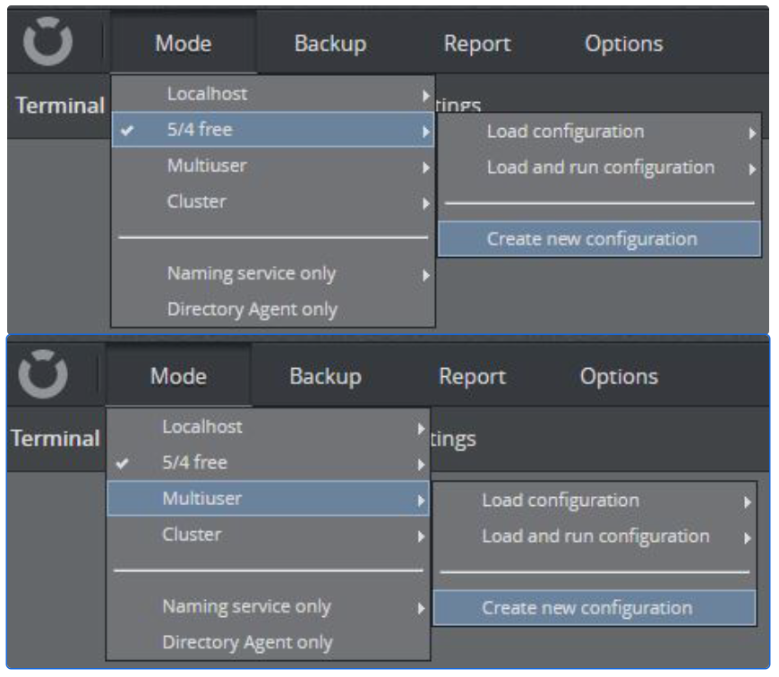

  1. From the Mode menu, select the desired configuration mode and click Create new configuration.
  2. Click the Configuration button.

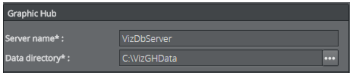

  3. Enter the Server name as it should be registered with the Naming Service. Click the reload button to reset to the default name, VizDbServer.
  4. Enter the Data directory path where the Graphic Hub should store the data elements:

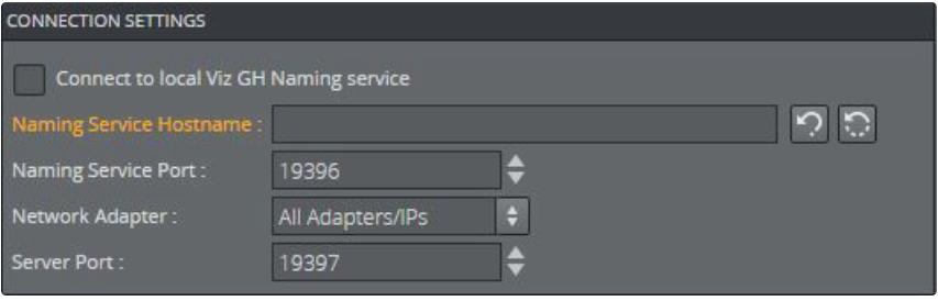

  5. Enter the parameters for a Naming Service:
    • In 5/4 Free and Multiuser modes, the Naming Service host name must be entered unless Connect to local Viz GH Naming service is checked. For Graphic Hubs in Localhost mode, this parameter cannot be changed.
    • Enter the Naming Service Port number. The default port is 19396.
  6. Uncheck the Connect to local GH Naming Service if only a server start is required.
  7. Select a Network Adapter if the system has more than one adapter installed, or choose to run the Graphic Hub on all adapters (default).
  8. Enter the Server Port number on which the Graphic Hub listens to. The default port is 19397.

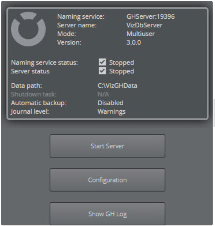

  9. Click Apply.

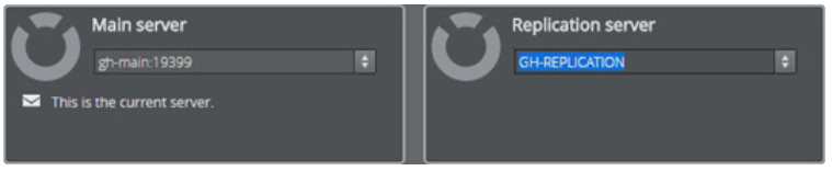

Cluster Configuration
  1. From the Mode menu, select Cluster and click Create new configuration.
  2. Select the Main and Replication server from the drop-down list.

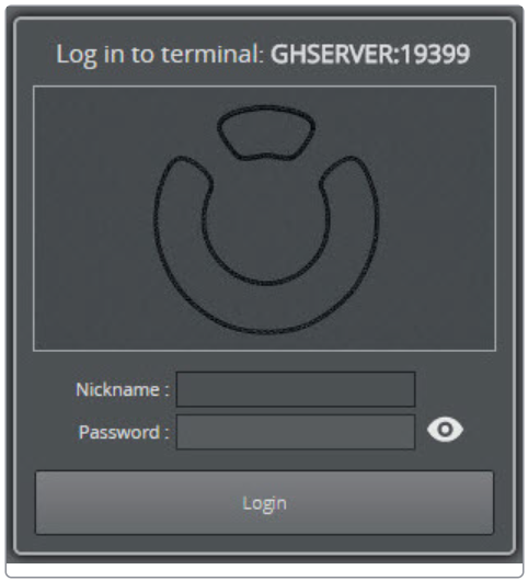

  3. If Graphic Hub Terminal HTTP authentication is enabled, log on to the servers:
Note: For consistency and to avoid potential resolution issues, it is recommended to use hostnames or FQDNs (properly resolvable via DNS) rather than IP addresses when configuring connections between Graphic Hub components (GH Terminal, GH REST, ImEx Agent, PDS, Clients), especially in cluster setups. While IP addresses may work, inconsistencies (mixing hostnames and IPs for the same system in different component configurations) can lead to unexpected behavior or connection problems. Ensure all components refer to the cluster nodes and related services using the same naming convention.
IMPORTANT! If HTTP authentication is enabled, it must be enabled on both servers, and the user name and password must be identical on both servers.

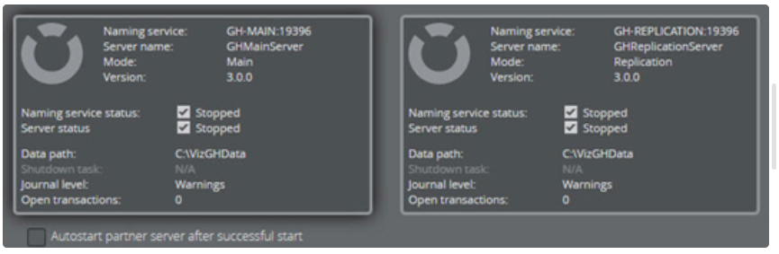

  1. Click Create. This enters a two-step process, where the Step 1 is setting the parameters for the Main server. Step 2 is setting the parameters for the Replication server.
    1. Set the parameters for the Main Server. The parameters are described in the Localhost, 5/4 Free, and Multiuser Configuration section. Click Next.
    2. Set the parameters for the Replication server.
  2. Click Finish to return to the System Status panel, which should show the status for both servers. The currently logged on to server is signified by it’s panel casting a shadow:

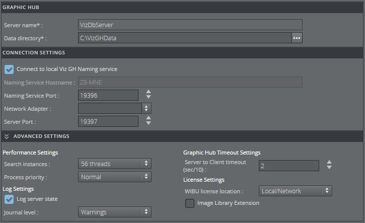

Graphic Hub Configuration Parameters
This section details the configuration parameters for running the Graphic Hub server in Localhost, 5/4 Free, Multiuser, and Cluster (Main and Replication) modes. The Graphic Hub configuration parameters can only be changed when the Graphic Hub server is not running. In the Graphic Hub Terminal, click the Configuration button in the System Status panel to open the configuration window (here for mode Multiuser):
Graphic Hub
  • Server Name: Sets the Graphic Hub server name.
  • Data Directory: Sets the path to the Graphic Hub data directory.
Connection Settings
  • Connect to local Viz GH Naming Service: Starts a Naming Service on the local machine when checked. When disabled, the Graphic Hub starts in server only mode when started. However, this is only available for servers running in 5/4 free or multiuser mode. In such a case, the hostname or IP address of a Naming Service server must be provided.
  • Naming Service Hostname: The host name or IP address of the server running the Naming Service to connect to. Can only be edited when not connecting to a local Naming Service.
IMPORTANT! Scheduled tasks do not trigger when the Graphic Hub and Naming Service are not running on the same host (Naming Service only mode)!
  • Naming Service Port: Sets the port the Naming Service uses to directly communicate with the other applications in the network. The default port is 19396.
  • Network Adapter: Selects which network adapter the Graphic Hub should use. For maximum performance, always choose the fastest network card available. Virtual connections tend to be the slowest. When the network adapter is restricted, any connecting Viz Artist client must connect to the IP address, not the host name.
  • Server Port: Sets the port the Graphic Hub server listens to. The default port is 19397.
Tip: Make sure that the selected port is not in use by any other applications.
Advanced Settings
In most cases, there is no need to change the advanced settings. Click the Advanced Settings title bar to open the Advanced settings panel.
  • Performance Settings
    • Search instances: Determines the number of search threads that are generated, limited by the number of CPUs. The number of threads available for the Graphic Hub to execute a search (the range is 1 to the number of CPU cores in the system). The default value corresponds to the number of CPU cores in the system. Applies only to Graphic Hub servers running in Multiuser, Main or Replication mode.
    • Process priority: Sets the Graphic Hub process priority level (Low, Below Normal, Normal, Above Normal, High, Realtime)
Caution: Increasing the process priority level may cause system instability.
  • Log Settings
    • Log server state: Enables logging of additional call information on the Graphic Hub when checked.
    • Journal level: Sets the system journal entry level. Available journal levels:
      • No Logging: Disables all logs.
      • All: Logs all the entries listed below.
      • Errors: Logs Fatal Errors, Replication Errors, and so on.
      • Warnings: Logs Errors and Warnings.
      • File news: Logs Errors, Warnings, and new file entries.
      • File updates: Logs Errors, Warnings, and updated file entries.
      • File deletes: Logs Errors, Warnings, and deleted file entries.
  • Graphic Hub Timeout Settings:
    • Server to Client timeout (sec/10): The recommended setting is 2.
License Settings
Note: Since Graphic Hub 3.7.0 the only available license system choice is WIBU and requires the CodeMeter Runtime to be installed, running and configured on all affected systems.
  • WIBU license location: Sets the WIBU license container location.
Note: Details regarding the types of containers are listed in the Local and Network descriptions below.
  • Local/Network: Prioritizes WIBU system licenses from a local license container. If no valid license is found locally, the system switches to a network container.
  • Network/Local: Prioritizes WIBU system licenses from a license server on the network. If no valid license is found on the network, the system switches to licenses to a local container.
  • Local: Sets a local license container as the license location. This container may be:
    • a file-based container on the local system,
    • or a WIBU dongle-based container connected/bound to the local system.
  • Network: Sets a network license container as the license location. The license servers search list can be configured in CodeMeter Runtime WebAdmin. This container may be:
    • a file-based container on a configured license server on the network,
    • or a WIBU dongle-based container connected/bound to the license server on the network.

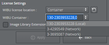

  • Container: Sets a dedicated container as the license location based on the container mask and serial.
    • When this option is selected the WIBU Container setting is shown:
    • The dropdown is pre-filled with automatically discovered container entries that contain a Graphic Hub Core license.
      • The WIBU container to use needs to be specified in the form "MASK-SERIAL,LOCATION" where mask and serial are positive integers and location is 0 for local and 1 for network.
    • When the container is empty a search in Local/Network is performed.
  • Image Library Extension: Allocates a Graphic Hub Image Library Extension license to enable this feature when checked.

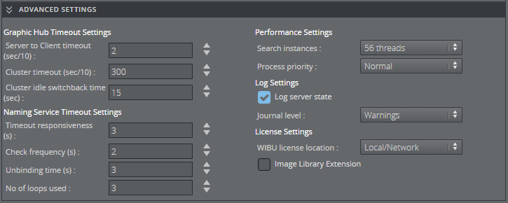

Additional Advanced Settings for Cluster Configurations
These settings apply to Main Server and Replication Server modes only.
    • Server to Client timeout (sec/10): The recommended setting is 2, which is 0.2 seconds.
    • Cluster timeout (sec/10): The recommended setting is 300, which is 30 seconds.
    • Cluster idle switchback time (sec): Defines how long the Graphic Hub waits for no activity from clients to return from a failover or switchback. The range is 1 to 30 seconds. The default value is 15 seconds.
  • Naming Service Timeout Settings
    • Timeout Responsiveness (s): Sets the timeout responsiveness. Must be 1 or greater.
    • Check frequency (s): Sets how often to check for unresponsive Naming Service servers.
    • Unbinding Time (s): Sets the delay after which unresponsive servers are unbound.
    • No. of Loops Used: Determines the number of loops for unresponsive server recognition. Must be 1 or greater.
    • Performance Settings: Sets the number of Search instances and the Process priority level, as described for Localhost, 5/4 Free and Multiuser above.

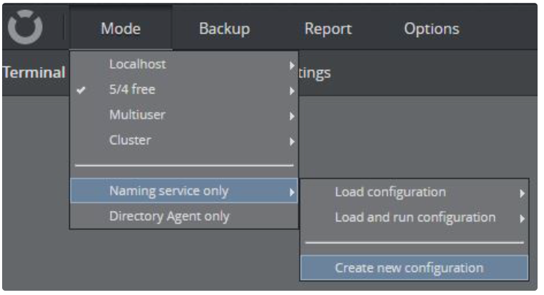

  1. Open the Graphic Hub Terminal.
  2. Go to Mode > GH Naming Service only > Create new configuration.

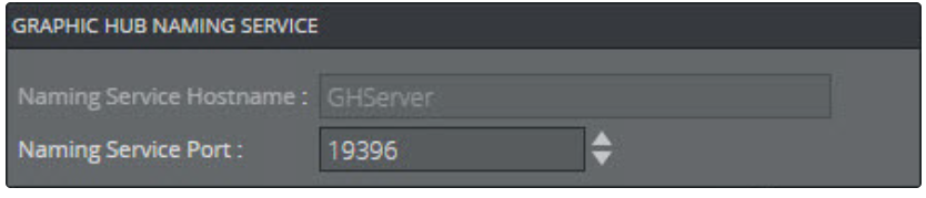

  3. In the Graphic Hub Naming Service configuration screen, Enter the port number for the Naming Service to communicate through. The default port number is 19396. The host name is the name of the local machine, and cannot be changed:

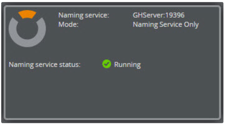

  4. Click Apply, then Start Naming Service when the Terminal has returned to the main page to start in Naming Service Only mode.
