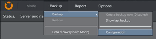

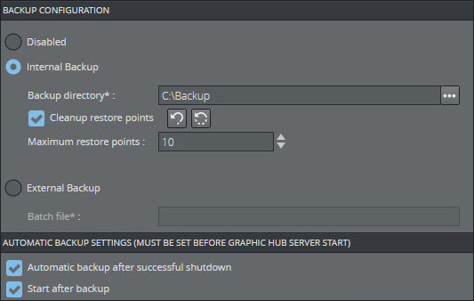

Go to Backup > Backup > Configuration to open the Backup configuration window:
Backup Configuration

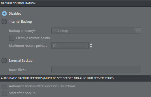

  • Disabled: Disables backup.
  • Internal Backup: Activates internal backup.
    • Backup Directory: Determines backup directory path. Only local drives are allowed as backup directory path.
    • Cleanup restore points: Enables limits to the number of stored restore points when checked. All restore points beyond the maximum are deleted. This can save considerable hard disk space.
    • Maximum restore points: Sets the maximum number of restore points.
  • External Backup: Activates external backup.
    • Batch file path: Sets the path to and name of the batch file to execute.
Note: As Graphic Hub Terminal runs as a service under the SYSTEM account, it cannot access network drives mapped by another user. Make sure that the destination path for the external backup is a local drive.
Automatic Backup Settings
This is used in combination with a shut down task to do periodic automated backups:
  • Automatic backup after successful shutdown: Performs automatic backup on server shutdown when checked.
  • Start after backup: Starts the server automatically upon completion of the automatic backup when checked.
Note: Start after backup is only applicable when shutting down the server through the Graphic Hub Manager or when the server is shut down by Scheduled Tasks.

  3. Go to Backup > Show Configuration.

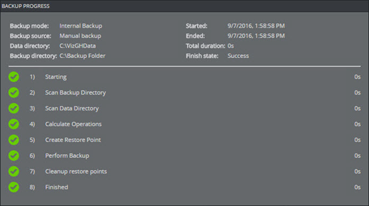

To Do an Internal Backup
  1. Shutdown the Graphic Hub server if it is running, in accordance with the Graphic Hub Shut Down procedure.
  2. Open the Graphic Hub Terminal.
  3. Select Backup > Create backup now.
  4. The backup is created in the directory specified in the backup configuration, as indicated by the Create backup now link.

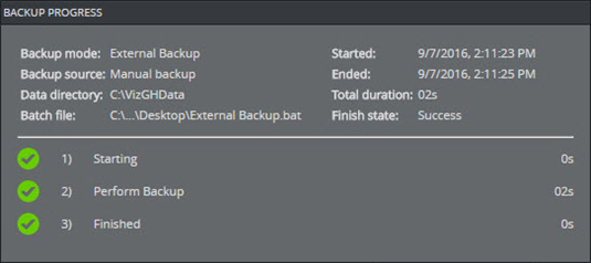

To Do an External Backup
  2. Make sure that the a batch file has been created and is available.
  3. Open the Graphic Hub Terminal.
  4. Select Backup > Create backup now (External Backup).

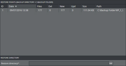

To open the Restore Points panel, open the Graphic Hub Terminal and select Restore from the Backup menu. The panel contains information about the restore points available according to the current backup configuration, such as the date and time the restore point was created, how many files it contains, and the location.
The Restore Points panel is accessible when the Graphic Hub is running. However, it is not possible to perform a restore task while the Graphic Hub is running.

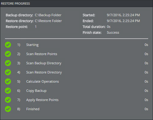

To Restore Backup Files
  2. In the Graphic Hub Terminal, go to Backup > Restore.

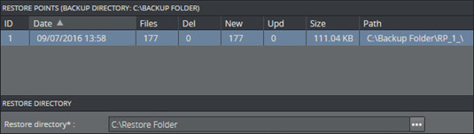

  3. Select which restore point to restore.
  4. In the Restore directory field, enter the location which the files should be restored to, or press the browse button to browse to the desired location. New directories can be created either by typing in a non-existing path in the Restore directory field, or by right clicking the directory tree while browsing and selecting New folder.
Caution: Do not restore files to an existing data directory, as this overwrites any existing data. Instead, create a new directory and restore the files there.
  1. Click Restore. The Restore progress window appears, providing information about the restore process.

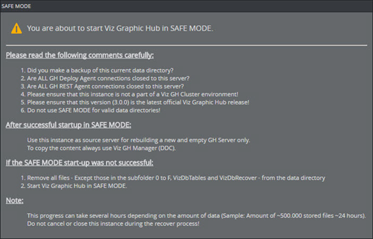

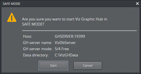

  2. In the Graphic Hub Terminal, go to Backup > Data recovery (Safe Mode):
  3. Carefully read the information, then click Start to proceed.
  4. Check the configuration settings, then click Start. This begins the rebuild process. Rebuilding a large database may take several hours to complete.

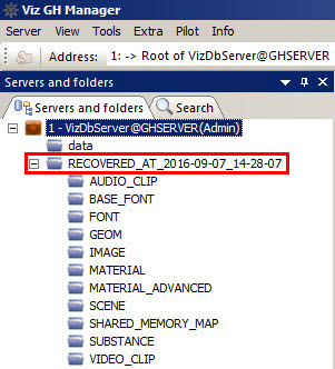

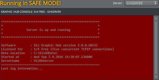

    When the data has been rebuilt, the Graphic Hub Manager contains a folder called RECOVERED_AT_YYYY-MM-DD_HH_MM_SS. The date and time in the folder name serves as a timestamp for the last modification.
Successful Restore Operation
The database has been successfully restored when:
  • The red console panel shows that the server is up and running.
  • All processed files are listed in Reports.
  • Files can be viewed in the Graphic Hub Manager.
