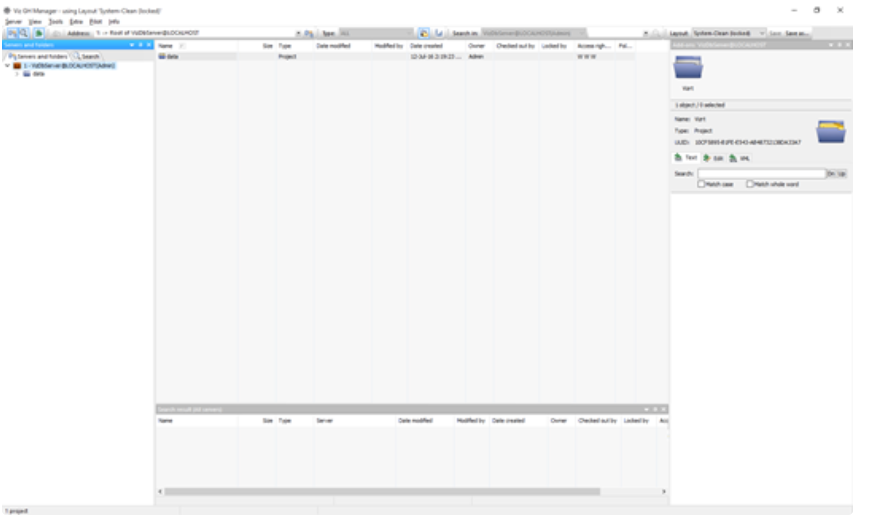

Default Layouts

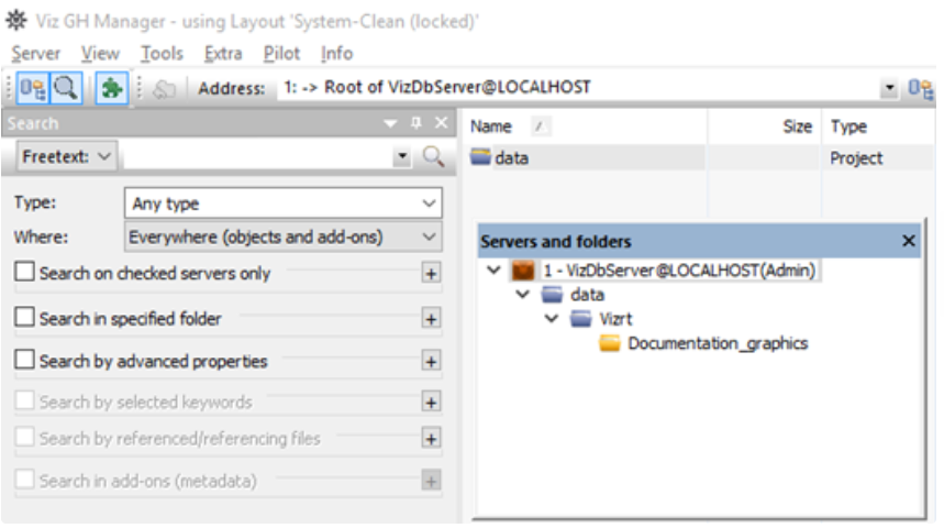

System-Clean (locked)
The System Clean layout is always identical to the presented layout when the Graphic Hub Manager is opened after a fresh install.
System-Default
System-Default is the default layout if a User does not create or save layouts. This layout is, by default, not locked, which means, that if a User opens the archives pane and then close the Graphic Hub Manager then on next startup the archives pane is shown.

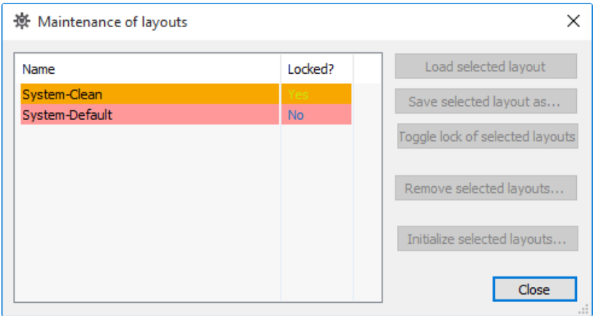

Layout Maintenance

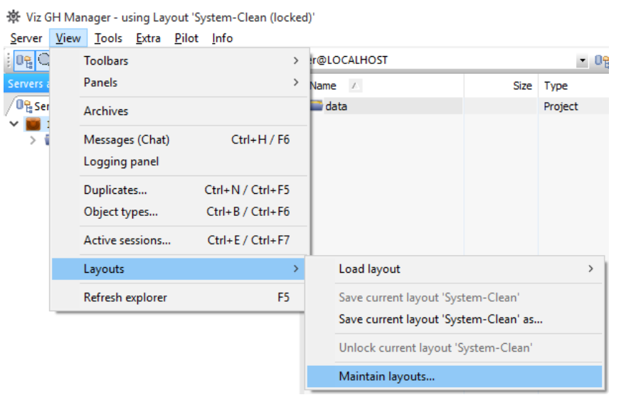

To View the Layout Maintenance Window
Layouts Maintenance Properties
  • Load selected layout: Opens the selected layout.
  • Save selected layout as...: Create a new layout from the selected layout.
  • Lock/Unlock selected layout: See Locked/Not Locked Layouts (not available for System-Clean).
  • Remove selected layout: Delete the layout (not available for System-Clean and System-Default).
  • Initialize selected layout: Set the selected layout to the same layout as System-Clean (not available for System-Clean.

To Save a Layout
  • Click View > Layouts > Save current layout < layout name >, or
  • Click the Save button in the Layout bar

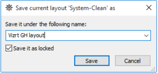

To Save a New Layout
  1. Open the Save as window:
    • Click View > Layouts > Save current layout < layout name > as..., or
    • Click the Save as button in the Layout bar
  2. Type a new layout name.
Tip: Also save a new layout to an existing layout, if required. Existing layouts are listed in the drop down menu.
  1. Tick the Save it as locked box, if required.
  2. Click Save.
To Load a Layout
  • Click View > Layouts > Load layout > <layout name>, or
  • In the Tool Bar, click the Layout button and select a previously saved layout.

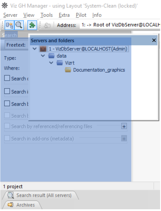

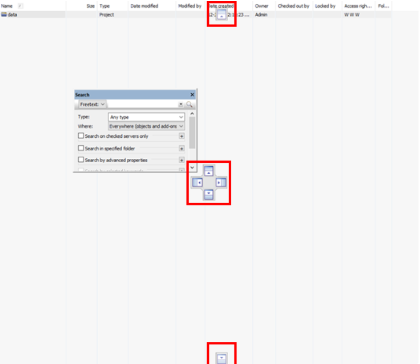

To Drag and Drop Layout Panels
  1. Click and hold the title bar of the element to be moved.
  2. Drag and drop the panel in a new position. Options are:
    • Drag the panel to a symbol which shows possible target positions. When a valid place is reached, that area is highlighted:
    • Drag the panel to the title bar of another panel. When a valid place is reached, that area is highlighted:
    • Drag to white space. When released the panel becomes a floating panel:
Note: When a series of elements are docked together, they show as tabs.

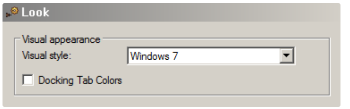

To Load a New Look
  1. Click Tools > Edit Preferences > Look.
  2. Select a visual style from the drop-down.
  3. If colored tabs are required, tick the Docking Tab Colors box.
  4. Click Apply or OK.

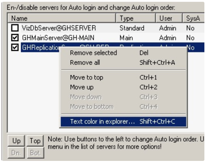

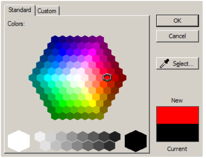

To Change the Color of a Server Text
Change the color of the text for the selected server, in the Server Tree.
Tip: A right-click on a server in the Servers and Folders also opens the Color window - go to step 3.
  1. Click Tools > Edit Preferences > Login.
  2. Right-click a server and select Text color in Explorer...
  3. Select a color (Standard or Custom) from the color picker.
  4. Click OK.
  5. In the Preferences window, click Apply or OK.
Note: All folders and files in the Server show the selected text color in the Graphic Hub GUI.
