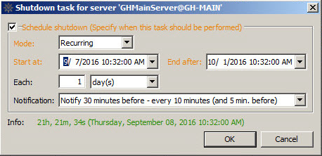

To Schedule a Server Shutdown Using Graphic Hub Terminal
  1. Open Graphic Hub Terminal and go to Options > Scheduled Tasks.
  2. Select the Shutdown task.
  3. Check the Schedule shutdown box.
  4. Select a Mode:
    • Once.
    • Recurring.
    • Recurring forever.
  5. Select a Start at and End after date.
Note: A shutdown task cannot be started in the past.
  1. If Mode is set to Recurring or Recurring forever, set the interval in Each.
  2. Set a Notification time. Options are:
    • Do not notify at all.
    • Just notify five minutes before shutdown.
    • Notify 15 minutes before - every five minutes.
    • Notify 30 minutes before - every 10 minutes (but at least five minutes before).
    • Notify 60 minutes before - every 15 minutes (but at least five minutes before).
The Info line confirms the next scheduled shutdown time.
To Schedule a Server Shutdown Using Graphic Hub Manager
  1. In the Graphic Hub Manager open the Server Shutdown panel:
    • Click Server > Shutdown, or
    • Press CTRL + W or F10.
  2. Click Schedule...
  3. In the Mode drop down box, select one of these options:
    • Once.
    • Recurring.
  4. In the Start at drop down box, click to select a date from the calendar.
  5. If required, adjust the time.
Note: Schedule tasks can not begin the past.
  1. If Recurring is selected:
    1. In the End after drop down box, click to select a date from the calendar.
    2. If required set a time.
  2. Select a Notification option. Options are:
  3. Click OK.

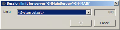

Limit and Shut Down Sessions
Active sessions on the server can be limited by the limitation of the number and/or shut down of individual sessions. If a Graphic Hub is to be shutdown, clients can be notified (message, email, walk-in, etc.) and then not allow them to reconnect (no new connections = nobody is removed, but nobody new can come in).
A limit of one connection can be set, if only a Deploy Agent is used.
A disconnect stops client access immediately.
To Limit the Number of Sessions
  2. Select a server in the Server drop-down box.
  3. Click Modify...
  4. Select one of the following options:
    • System default
    • User defined (and enter a numerical value)
    • No new connections
    • No new connections (except Graphic Hub Deploy)
  5. Click OK.
