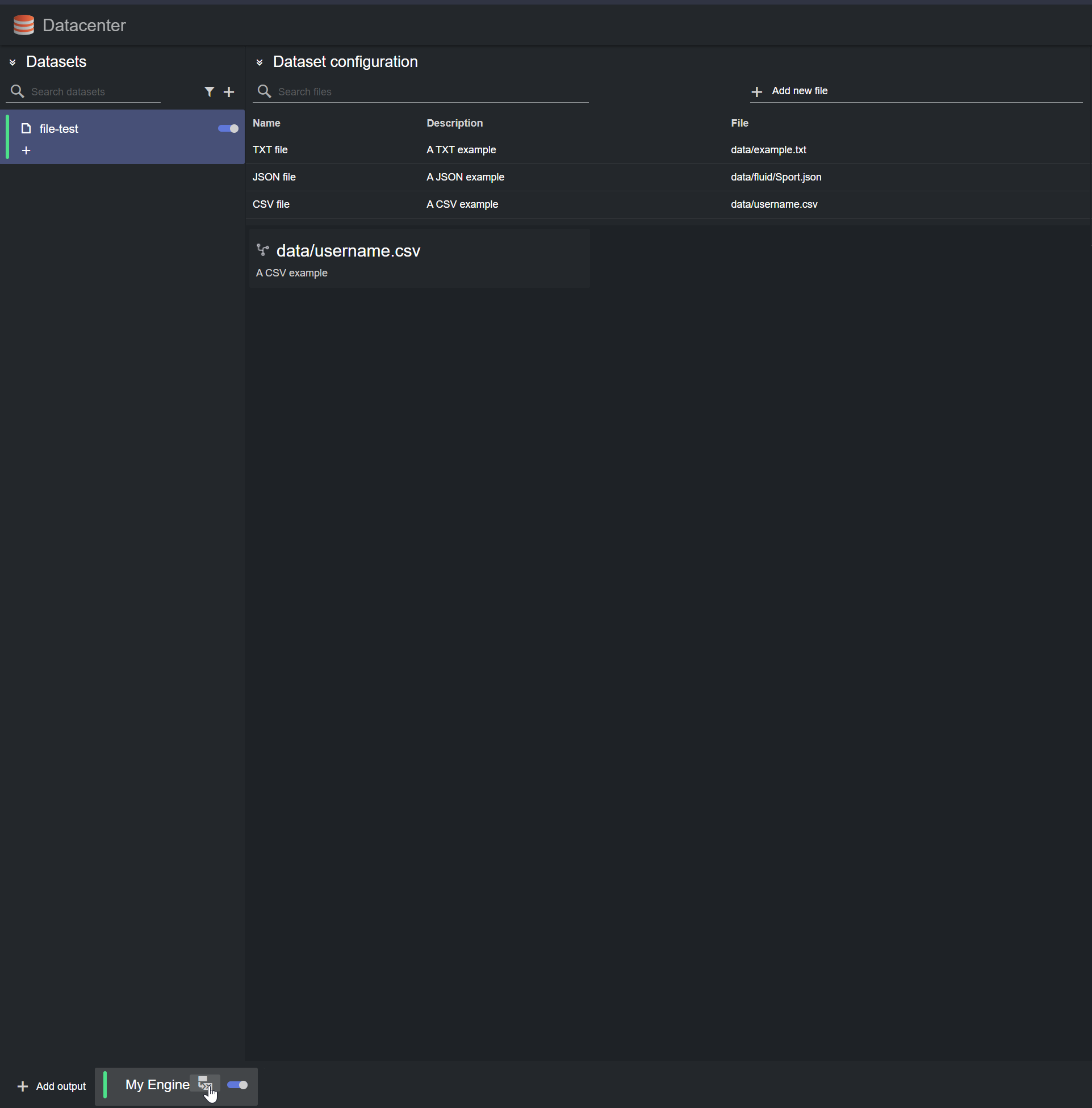

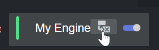

To do so, select a dataset from the Datasets panel and click on the custom mapping icon on the engine output to edit:

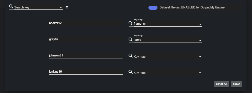

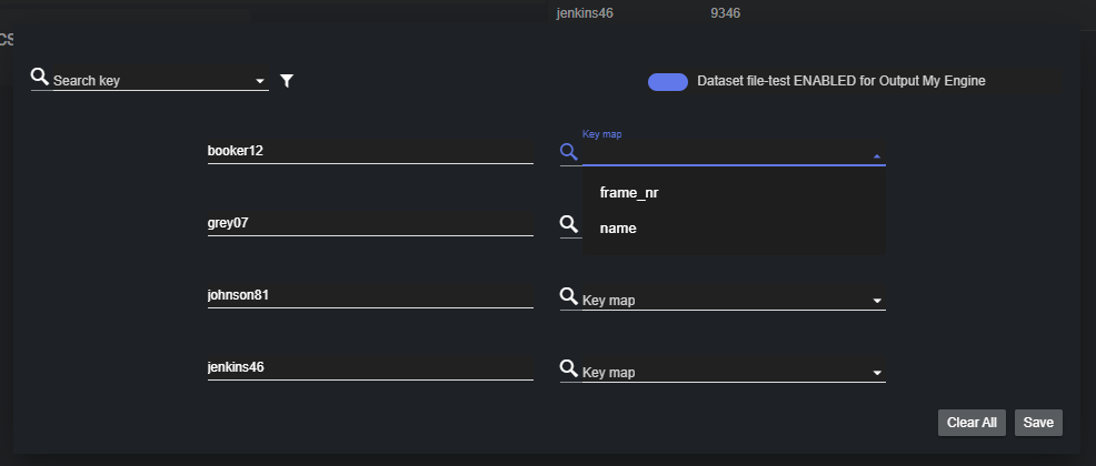

All current keys are listed in the dialog shown. Next to each, there's a search-box to search for all the advertised control channels and control objects on the selected viz Engine output.
In the example above, the input dataset "file-test" has four keys ("booker12", "grey07", "johnson81" and "jenkins46"), while the selected Viz Engine "My Engine" exposes two control channels/objects ("frame_nr" and "name").
You can now choose a custom mapping for any input key, by simply selecting a value from the right-side search-box:
For example, the picture above shows the current custom mapping:
booker12 → frame_nr
grey07 → name
johnson81 → johnson81
jenkins46 → jenkins46
By clicking Save, the current mapping is applied. Clear All resets the mapping to its default value (input keys not remapped).

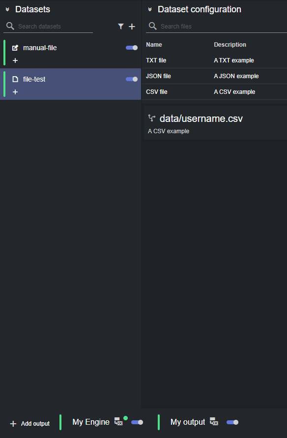

When a custom mapping is applied to a dataset, selecting that dataset reveals a green dot next to the output name:
For example, the picture below shows the case where the Dataset "file-test" has a custom mapping specified for the output "My Engine" but not for the output "My output".
