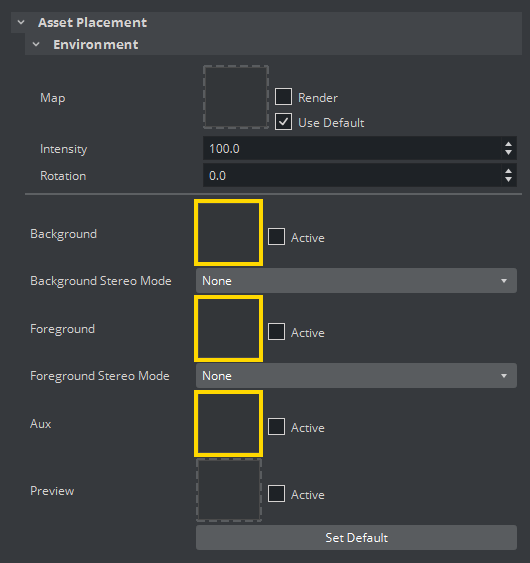

  • or drag a Media Asset to the Background, Foreground or Aux drop zone in Scene > Asset Placement.
If a Media Asset is dragged to the Background or Foreground drop zones, it is applied in the Scene as a full screen texture.

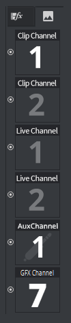

Media Assets as DVE
Important: Hardware surfaces in Viz Engine (such as a Live Video Media Asset or Clip Channel Media Asset) are rendered with the video hardware. Software based DVEs (such as Image Channels and GFX Channels) are rendered with the Graphics card and then composited on the video hardware as one surface. The software renderer ensures the correct ordering within this surface, but as there is only one final surface, multiple hardware-based surfaces and software-based surfaces cannot be blended interchangeably.
If your DVE surfaces do not show up correctly, check the console output for a line like:
[13:51:47.182] [E]: Error: (Clip9) No DVE supported in fast texture mode and/or DSX LE boards.
As DVEs are composed on video hardware, the graphics can be placed either in the front or in the back of the DVE layer. The main layer in Viz Artist defines this behavior. If the same scene is set into the background layer, this means the DVE effect is always drawn in the back of graphics.

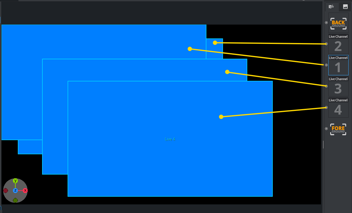

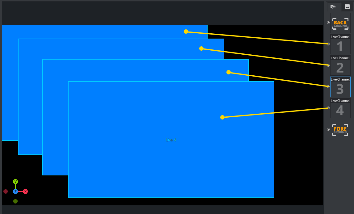

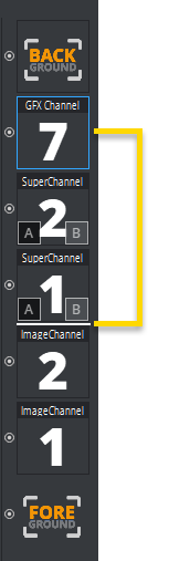

The Media Manager lets you set the rendering priority of Media Assets, by the way they are ordered. To change an asset's priority, drag it to a new position, a white line indicates the final destination. The asset with the highest Order value is rendered on top, with declining Order values below it.
Information: Reordering is available for Media Assets as DVE only.

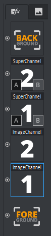

The Background and Foreground Media Assets are, by default, added as DVE layers. The Background Media Asset is always the first Media Asset to be rendered. The Foreground Media Asset can be ordered the same as other Media Assets.
The order of each DVE Media Asset determine the order how each Media Asset is rendered. The first Media Asset in the list is rendered first, the second is rendered next, and so on. See the image below:
Example 1: The Live Input order is 1, 2, 3 and 4. So Live Input 1 is rendered first and Live Input 4 is rendered last.
Example 2: The Live Input order is 2,1,3 and 4. So Live Input 2 is rendered first and Live Input 4 is rendered last.

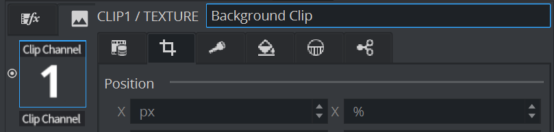

To Name Media Assets
Media Assets can be named.
