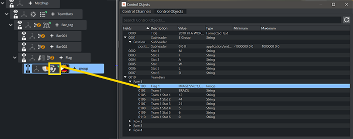

Control Objects are defined by adding certain plug-ins, so called Control Objects to containers. These plug-ins expose certain functionality to Control Applications like Viz Trio or Viz Pilot. Every Control plug-in must have a Control Object plug-in in the upper hierarchy of the scene tree.

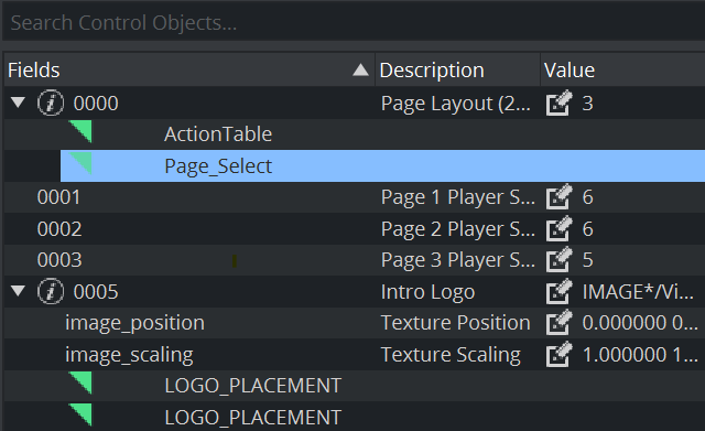

Information: The green triangle indicates that this property has the same field identifier used on more plug-ins. Clicking on the entry automatically jumps to the related container.
  • Fields: A unique field identifier of this property. This is shown in the control applications. The following characters are allowed to guarantee compatibility with other control applications:

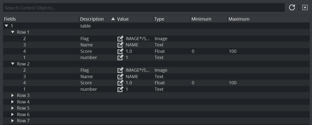

ControlList structures are shown as expandable groups within the editor:
The new Control Object Editor allows to search for any property shown within the editor. This makes it easier to quickly identify and find control objects within your scene.
Use the Search option to quickly lookup Field Identifiers, Names or Types.
