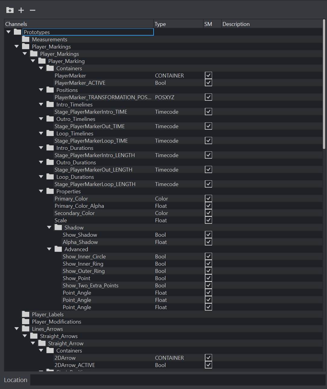

Control Channels can also be grouped. This provides a convenient way to group a series of parameters which can be controlled from an external source.

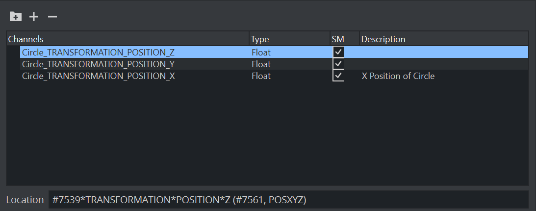

Control Channels Properties
  • image-20240916-142602.png: Click to add a new group
  • image-20240916-142605.png: Opens or collapses the Control Channels tree
  • Channels, Type, SM, Description: Exposed parameter details.
    If required, click in the SM box to synchronize the Channel values with the corresponding key-value pair in the Scene Shared Memory Map.
  • Description: Adds a description for the exposed parameter.
  • Location: Shows command location of the command.

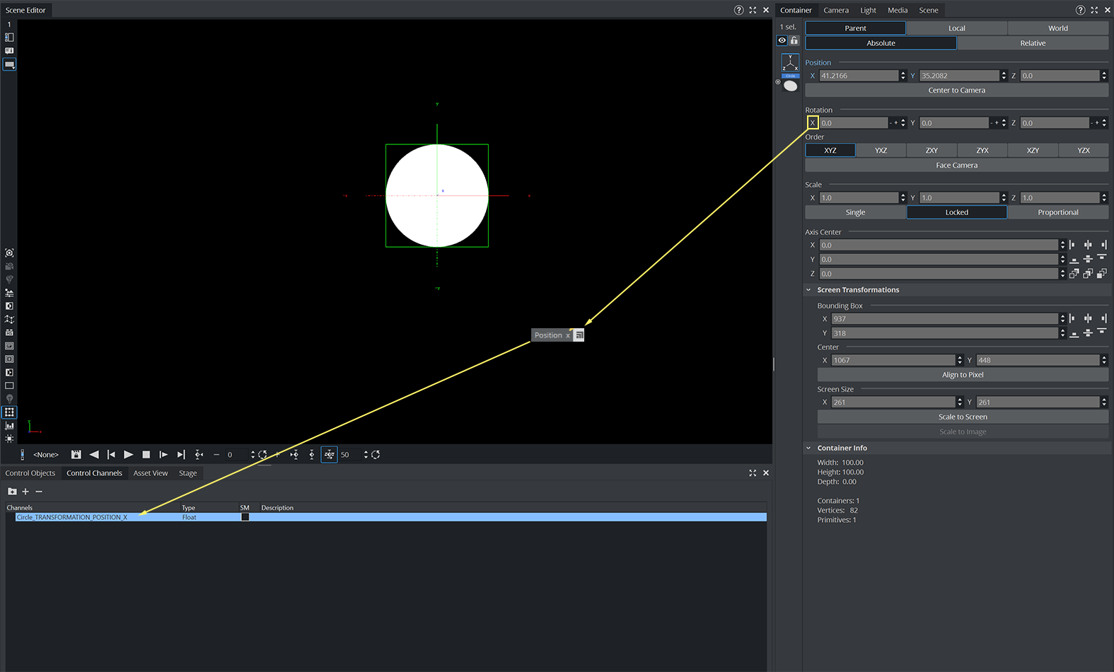

To Create a Control Channel for x Position
  1. Open Control Channel window.
  2. Drag the X position from Transformation Editor to the ControlChannel Window:
  3. Enter a unique name for this channel (for example, Circle_TRANSFORMATION_POSITION_X).
  4. The Control Channel creates a new Channel of type float.
  5. In addition, you can double click in the Description area to give your channel a meaningful name.
Instead of providing the full tree in a command, you can now access this channel with:
MAIN_SCENE*TREE*@Circle_TRANSFORMATION_POSITION_X SET -20.0
