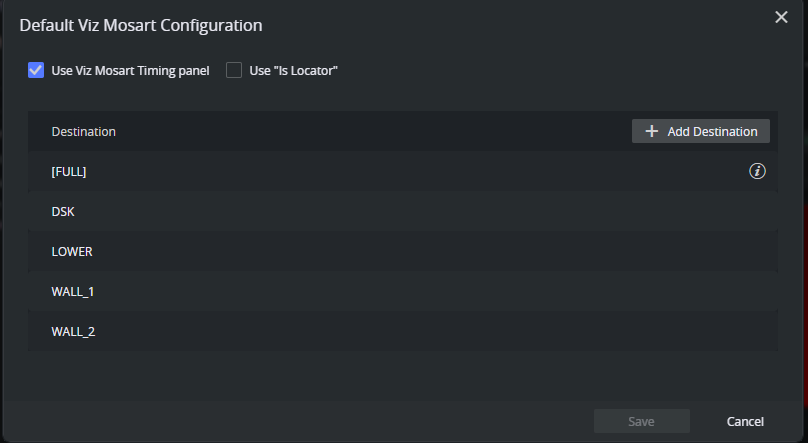

The Viz Pilot backend must be aware of available Viz Mosart destinations. These must be configured manually via Template Builder:
  1. Open Viz Mosart Configuration from the Template Builder tools menu.
  2. Add Viz Mosart destinations to match your Viz Mosart system.
Note: One default destination called [FULL] is represented internally as an empty string (""). This indicates the graphic is a primary full-screen event, not a secondary event, and therefore cannot have timing information in a Viz Mosart system.
  1. Enable the timing panel using:
    • Use Viz Mosart Timing Panel: Displays the panel at the bottom of regular Viz Pilot Edge templates.
    • Use "Is Locator": Includes a checkbox in the timing panel to set the "Locator" flag.
Info: In Viz Mosart, a Locator is a graphic linked to a video switcher crosspoint. Taking the crosspoint (as a switcher or keyed crosspoint) also takes the graphic.
When the configuration is saved, the Viz Mosart Timing Panel becomes visible in all applicable Viz Pilot Edge templates.
Note: The [FULL] entry is mandatory. It results in an empty <channel> field in the MOS XML and disallows timing, as full-screen graphics are treated as primary events.

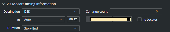

Set Default Timing Values
Prepopulate the timing fields:
vizrt.onCreate = () => {
// Setting initial timing values
if (vizrt.$pilot.mos.mosart) {
vizrt.$pilot.mos.mosart.start = "00:12";
vizrt.$pilot.mos.mosart.inMode = "auto";
vizrt.$pilot.mos.mosart.outMode = "story-end";
vizrt.$pilot.mos.mosart.channel = "DSK";
// Overriding the continue count of the scene
if (vizrt.$pilot.mosartTimingPanel) {
vizrt.$pilot.mosartTimingPanel.showContinueCount = true;
vizrt.$pilot.mos.continueCount = 3;
