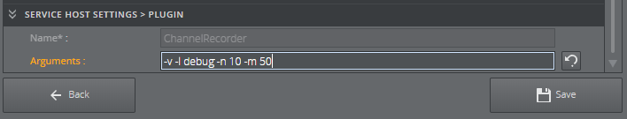

Enabling Debug Logging
To enable debug logging, go to the Service Host web interface and to the configuration page of the instance of Channel Recorder that you wish to enable the debug logging. In the configuration page go to:
Add the following arguments: -v -l debug -n 10 -m 50
Where n specifies the maximum number of log files and m the maximum size of each log file in MB. By default, the number of log files is four and the maximum size of each log file is 10
MB.
