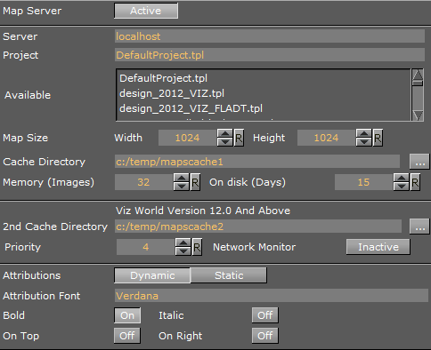

Maps Configuration
Map Server: Enables or disables Viz World Server (WoS) connection for Viz World Client (WoC).
Server: Sets the Viz World Server host.
Note: If a Server Allocator is used, it should point to this location.
Project: Sets the default map project that is opened with the client application.
Available: Lists all available Viz World Server projects.
Map size: Sets the default map size to be used with the client application.
Cache: Enables caching of maps for faster preview and fetching of maps. Especially useful for journalists and operators using Newsroom Component and Viz Trio respectively.
Cache Directory: Sets the cache directory for cached maps which can be a local drive, mapped drive or a Universal Naming Convention (UNC) path.
IMPORTANT! Make sure the Cache Directory folder is configured with read and write access rights.
Memory (Images): Sets the number of images to keep in memory.
On disk (Days): Sets the number of days to save images on disk.
2nd Cache Directory: Enables a second cache (see Cache above). The main purpose of the second cache is to enable redundancy in those cases where a main cache directory is on a different computer and for some reason fails. Another use case is to use it as a local cache to save loading time (for example, if you load all borders for the entire world you would have 100MB+ of cached files). In order to shorten load time you can copy large static files to the correct local cache folder. In the 3D Map Setting plug-in you also finds a Sync Local Cache Folder button which copies all the needed files to your local cache. Note that the second cache directory settings can only be used by Viz World version 12.0 and later.
Priority: Sets the machine’s connection priority to the Viz World Server (WoS). Setting a number, where
1is the lowest and100is the highest you may override connection priorities set by other machines. The configuration interface allows you to prioritize client connections from Viz Artist and On Air Viz Engines used for preview and program output. Viz Engines must be in On Air mode for them to be prioritized. For Viz World’s Map Editor you can set it from the Context Menu. To enable this behavior on the server side you need to enable WoS to prioritize its connections/logins. If the configuration option is not visible, please read how To Add the VizWorld.ini File and set the priority.Network Monitor: Enables you to monitor relevant network connections (server and cache folders). If you do not monitor the network and you try to connect over a “disconnected network”, connecting to a server or a UNC path, it takes time before the system reports back (30 seconds or more). Enabling network monitoring will avoid such connection issues. Note that the network monitor only monitors a cache folder that use a UNC path (not mounted/mapped drives). If the configuration option is not visible, please read how To Add the VizWorld.ini File.
Languages: Sets the current language to be used on labels fetched from Viz World Server. For more information, see the Display section.
Attributions: Adds an attribution to the map. Alternatives are; Static and Dynamic.
Dynamic: Displays the attribution when a licensed imagery is in view and disappears when the image is out of view.
Static: Displays the attribution as long as there is a licensed imagery in the scene.
Attribution Font: Sets the font for the attribution.
Bold: Sets the attribution font to bold.
Italic: Sets the attribution font to italic.
On Top: Places the attribution image to the top in the screen. Default is bottom.
On Right: Places the attribution image to the right in the screen. Default is left.
