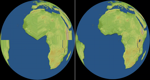

Distorted Projection
Using the wrong projection within Viz Artist (for example, with the Map Tiler plug-in to build a 3D globe) produces a distorted projection.

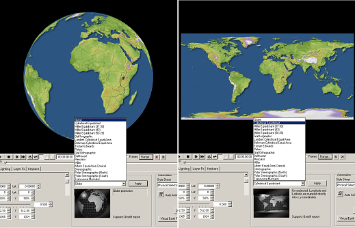

To Set the Map Projection
Select the Properties tab.
From the Projection drop-list select the Cylindrical Equidistant projection.
Select The World from the View drop-list (lower-right corner) to check that the map is a flat and not a globe view of the World.
Click Apply.
Note: This test also works well via the World Map Editor in Viz Artist.
