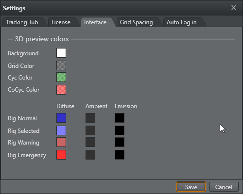

Interface Configuration
To adjust the colors to a users need, open the Settings window in Tools. In this window, the user can adjust the render colors for the visible objects in the preview panel. Click in a drop-down list to open the color selection window. The RGB and Alpha values can be adjusted for all colors by clicking the Advanced button.
For the Background, Grid, Cyc and CoCyc colors, only diffuse color can be selected. These objects are rendered without lighting.
  • Rig Normal: Shows colors used when the Rig is not selected. The user can define Diffuse, Ambient and Shininess colors.
  • Rig Selected: Shows colors used when the Rig is selected in the Rig Editor.
  • Rig Warning: Shows when a connected Parameter service reports a problem which is handled by the system (interpolation of missing packages).
  • Rig Emergency: Shows when a Parameter service reports a problem which cannot be handled by the system, and immediate action from the operator is needed.

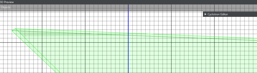

  • Top: Activates an orthographic camera which looks in Y-Direction
    • Right Mouse: Moves the camera in X and Z.
    • Mouse Wheel: Zooms in and out.
    • Middle Mouse: Moves the camera in X and Z.

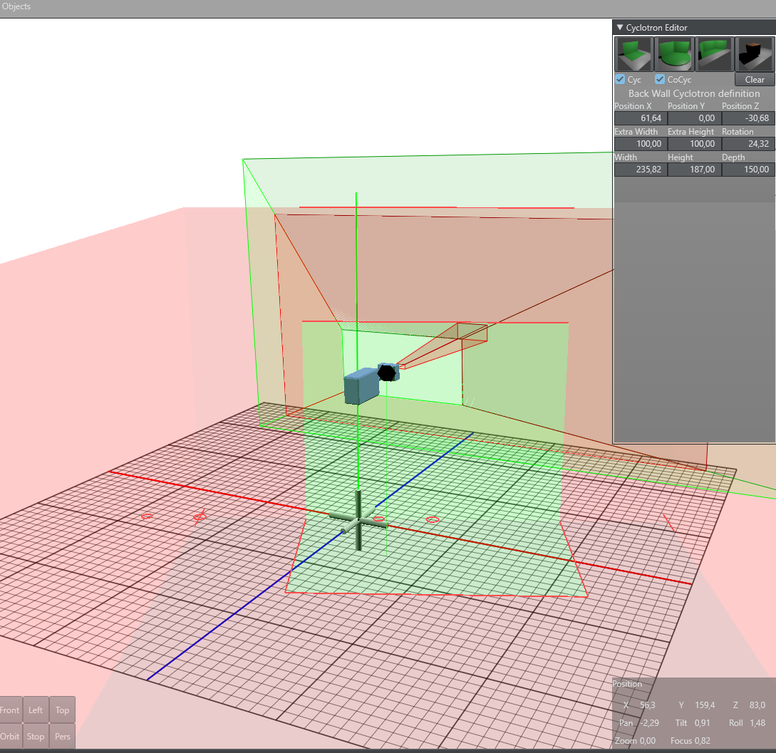

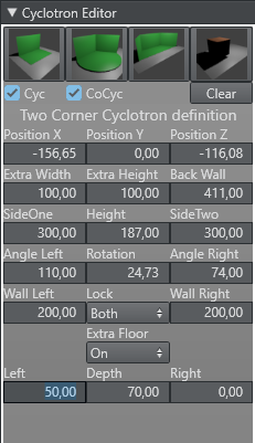

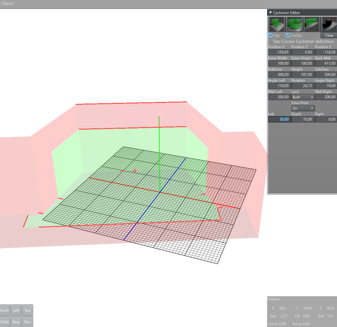

Cyclotron Editor
The CYC Editor enables creation of Cyc and CoCyc masks which are needed to mask out regions of the Studio not covered by the green/blue screen. The CoCyc mask is a geometry which is created in the CYC Editor and stored on the Tracking Hub. From there the CoCyc is sent to all connected Engines. Every change in the editor and its sub elements is immediately communicated to the Engines and to the Tracking Hub.
A new Cyclotron Editor (Cyc Editor) was introduced in version 1.2. Many customers were used to the old VizIO Cyc editor and were satisfied with the functionality. This feature is back in Studio Manager, and at the moment, the two Cyc definition methods coexist together.
Note: The cyc data is sent to Viz Engine only when at least one camera service exists. In case of NDI, at least one camera service must exist for every Viz Engine.
Workflows

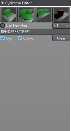

A new Cyc workflow was introduced in Viz Engine version 4.0. The Cyc resides now in a special scene property, which resides in the Virtual Studio scene. Please refer to the Viz Engine Administrator Guide for further information. As the transportation of the Cyc information sent to the Engines is different now, there is a new dropdown in the Cyc Editor to select the used Viz Engine version.
Please remember, that the Engine needs to be On Air to make the sent commands work.

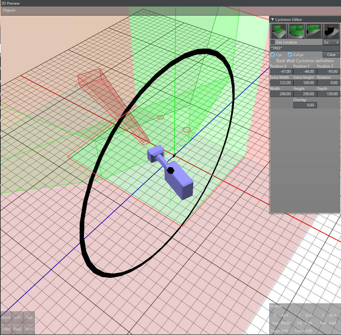

The new Cyc Editor is located in the top-right corner of the preview panel. It can be expanded by clicking the arrow on the left side.
There are three Cyclotron types are available: Back-Wall, One-Corner and Two-Corner Cyc.
Common Cyc-Editor Elements
 For every Cyc model, six common parameters can be defined. The position, rotation (Y-Axis), Extra Height and Extra Width. Extra height defines the distance from the top of the Cyc wall to the ceiling of the room. Extra width defines room size around the green wall and floor area.
Back-Wall
The back-wall Cyc has three additional parameters: These are the width of the green wall, height of the green wall and the depth of the ground area.

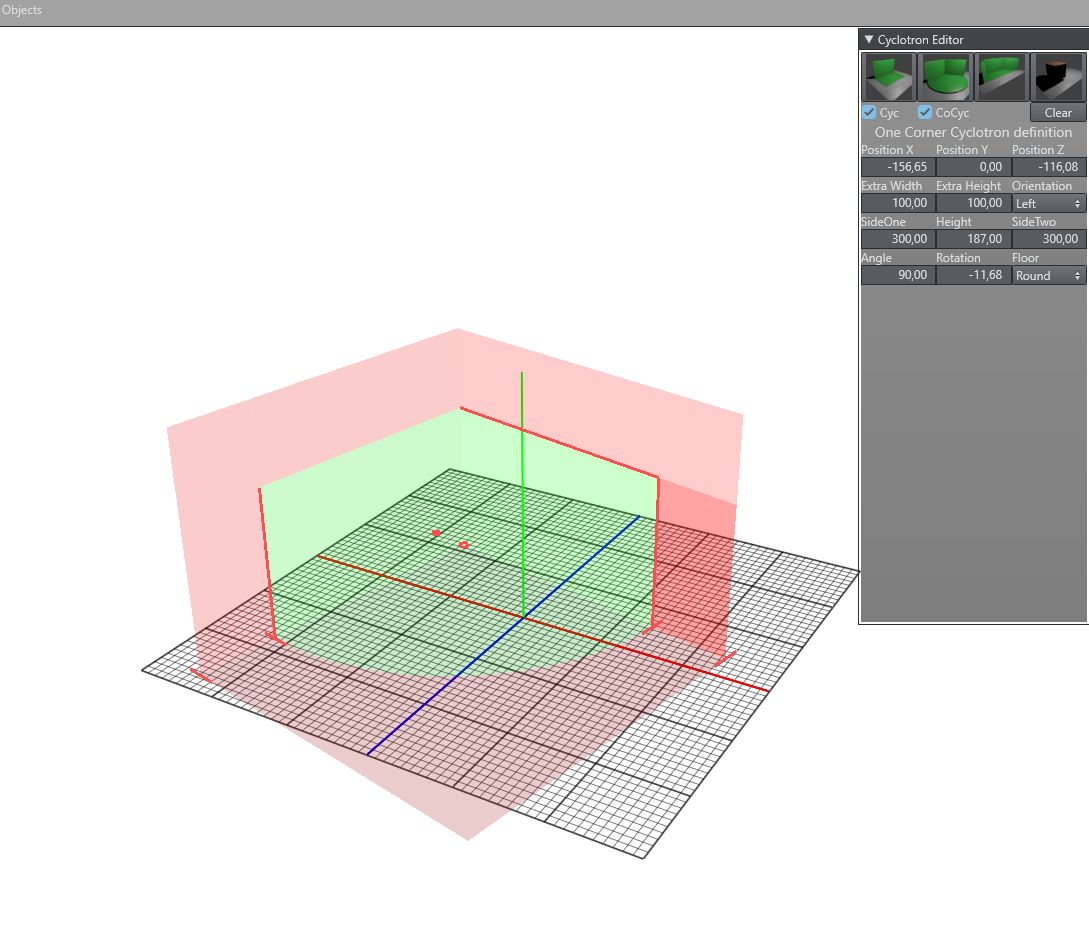

One Corner
The One Corner Cyc is defined by two sides (side one and side two) and an opening angle. Additionally, the shape of the ground plane can be selected. The user can choose Round, Straight and Rectangular form.
Two Corner
The Two Corner Cyc is defined by the length of SideOne and SideTwo, two opening angles (AngleLeft and AngleRight). It is possible to define the green area of the sides shorter than the side itself. This can be done with the parameters Wall Left and Wall Right. It is also possible to define an extra floor area. This extra floor is added in front of the green walls and extends the shape of the floor.

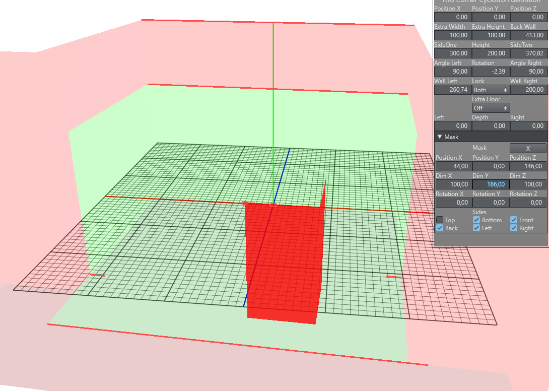

Masks
For any CYC model, any amount of Masks can be added. Masks are elements which will be added to the CoCyc walls. For any mask element the position, scale and rotation can be defined in the Cyc Editor. It is also possible to select for every sides of the cube if it should be rendered or not. In the tracking hub, the amount of masks is not limited.
Cyc
Defines what parts of the Cyc the preview panel renders. The selectable elements are Wall and Floor. All these settings are stored for local use in the user settings folder.
CoCyc
Defines what parts of the CoCyc the preview panel renders.

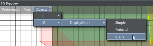

Objects Menu
Every rig present in Tracking Hub has its own display menu with it. These options are handled in the Object menu item. In the first release, Tracking Hub offered only one Rig: Simple Camera. In future releases, more rigs will be added to allow creating Cranes and other geometries.
  • l1 / l2 / l3: Selects which Rig to use.
Selectable Display Modes
Mode
Description
Example
Simple
The tracked point is displayed as selectable circle in the view.
A rendered camera shows the offset settings.

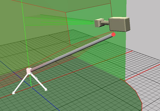

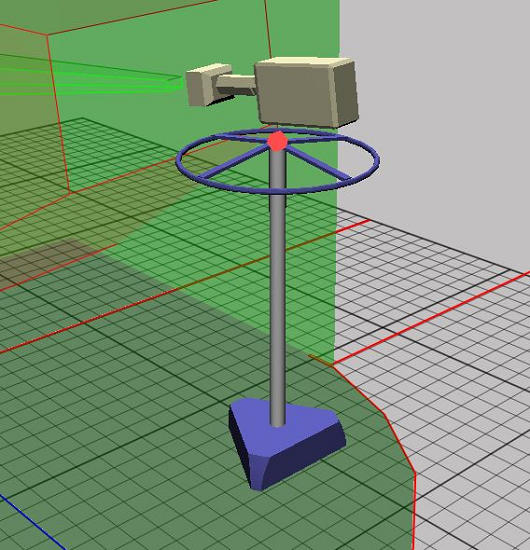

Pedestal
The rig is displayed as a tracked pedestal.
The tracking point is always on top of the pan/tilt head.
The rendered camera shows the offsets added to the rig.
Crane
The rig is displayed as small jib.
The origin of the base is the X/Z offset of the rig.
The tracked point is a result of offset and height.
Object
Object is a tracked object which is not a camera. For example, Motion Analysis objects.
No camera is rendered and only the tracked point is displayed.

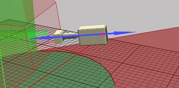

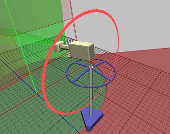

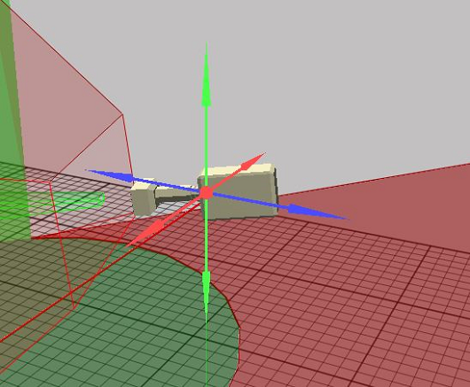

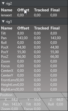

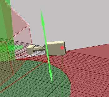

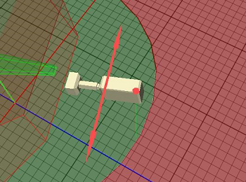

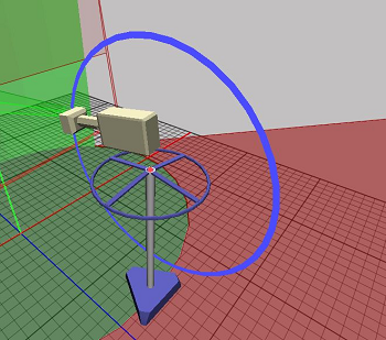

Camera Handles
Whenever the user clicks in the rig editor to adjust a specific value, the preview panel displays the values as a handle that can be dragged. Handles can be arrows (position) or disks (rotation). Whenever the user touches a Handle with the mouse, the handle goes from its base color to yellow. This indicates that only this handle is active at the moment. Clicking with the left mouse button and moving the mouse in handle or in the opposite direction modifies the handle's value.
The following list shows all available handles and the corresponding rig values.
Rig Value
Description
Example
Position Offset
Every axis is color coded and only visible if modifiable.
  • Green: Y Axis
  • Red: X Axis
  • Blue: Z Axis

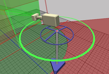

Pan Offset
Green: Modifies the pan offset of the camera.
Tilt Offset
Blue: Modifies the tilt offset of the camera.
Roll Offset
Red: Modifies the roll of the rig.
Front Lens Shift
Blue: Shows the distance from the CCD to the rotation axis of the tracking system.
Height Lens Shift
Green: Displays the distance from the CCD to the tilt axis of the tracking system.
Right Lens Shift
Red: Displays the distance from the CCD to the rotation axis in X direction.
