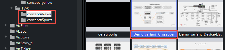

Context Enabled Shows
A context-enabled show has the possibility to switch concepts and variants within a show. For example, a News concept could be switched to a Sports concept. Within that concept there could be variants of a specific scene (such as lower and top third).
Graphics for all these variations must be made, but once they are available and imported into Viz Trio, they can be switched and played out at the touch of a button.
Within a specific concept, all variants of a scene are shown as a single template in Viz Trio’s Template List.
For a show to successfully use context-enabled scenes in Viz Trio, the folders and scene names in Viz must follow a certain naming convention, giving them properties and values for Viz Trio to recognize and use.
Concept Naming Conventions
Type
Property
Name
Example
Concept (folder)
concept
<conceptname>
concept=<conceptname>
concept=News
concept=Sport
concept=Weather
Context (folder)User-defined
<context>
<contextname>
<context>=<contextname>
aspect=16x9
aspect=4x3
platform=HD
platform=SD
Variant (file)
<scene>_variant
<variantname>
<scene>_variant=<variantname>
banner_variant=Lower
banner_variant=Top
chart_variant=Graph
chart_variant=Line
adds_variant=Adds
adds_variant=NoAdds
weather_variant=3DayForecast
weather_variant=1DayForecast
Note: It is essential to add an underscore "_" to separate the scene name from the variant’s keyword in the names of variants!
