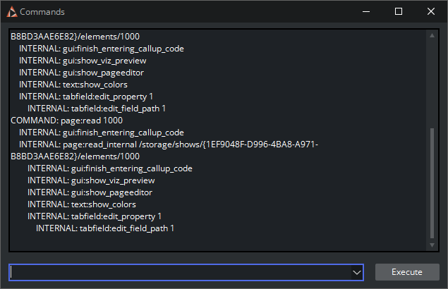

The Viz Trio user interface basically uses the same macro commands as the scripting support uses. To help find the commands that are executed when different user interface operations are performed, use the commands window and look at which commands are sent.
The actual commands can be seen after the colon:
page:read 1000Note: The Viz Trio Client Commands window can be very helpful when learning the system and testing out macro commands. Enter commands in the text field at the bottom and click Execute to run them.

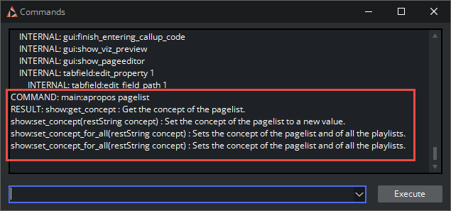

Apropos and Help Commands
The Viz Trio Client Commands window contains useful features for searching for information about a command.
Use keywords apropos and help to perform look-ups in the available set of commands:
apropos: Searches command names and descriptions for a string.
help: Shows help for the specified command, or lists commands.
Example I: Apropos
The apropos command does a free text search for the given text in the macro command documentation.
COMMAND: main:apropos context_variable RESULT: show:get_context_variable(string variable) : Get the show-context-variable. show:set_context_variable(string variable, restString value) : Set the show-variant to a new value.Example II: Help
