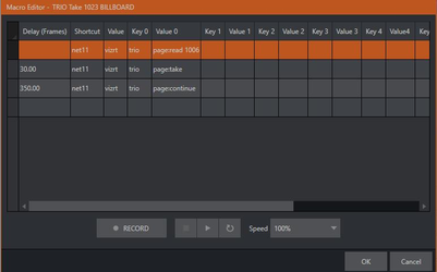

For details on how to handle macros, please check Working with Macro Commands.The net shortcut entry in Viz Vectar Plus macros can be used to send commands over a specific NDI input. The workflow is:
A Viz Engine (either Program or Viz Trio Preview) is set up to output NDI.
In Viz Vectar Plus, the NDI output from the Viz Engine is assigned as one of the inputs.
The Macro system in Viz Vectar Plus can be used to send commands via the NDI streams of the inputs.
As an example, if the NDI output from the Viz Engine is on input number #11 in Viz Vectar Plus, the shortcut entry net11 can be used to address this NDI stream.
Value: vizrt
Key: trio
The value of the key is the command to send to Viz Trio.

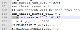

If another Viz Engine (for example, on Program) is receiving the macro commands from Viz Vectar Plus and these commands are sent to a Viz Trio client on another host, the configuration on this Viz Engine must specify the host address of the Viz Trio client:
The relevant config settings in the *cfg config file for the Viz Engine are:
trio_address = 127.0.0.1
trio_tcp_port = 6200
