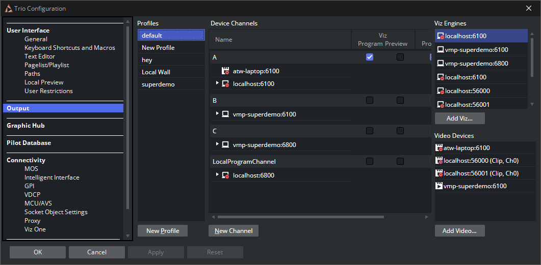

Profile Configuration
Open Profile Configuration
Click the Config button (upper left), and then select Output.
Right-click the profile on the status bar (lower-left) and select Profile Configuration... from the menu.
Add a New Profile
In the Profile Configuration window, click New profile, enter a new unique profile name in the text field and press Enter.
Rename a Profile
Right-click the profile and select Edit Profile Name or simply double-click the profile and enter a new name.
When finished editing the name, press Enter or click outside the Profiles list.
Delete a Profile
Right-click the profile and select Delete Profile, or simply select it and press the Delete button.
Channel Configuration
Add an Output Channel to the Channels List
Click New channel or drag and drop a Viz Engine or video device to the Channels list.

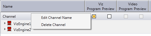

Rename an Output Channel in the Channels List
Right-click the channel and select Edit Channel Name from the menu or double-click the name.
Remove an Output Channel from the Channels List
Right-click the channel entry and select Delete channel from the menu or select the channel and press the Delete button.

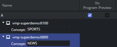

Add a Concept Override for a Channel Output Device
It is possible to override the concept on Viz Engine output level. This concept override takes precedence over concepts set in the show or on the playout elements.
Expand the channels output device and append the concept name. This overrides any concepts set elsewhere.
Click OK.
Warning: Concept names are case sensitive.

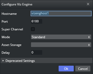

Add a Viz Engine
Click Add Viz... in the Profile Setups window to open the Configure Viz Engine dialog box.
Enter the Hostname.
Default port for Viz Engine is 6100 or 56000 for Super Channels.
Optional: Select Mode.
Select whether the video device is a regular or controlled through a Viz Artist Super Channel plugin.
Set a delay (optional).
Optional: Select an Asset Storage location. Asset Storage lists available Viz Engine clip transfer and playout destinations.
Click OK. A status indicator shows if the renderer is on-air.

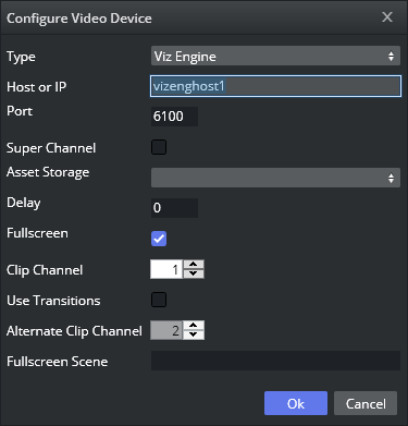

Add a Video Device
Click the Add Video... button in the Profile Setups window to open the Configure Video Device dialog box.
Select the video server Type.
Type the Host or IP address.
Enter the Port number (optional).
Select a publishing point from the Asset Storage list, so that stand-alone clips and clips used in pages or data elements are transferred to the right location (the specified Viz Engine) for playout.
If the Fullscreen check box is selected, you can define additional values (Use Transitions and Fullscreen Scene) in order to provide transition effects from one video to another.
Note: The fullscreen values are only available for Viz Engines, not MVCP video devices.
IMPORTANT! Viz Trio by default sets the Fullscreen Scene in Media Sequencer to Vizrt/System/transitions when you switch on Use Transitions. Using this default, clip channel must be 1 and the alternate clip channel must be 2. Only when using other transition scenes can these settings be changed.
Select the Clip Channel to use.
Note: Viz Engine from 3.6 support up to 16 clip channels which can be used for playout. A clip channel might be unavailable for various reasons: for example, if it's configured to be inactive in Viz Config or if the license only covers a limited number of clip channels.
Alternate Clip Channel: When using videoclip transitions the clip from Clip Channel transitions to the clip from Alternate Clip Channel and the next clip transitions from Alternate Clip Channel back to the Clip Channel. The transition clip channel is only enabled in the configuration window if Use Transitions is enabled.
Click OK. A status indicator shows if the video device is online.

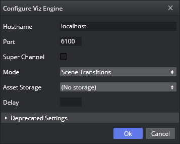

Enable Scene Transitions
Configure the Viz Engine settings as seen in how add a Viz Engine.
Set the Mode to Scene Transitions.
Scene Transitions: Allows the renderer to copy (or snapshot) the scenes to create a transition effect between them.
Open the Show Properties, and set the Transition Path. See also Transition Effects.
Click OK.
Add the program renderer to the program channel.
Note: The program channel must be configured and on-air in order for the effects to be visible.

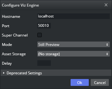

Enable Still Preview
Create two channels, one for program and one for preview.
Configure the same render engine twice as seen in how add a Viz Engine.
For the second render engine set the Mode to Still Preview.
Still Preview: Allows you to use the program output to get a still preview. To achieve this the Media Sequencer creates a copy of the scene being read and sends commands to your program output renderer asking for a snapshot of the scene while the current scene on air is being rendered. Note that the port used for still preview is 50010.
Click Ok.
Add the program renderer to the program channel and the still preview renderer to the preview channel.
Warning: This setup requires sufficient ring buffer on the program renderer in order to prevent the rendered still preview from causing the scene on air to drop frames. This setting is therefore deprecated.
