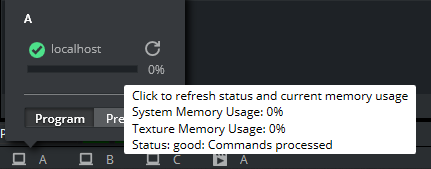

Channel: Displays the channel status for all channels configured for the currently selected profile.

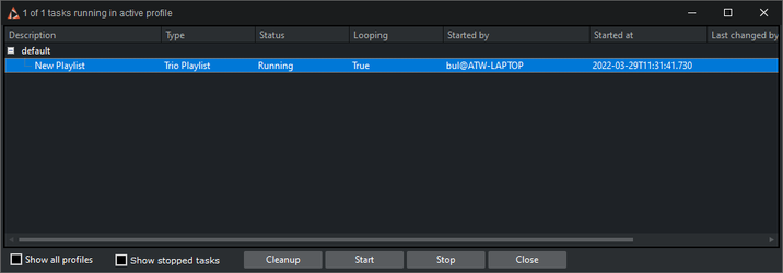

Active Tasks
Double-click the Active Tasks icon in the status bar to open the Active Tasks window.
The Active Tasks window displays show-specific playlists that are running in active profiles, showing active tasks running in other profiles as well as different show playlists within a single profile.
The Active Tasks window contains the following options:
Show all profiles: Shows all profiles with Show Playlists.
Show stopped tasks: Shows all stopped tasks.
Cleanup: Removes all information about stopped tasks.
Start: Starts the selected Show Playlist.
Stop: Stops the selected Show Playlist.
Close: Closes the Active Tasks window.

Checking Memory Usage
Right-click a channel and hover your cursor over one of the bars to see the total usage.
