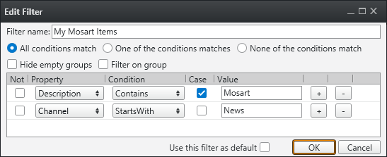

Playlist Filter and Filter Editor

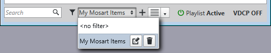

Use the Filter option to filter what items the playlist will show. You can create as many filters as required with the New option, and existing filters can be edited or deleted. When you have created a filter, simply select the filter to use in the drop-down list. Any items that do not satisfy the filter selected will be hidden from display, and not deleted. Deselect filtering to show all items.
In the example below a filter is created that only shows items in the playlist where the description contains the word Mosart:
Use the drop-down entries and check-boxes to create a filter as required, based on the template attributes.
Note: To filter by the category assigned to the template, you must select Subcategory in the drop-down menu. This selection will list all categories created using the Template Wizard client to help filter data elements assigned to a given category. See also Categories and Channels.

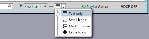

Thumbnail View
Change the thumbnail size.
