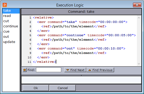

Example - Play, Continue, Take Out
This example shows how execution logic can be used to play an element, do a Continue after five (5) seconds, and then a Take Out after ten (10) seconds.
In the Execution Logic Editor, select the take command. Add the logic into the editor (right pane). This means that when a “take” is issued on a data element based on this template, the Media Sequencer will execute the logic.
The commands are modified to do a "take", "continue" and then an "out". The timecode for each operation must be set.
<relative>
<env command=
"take"
timecode=
"00:00:00:00"
<ref>/logic/element/run</ref>
</env>
<env command=
"continue"
timecode=
"00:00:05:00"
</env>
<env command=
"out"
timecode=
"00:00:10:00"
</env>
</relative>
Note: The running/outer context takes precedence over attributes on the “ref”. Instead of adding attributes on the “ref” node, use an “env” node as in the example above.
