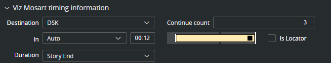

The Viz Mosart Timing Panel is now integrated directly into Viz Pilot Edge, eliminating the need to embed the timing UI within individual templates.
Each Viz Pilot Edge data element can have individual timing. The lifetime and ownership of the timing data are now assigned to the newsroom system, enabling one data element to be reused with varying in/out points in different rundowns.

Destination
The playout destination as configured in Viz Mosart. Different types of overlay graphics can have separate handlers (destinations) in the Overlay Graphics application in Viz Mosart.
In
Take-in of lower third elements may be performed either manually or automatically by Viz Mosart.
  • Automatic: If an in-time is set, Viz Mosart automatically takes it in at the specified point in time.
  • Manual: Viz Mosart marks it as a manual graphics. These elements must be taken in by the operator.
Duration
Take-out of lower thirds can be performed in four ways. Each method is displayed differently in the Viz Mosart GUI:
  • Auto: Taken in and taken out automatically based on the in-time and duration, or out-time set in the timing panel.
  • Background: Taken in automatically as defined in the In field, and taken out together with the primary element to which it is attached.
  • Story End: Taken in automatically as defined in the In field, and taken out when the story is attached to is taken off air.
  • Open End: Taken in automatically as defined in the In field, and is not taken out until the operator takes it out.
