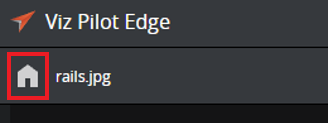

The Home Button
By clicking the home button when editing an item in the tabs for Graphics, Images and Videos, Viz Pilot Edge takes you back to the browser of the relevant tab.
