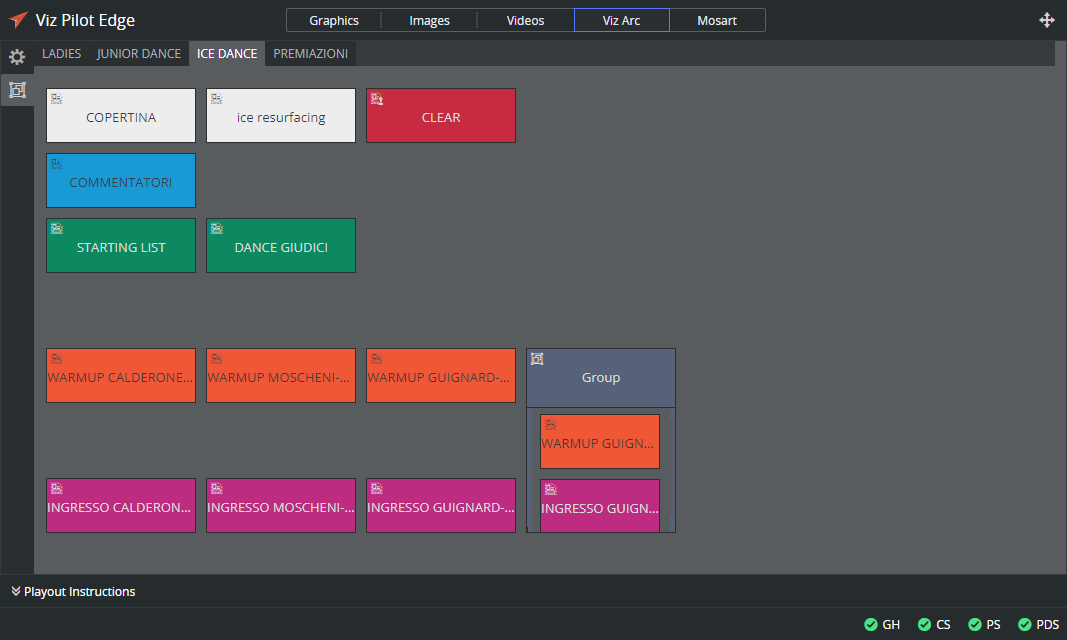

Viz Arc can be integrated with Viz Pilot Edge. In this workflow, Viz Arc actions can be browsed and selected, dragged to the newsroom rundown and played out by a control client like Viz Mosart.

Timing
To add timing to the Arc Actions, use the Playout Instructions.
Check Enable to instruct Viz Pilot Edge to use playout instructions.
Set the In time to the number of minutes and seconds when this Viz Arc action must be executed, relative to the story.
Set Trigger to TIMED.
If the Trigger is set to MANUAL, Viz Mosart does not play this item automatically, but marks it as a Manual item in the UI.
